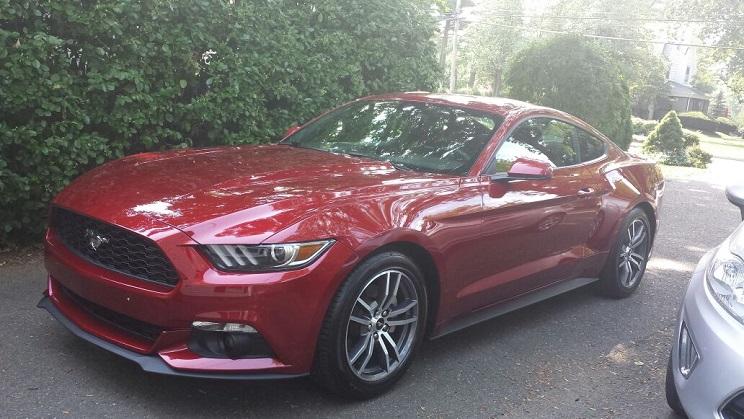

Thought I would post this here as 2 out of three changes fall in this section.
Here is picture new.

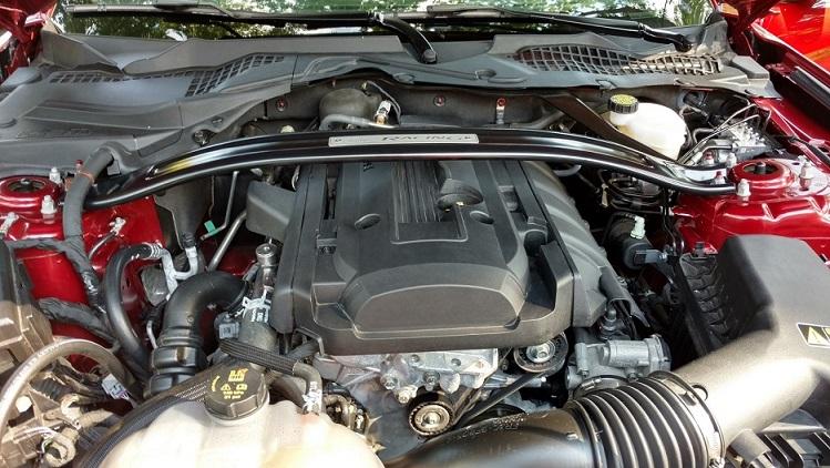

First upgrade strut. American Muscle

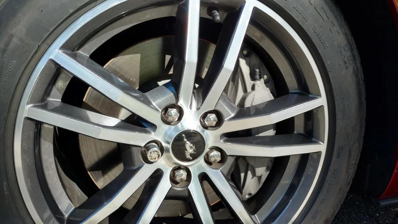

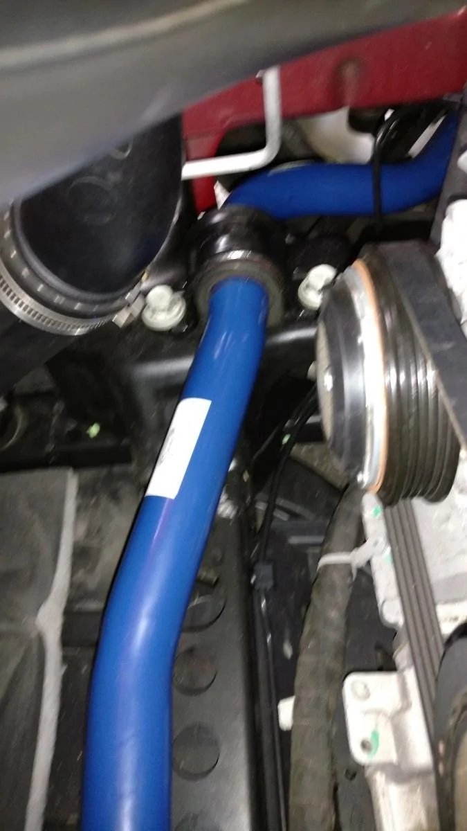

I got a set of EBPP/GT brakes from Shelby.
Conti DW summer tires. Tire Rack

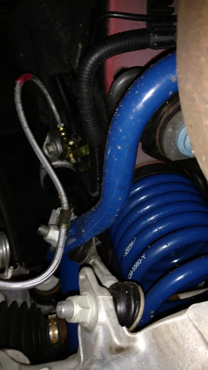

Steeda stainless brake lines. LMR
FR Track Pack Levittown Ford

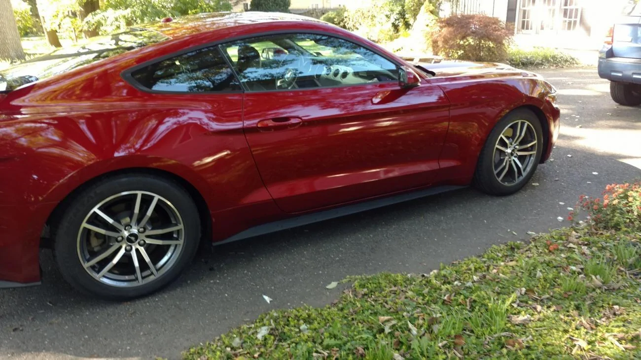

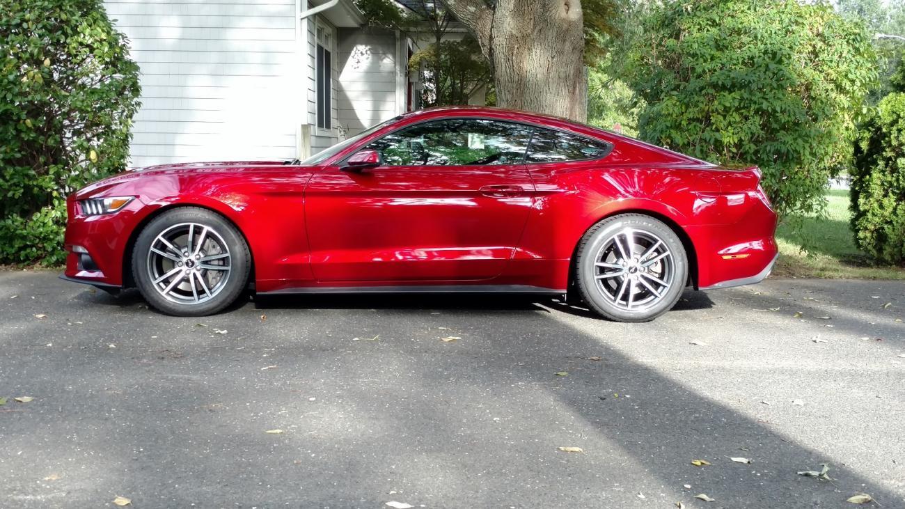

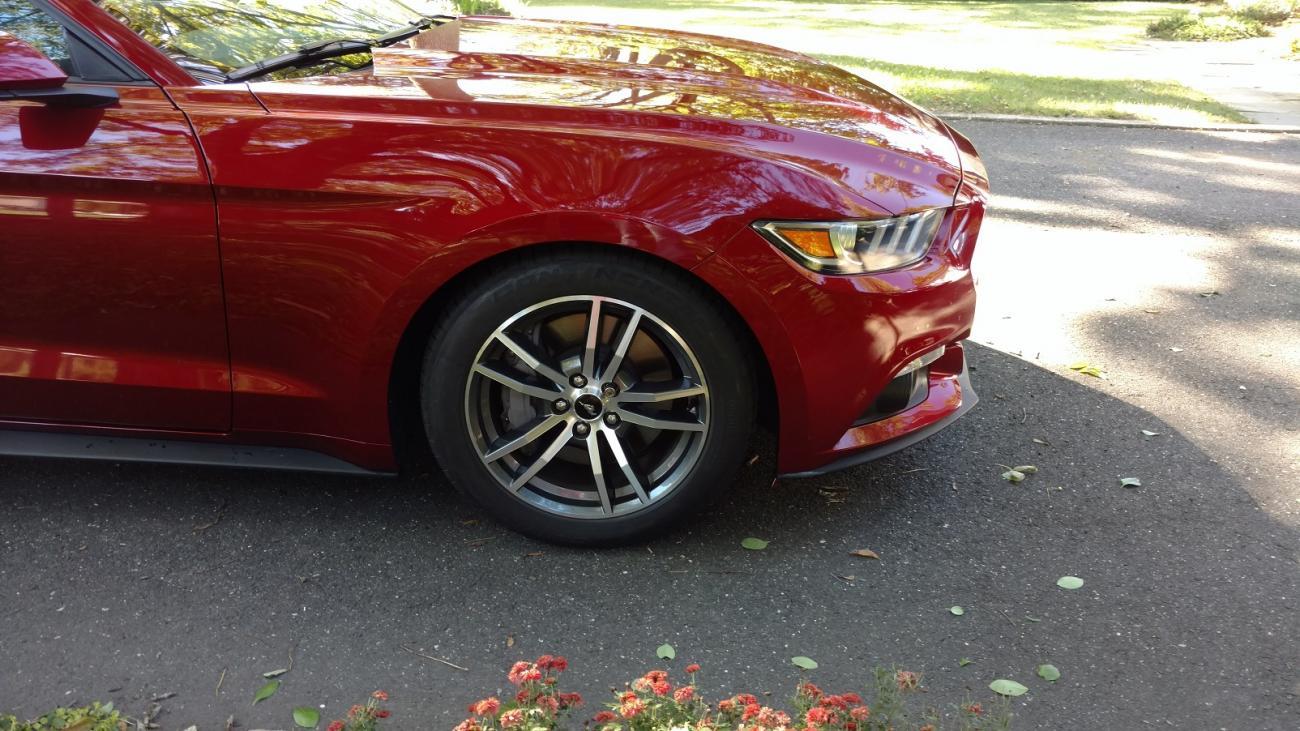

Final results...
My impression so far for the upgrades are extremely positive. It has lost that floating feeling. I think it looks good lowered. Ride is a little harder, but I found that when I reduced the tire pressure from 35 PSI to 32 PSI the ride improved dramatically. Now it almost the same as pre-mod comfort wise and much better handling. MPG I have a measured improvement of about .9 MPG not exactly sure if it is due to lowering the car or some other difference(weather or tires??) Tires are sticky, first thing I noticed was picking up crap on the road. One thing that sucks is going over NJ Transit railroad tracks...some sort of rubber material on the crossing the car doesn't like it at all .... guess is the sway bars or springs not really sure. Other RR tracks not so bad. This weekend is track day so will update after.:ford:

Alright! Had a great time at the track.
Breakdown.
Brakes(no pun intended) The GT/EBPP brakes with Steeda lines and the Motul 600 worked great. Zero give, super firm throughout. Fantastic couldn't be happier with this. Instructor gave thumbs up too.
Tires Much better, though I had to learn how they were different. With the AS Goodyear tires I was almost drifting around turns so input on the throttle didn't do much to my turning radius with the Conti DW I was pushing the car out on the turns as I still had good grip. It took me a while to quit getting an ear full from my instructor. He commented that they were very grippy. Not bad for 235s.
Suspension was much more settled.
So my numbers on the Accelerometer
Before After
Left .91 1.07(this was a pucker moment)
Right .98 1.03
Brake .97 1.09
Acc .7 .7
Think I have them right....they are much better then previous ...not up the GT350 area but pretty good I think for 235 wide tire.
My pucker moment I came in way too hot on turn 5 of Thunderbolt....I didn't turn early but my heel toe sucked and well when the instructor says "well you saved it", it is not a great endorsement of your driving. Good thing is the car stayed planted didn't roll and straightened out. I avoided downshifting late haha after that.
