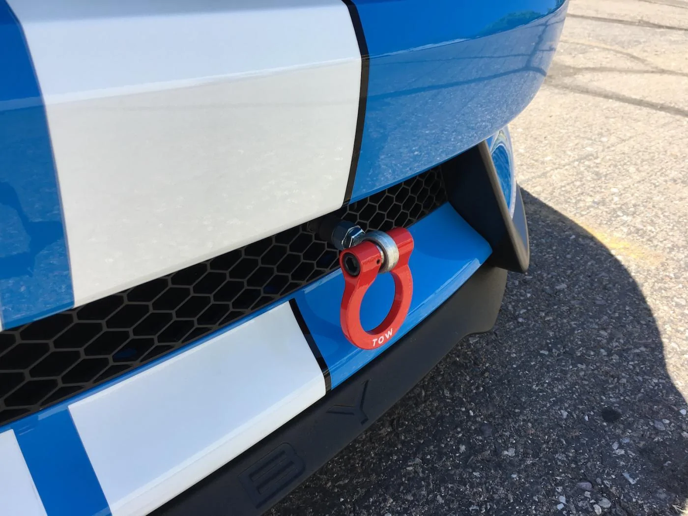

I installed this on mine last week. The setup is pretty beefy. It does use just two nuts to secure to the bumper beam, but it does mount behind it and the nuts are basically at the bumper support so most of the force would go there it seems like to me and would be tensile force on bolts holding the bumper beam on. The steel mounting plate is something like 3/8" thick and a good 10 lbs. I'm not worried about it.

I removed the pan. It's a pain because there's no less than 30 screws for all the parts underneath and yes, that does include the middle splitter piece. That said, it wasn't that bad with the front in the air. It's just time consuming.
As for the hook install, I put it on the other side because I didn't want to bother with the temperature sensor on the passenger side. It doesn't take very long but is annoying to maneuver in there. You have to remove a bunch of "one-time" plastic push pins to get part of the rubber radiator shroud off. I really recommend a trim removal fork for this.
Other than that, pretty straightforward but I did it differently than the included instructions.

The plate has two holes that mounts to either side of the crash supports where an almost swaybar-like support mounts that goes up and over. So yeah, that limits you to either side. This hook is "no modification".
