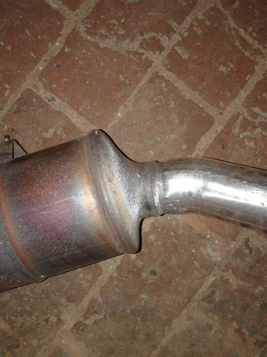

Interestingly enough, the part he found most laughable was the downpipe.
“I know this well, when we had to make a crap turbo not overboost or were forced to run a larger setup because they were already in place we’d mess with the downpipe. It doesn’t cost much to do and we felt ok because any car guy with a welder could make his own plus you can actually get some emissions benefits by using an oversized cat and slowing down the exhaust flow”
“1st no need to neck down the turbine outlet from 3 inches to 2.5, From a manufacturing perspective the cost in negligible, It helps the turbo spin up a bit faster which is nice and helps maintain some post turbine back pressure which will limit boost if you don’t have enough wastegate.”
“With no clearance problems, there is no need for an ‘S’ here, those extra bends take time and material which adds cost. It will slow down the exhaust before the cat which is good for emissions. The top of the cat is good, the smooth transition tries to evenly spread the exhaust gas over the full area.
http://i300.photobucket.com/albums/nn17/gman-r33/General%20stuff/20151207_181157_zpshxhe56n7.jpg[/IMG]
“A big fat Cat slows down the car nicely as well as allowing you to use a cheaper substrate like ceraminc, the end is nearly flat, promoting a high pressure area that keeps gas in the cat longer,
