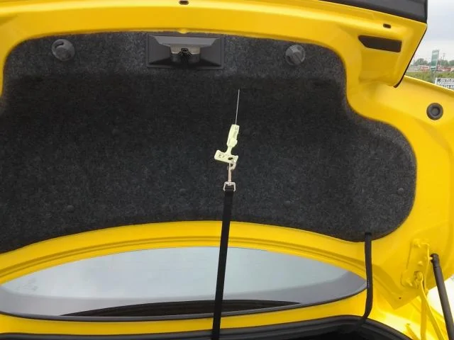

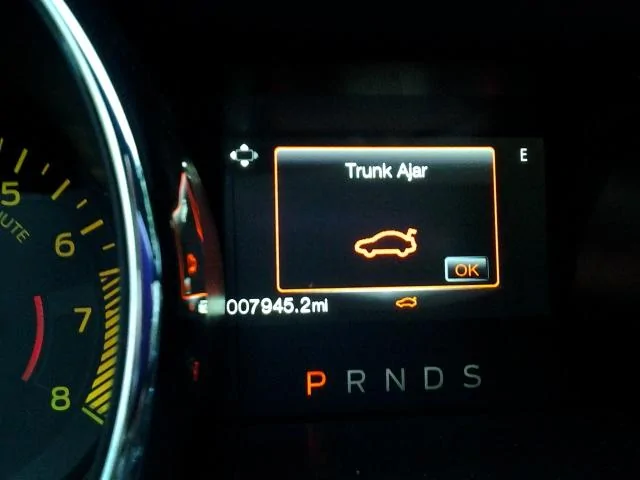

I continually get the "Trunk ajar" message in spite of my trunk being securely closed. Furthermore, the inside and outside electric release buttons do not work. I discovered that the latch can be heard to operate with the rear button whenever the trunk is open, until it is lowered close to the bumper. It is though the cable harness to the latch is intermittent.

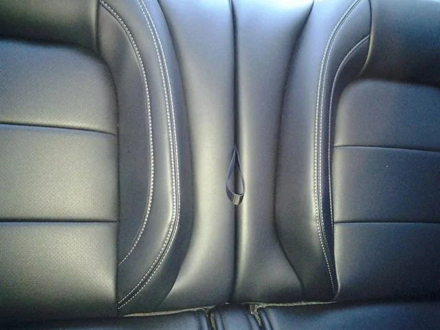

So I bought a dog leash at the dollar store, clipped it on the inside cable release handle, and then ran it between the back seats. At least now I don't have to shimmy through the back seat to open my trunk. :ninja:
Taking it to the dealer in a couple days.
