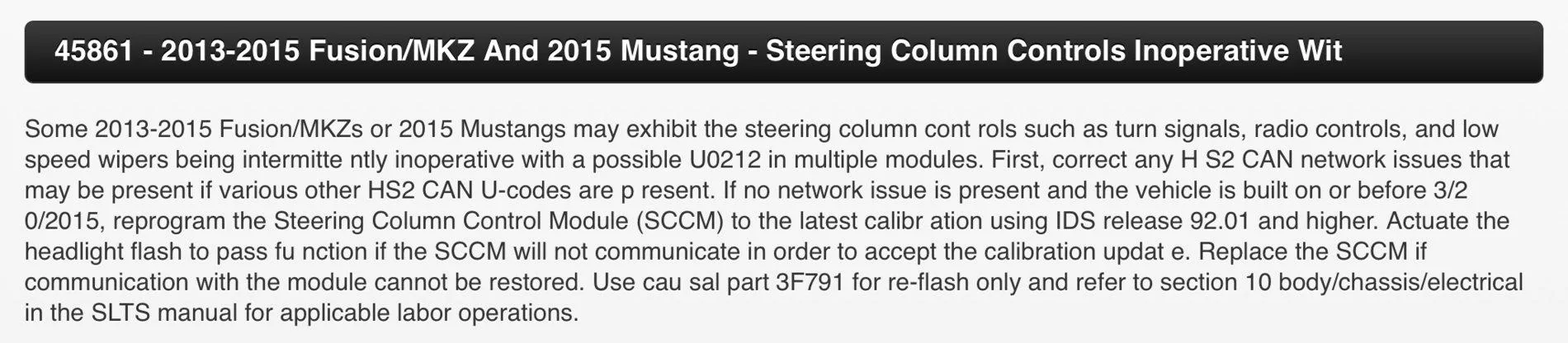

Anyone have any info on fixing this, or what the TSB is about. I looked on TSB site and it doesn't say anything.

There is a TSB for intermittent steering column control failures. TSB #45012
This has been updated with Ford SSM 45861 (and yes, the typos are unedited):
