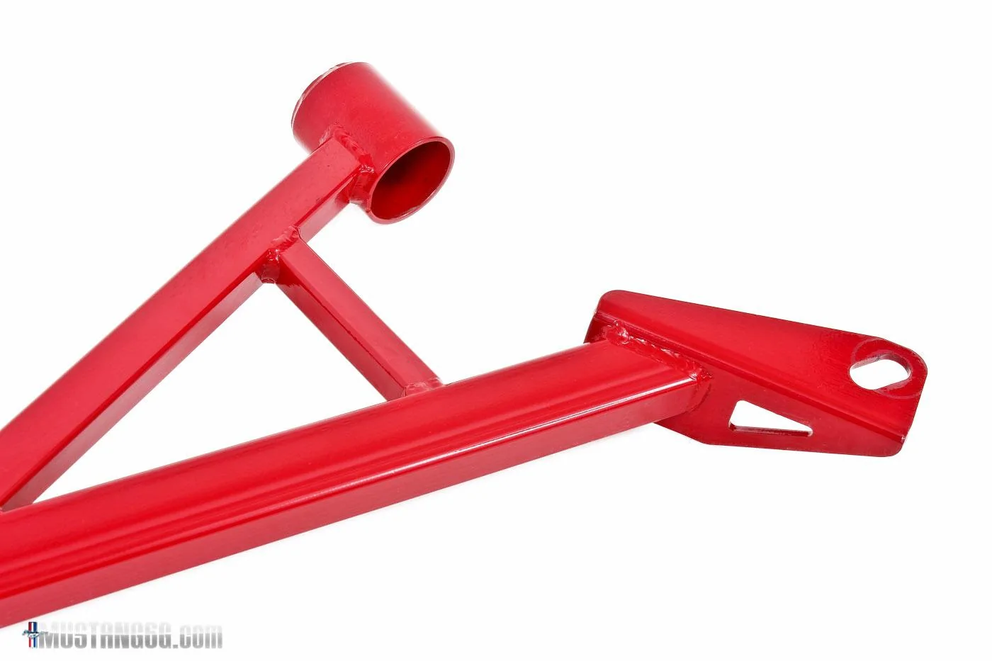

BMR Suspension’s CB006 Front Chassis Brace is designed to reinforce and strengthen the front lower control arm mounts and rear legs of the K-member.
The brace is constructed from a mix of rectangular steel tubing, DOM steel tubing, and formed steel plate. It attaches on the backside of the lower control arm mounts and on the back legs of the K-member using existing holes. The kit also includes CNC-machined billet aluminum spacers to prevent the K-member from collapsing when the bolts are tightened.

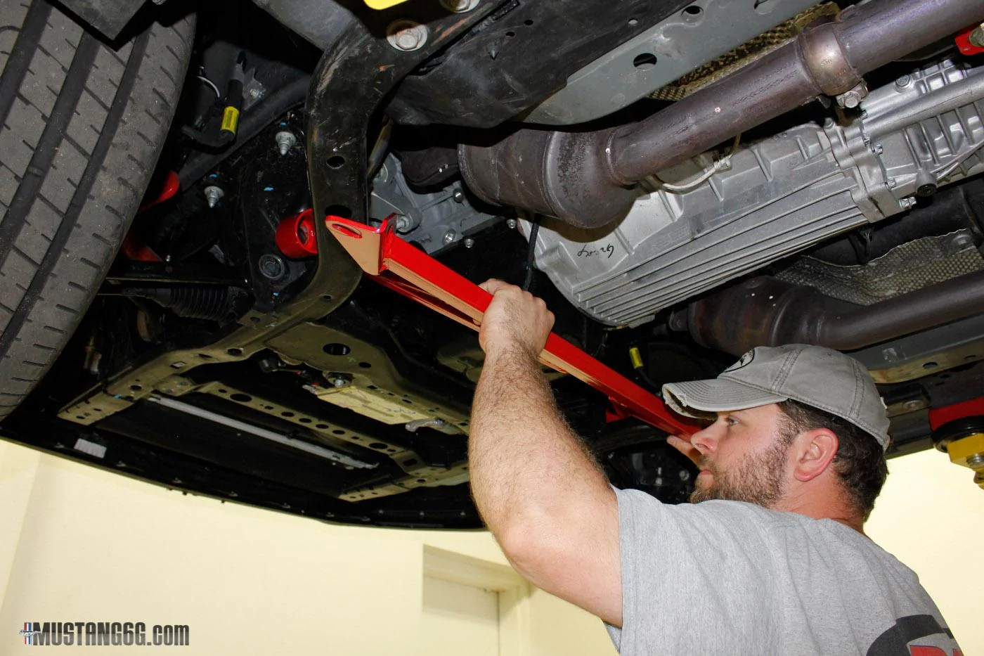

The installation is straightforward and simple. BMR mechanic, Colt Mills had to slow down so we could get out pictures. Realistically this can be installed in about a half hour in your driveway with basic hand tools, a jack, and jackstands.

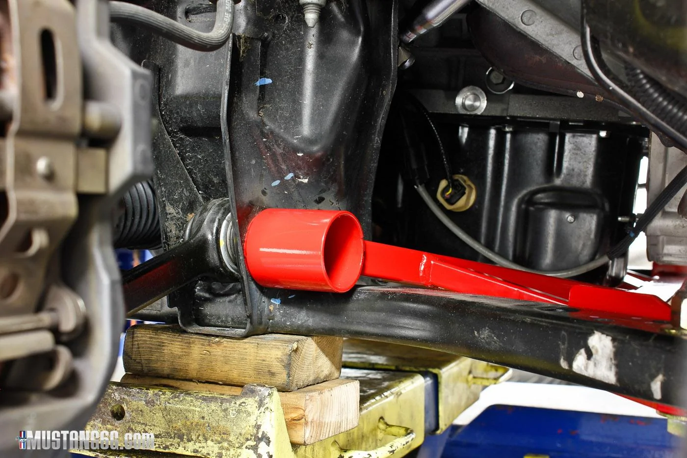

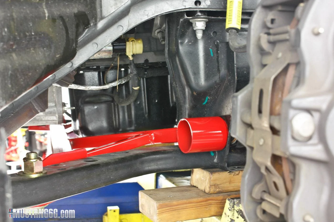

After removing the lower control arm bolts from the K-member, the CB006 Chassis Brace is raised into position.
The control arm bolts are loosely reinstalled to hold the brace in place while the rear of the installation is done.

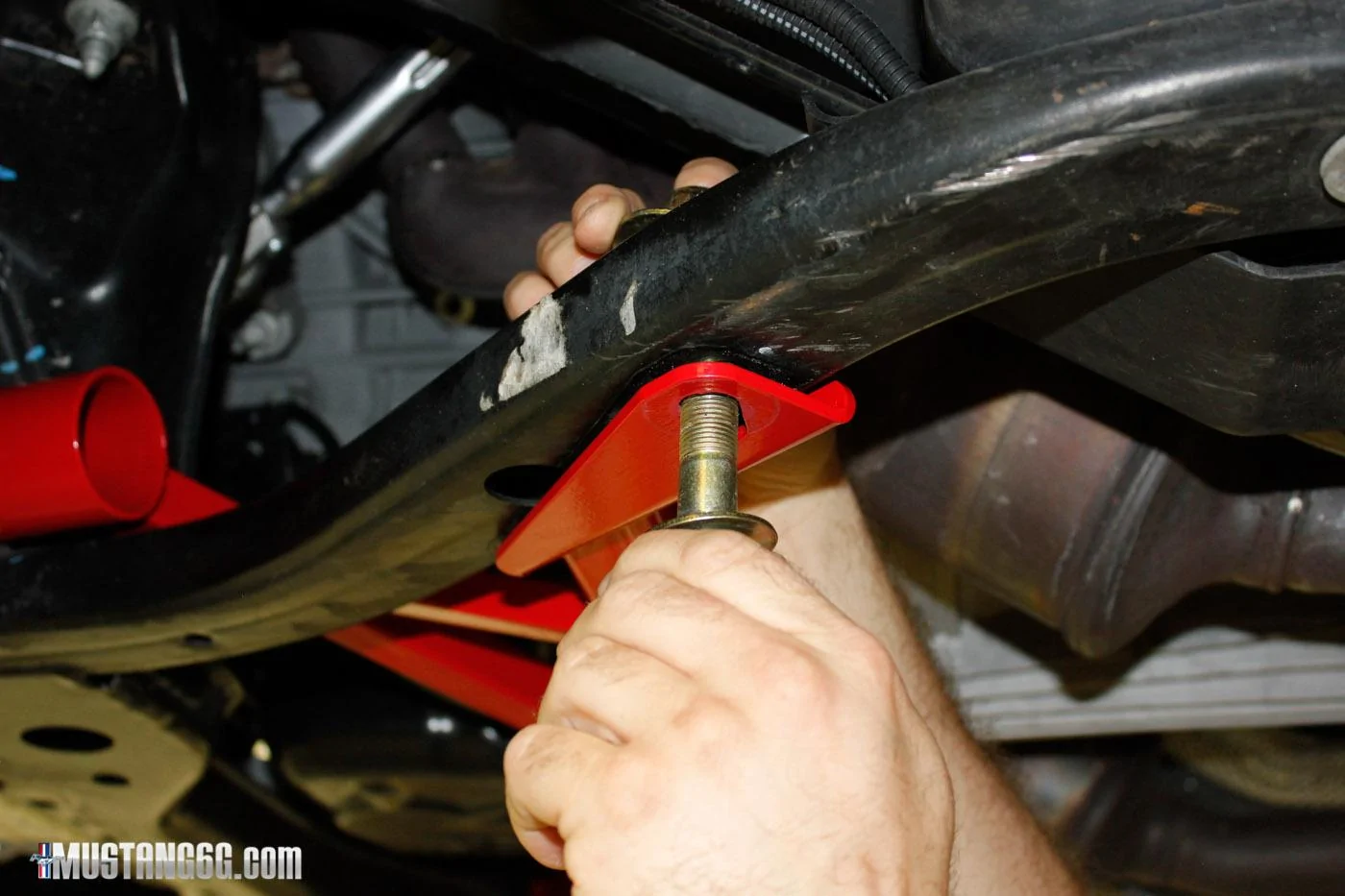

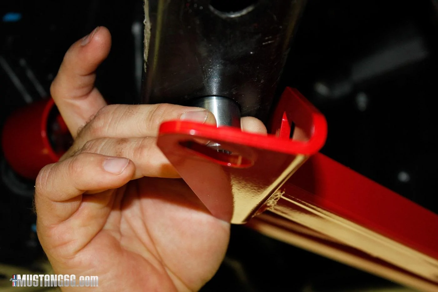

The supplied billet aluminum spacers are then placed in the K-member and slid into position. They are installed in a larger hole just in front of the hole that is actually used.

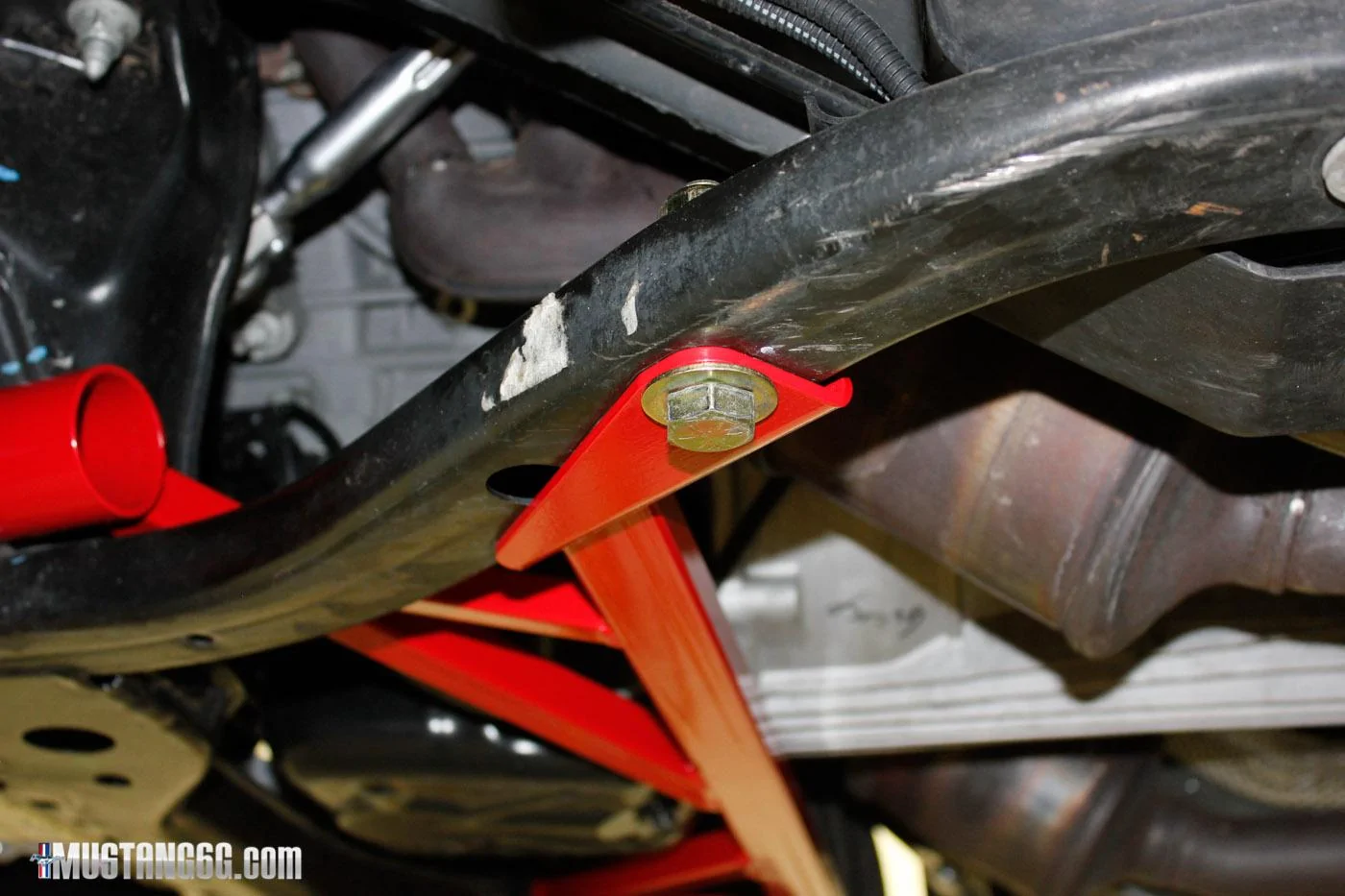

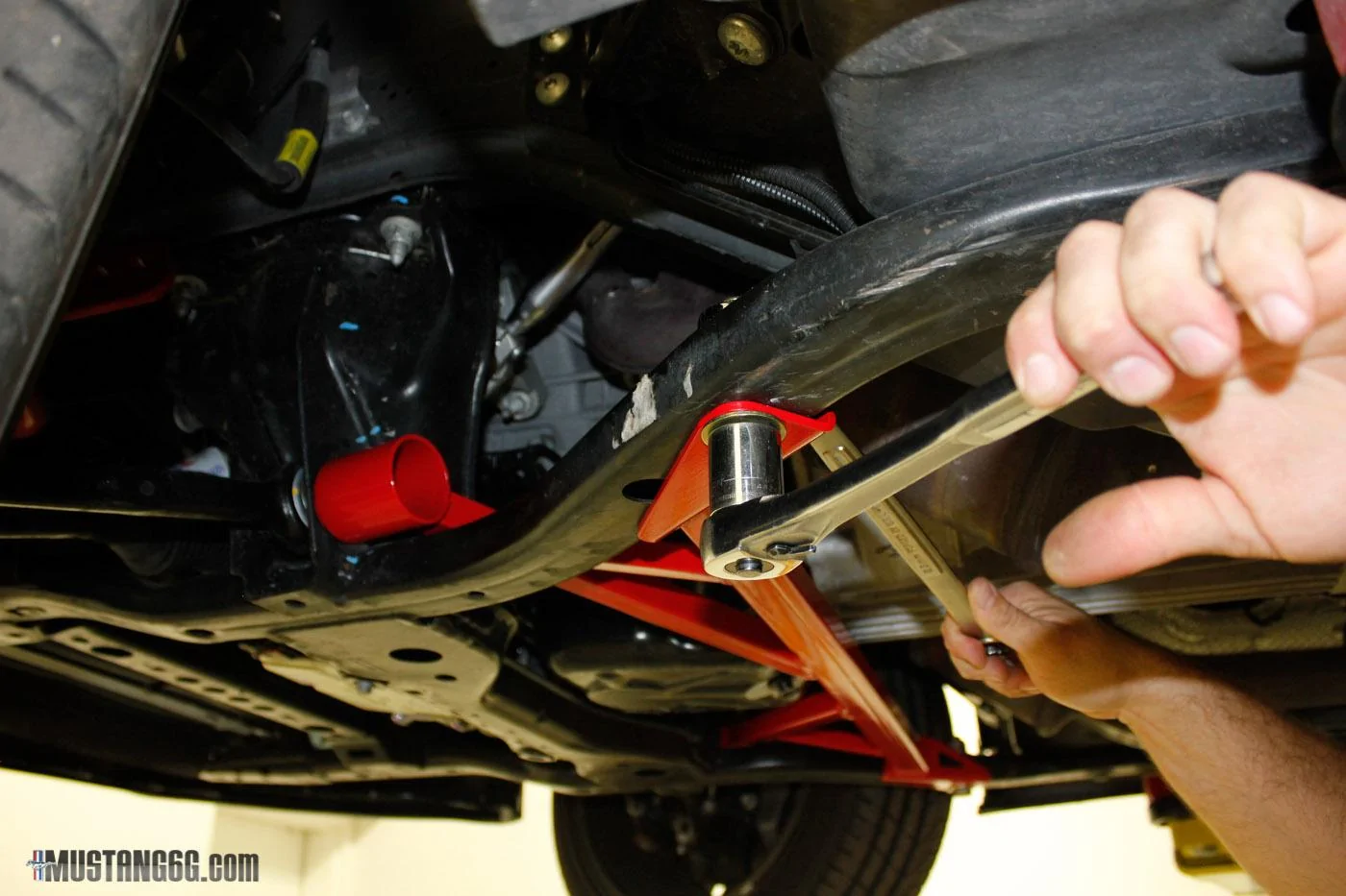

Once they are slide into position, the supplied bolts can be installed. These go through the plate on the rear portion of the brace, a factory hole in the K-member, and through the spacers. At this point, keep these bolts loose.

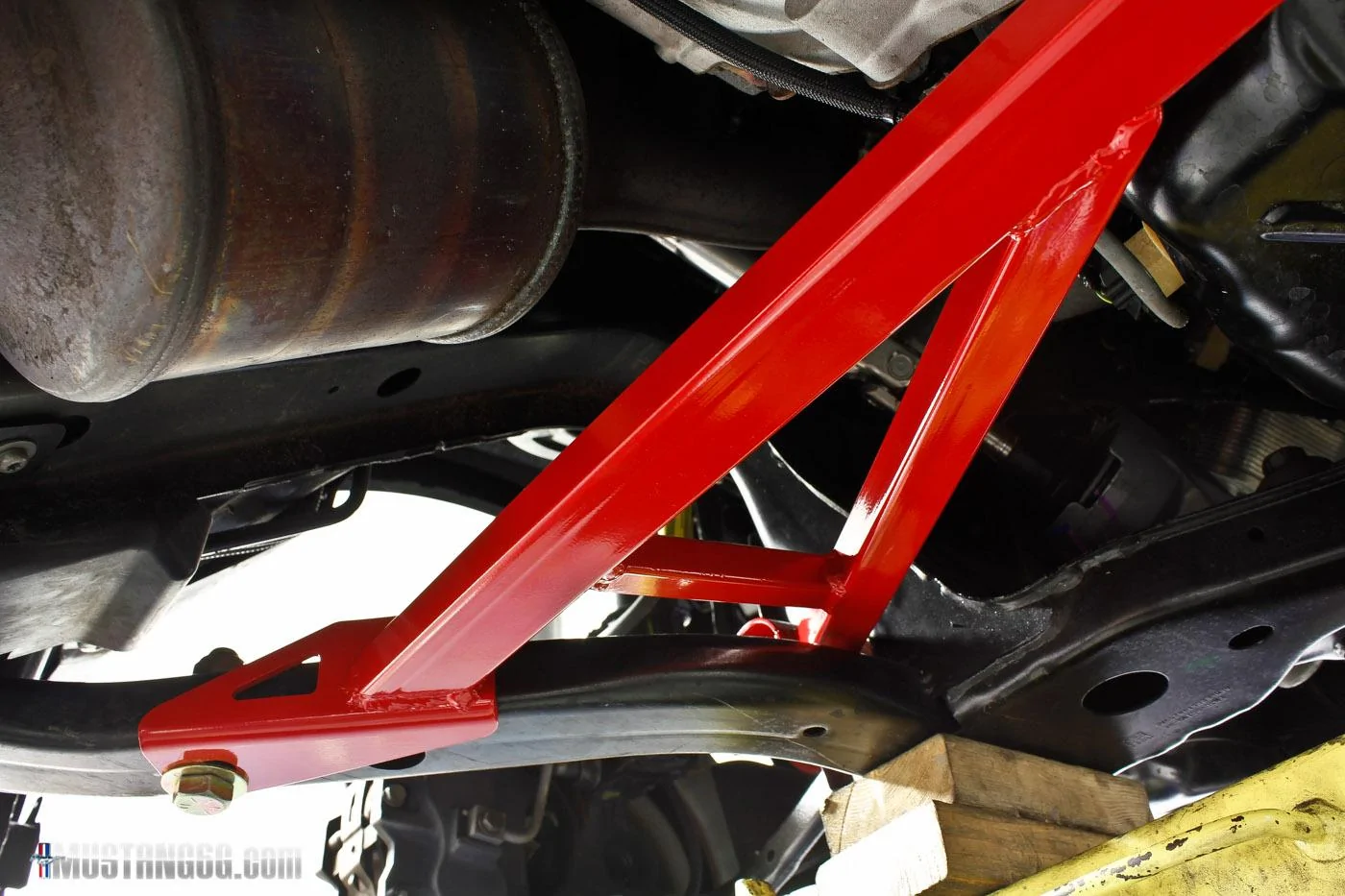

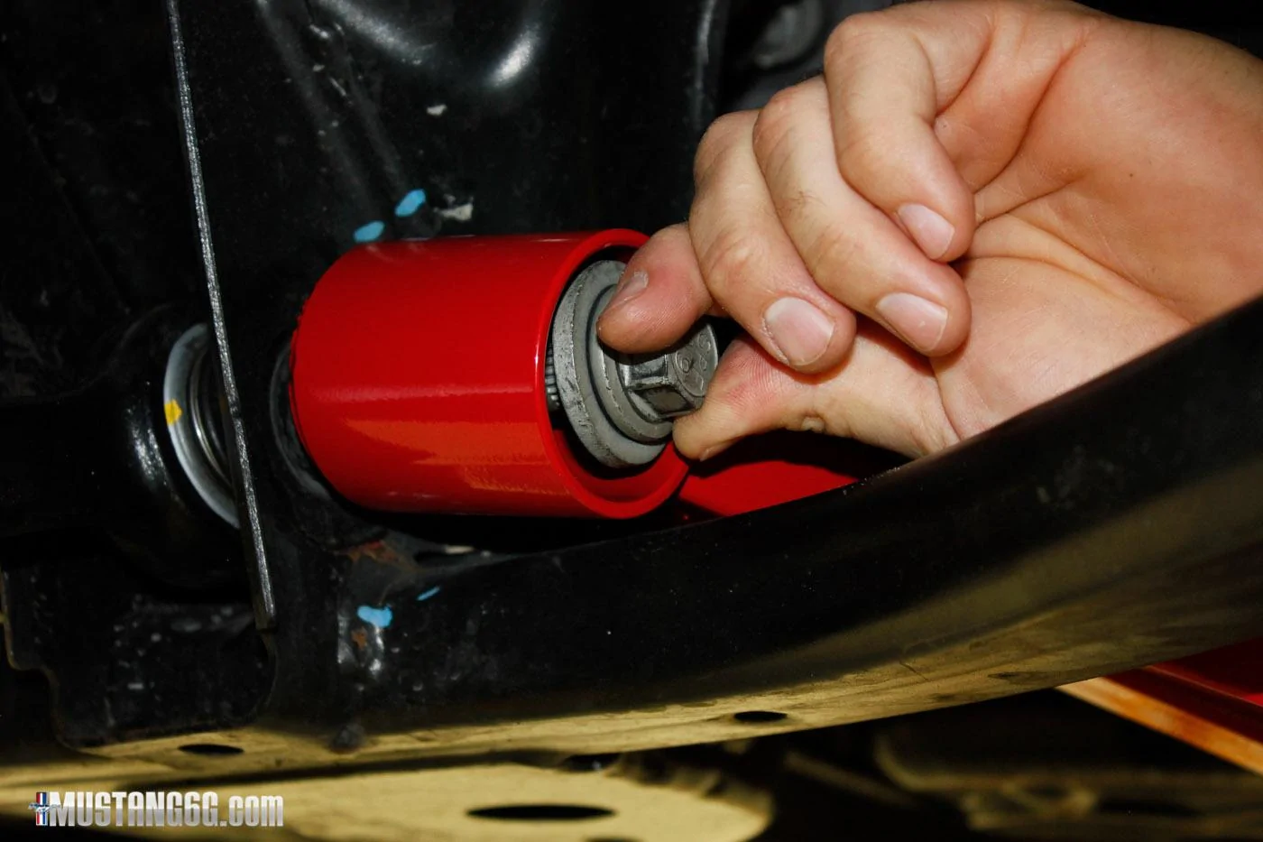

Next the bolts are retightened. Start with the control arm bolts on the front. This will draw the brace forward into the correct position. After the control arm bolts are tightened, tighten the rear bolts.
Installation is complete!

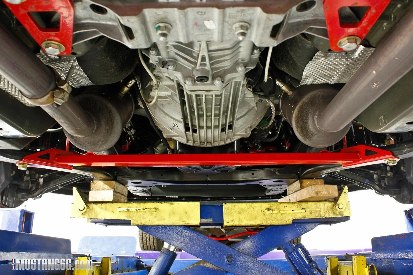

The CB006 leaves plenty of room for the factory or aftermarket headers and exhaust systems.
The design of the brace prevents any deflection in the lower control arm mount.
