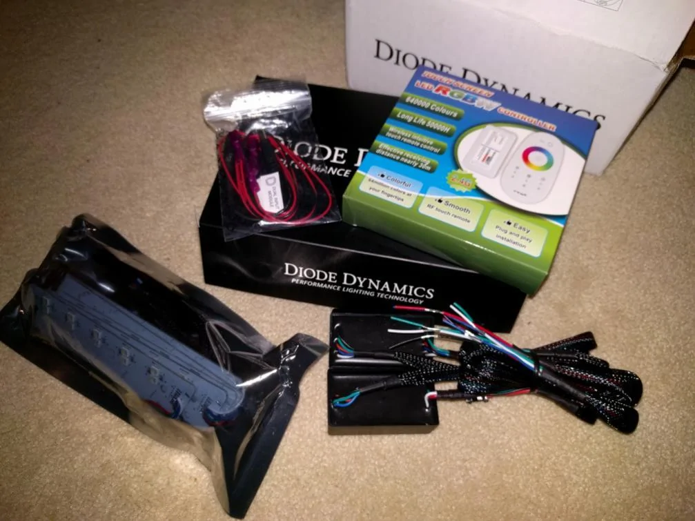

We want Tri-bar DRLs right? I've spent a lot already on bits to Americanize my euro Mustang and decided to do the DRL fix myself to save some money. My car is still sitting on the dock in Baltimore, but I'm happy to contribute my progress so far back to the community.

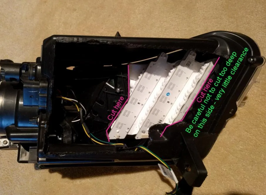

Here's a US headlight I cut open to get an idea of how I would install the Diode Dynamics kit in my euro headlights once my car shows up. I chose to cut rather than pry open the headlight because it's easier & less risky. These things will be worth ~$1000AUD each as spare parts so I'd be upset if i cracked a clear lens.
I decided on using a hot knife because it's fast and doesn't make a mess. I would suggest using a butane soldering iron with knife attachment. I tried a cheap electric one, but the blade never really got hot enough. I wouldn't recommend inhaling the smoke while you cut.
The outer enclosure is made of Polypropylene and was easy to cut. The piece inside is polycarbonate which needed a bit more heat to get through and got all stringy and sticky. There's also alot of ribbing on this piece which is why my cuts zig-zag.
Because this is a US headlight, you can see the factory DRL boards already installed.
I intend to re-seal it by melting the plastic back together and then running black silicone over the seam. Based on what I've read in the service manual and on the Europe section, I'll be wiring these DRLs back to the washer motor and disconnecting the stock euro driving lights so they don't even have a change of accidentally lighting up.

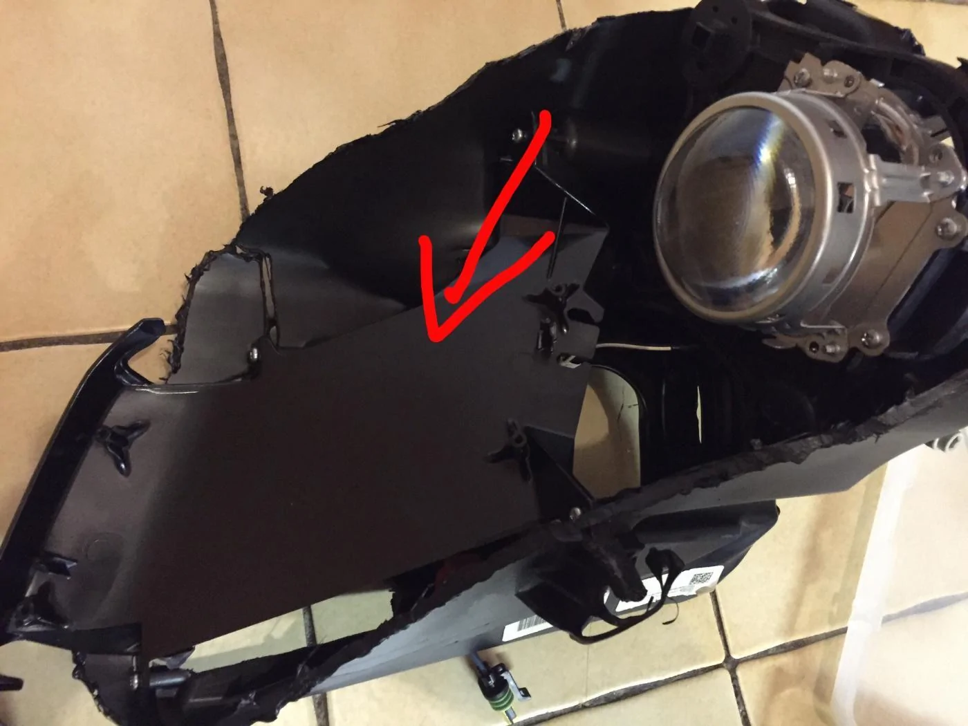

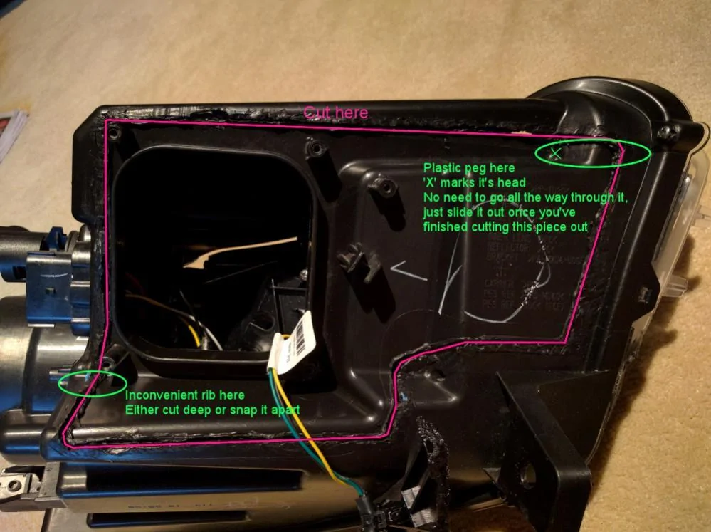

Thanks a lot for the write up, after seeing that I am thinking that this may be the way to go also. Not sure how heat will affect the lense and what it will look like when resealed, the top edge is really noticeable with the bonnet open, the back is hidden.
I understand the first cut on the outer shell, but then you say you have a second cut and to be careful how deep you go. I don't understand what the second part is. Maybe it becomes obvious when you open the back up, can you explain this part a bit please?

Bingo. The white defuser is screwed into that piece. The idea is when cutting it from behind you take out the middle section, so that with two screws either side it remains rigid.

Think it's this bit, the bit the white defused screws to,

But is there the housing that the drl boards attach to?

It is yes
Brilliant, thank you.
I was sure that as no drl's no need for support housing, just the reflector.
