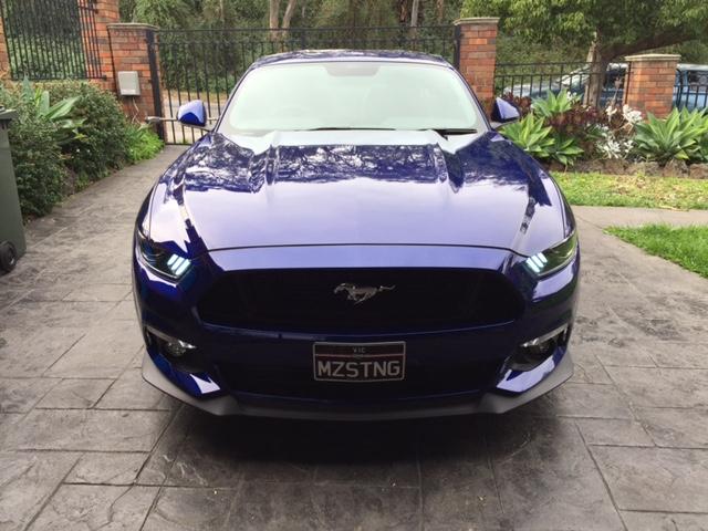

Banditvox
Dec 16, 2015
134
174
Melbourne
John
Ford Ranger and Mustang GT
With the DD system lights the DRLs stay on when the head lights are on. They don't dim they aren't bright enough. I've had mine in now for three weeks and i have a set mine with a light bit of blue in the light so at night it reflects the blue looks cool. This probably isn't legally but i see if i get pulled up.
Banditvox
Dec 16, 2015
134
174
Melbourne
John
You can just see there is a little bit of blue set in the light colour. I did try red one night and looks great evil almost. One good thing with the DD is the remote to turn them off at any time.
