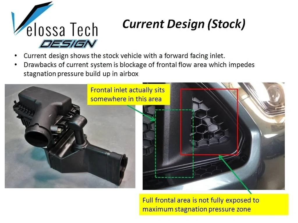

Hi!! I understand your concern. Drilling out the hex flats although helpful, is not really going to produce the ram effect. The reason is, to produce any net positive pressure in the airbox, or to reduce vacuum work, the air must remain at high speed through the inlet path.
Drilling out the hex flats on the stock system does not change the physical geometry in that cavity. The geometry in that space has a few issues that were probably put there by ford for manufacturing efficiency, not aerodynamics.
1. The stock inlet is blocked, when looking at the front of the car head on, you will see that the stock inlet doesnt have a straight frontal shot of air, the grill rib is blocking it, and unless you completely remove the grill, you will be losing your stagnation pressure there.
2. Removing the hex flats can help, but the air still has to abruptly change direction to enter the stock inlet path. Instead of the air stangating in the airbox, it will stagnate in the stock grill cavity, which means the air will slow down, and then speed up again. This is where efficiency is lost, your engine has to produce vacuum to get the air back into the path.

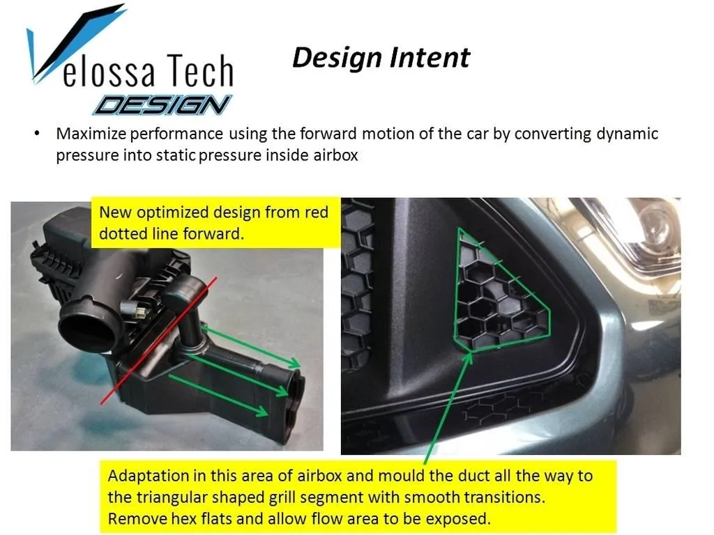

4. Flow guidance is essential to the ram effect, you need to keep the air moving fast all the way until it hits your engine. This is fluid momentum that is useful. A lot of OEMs use this method on higher end cars. If they don't use the method, it's usually due to manufacturing or logistics decisions.
5. The BIG MOUTH has aspiration ports, it makes almost a perfect seal against the stock inlet, but it has standoffs on the bellmouth to allow higher horsepower cars to breathe when moving at low speed before the ram effect takes place at high speed.
