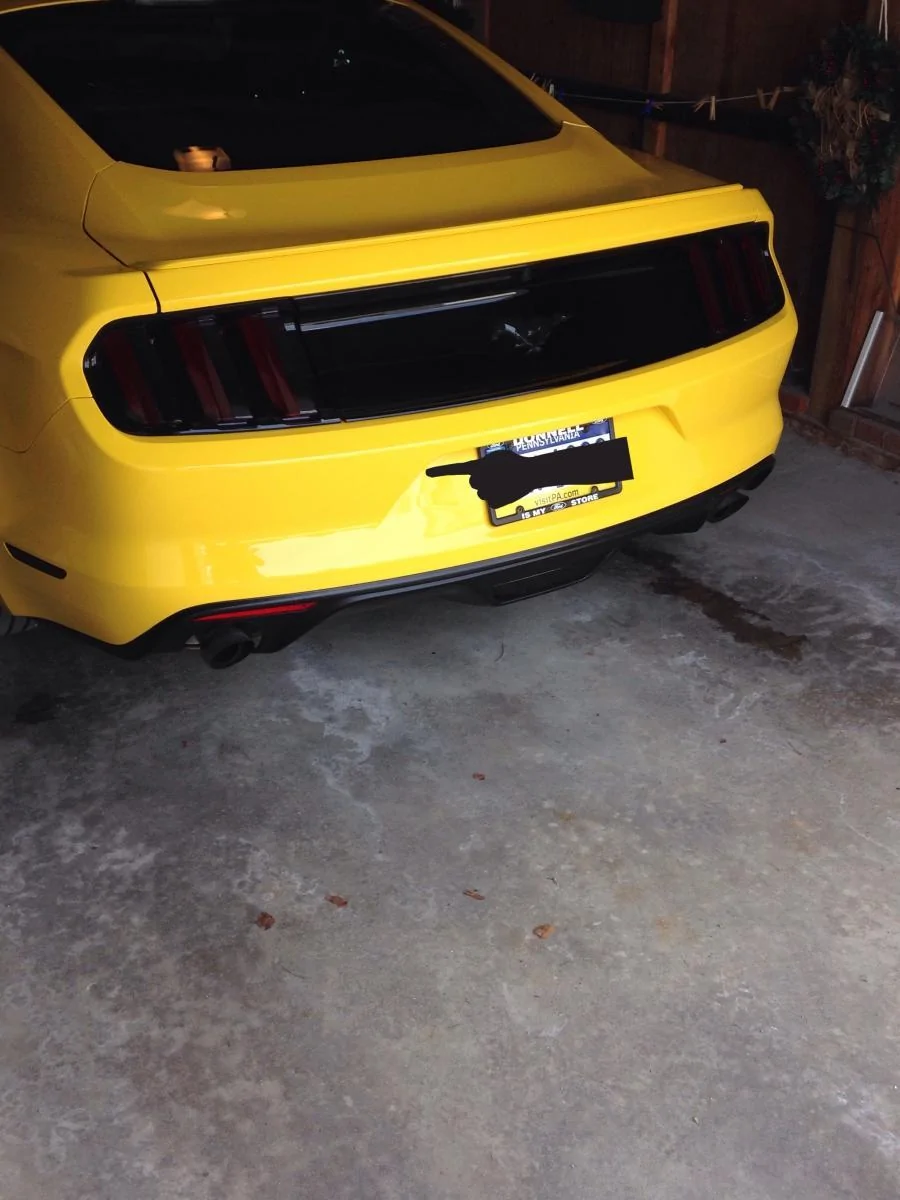

The Plastidip has held up surprisingly well for me.

Thanks! If anyone decides to do it themselves, make sure to take your time taping things off. Also keep in mind you have to peel the tape off before you let the dip dry or else the dip will peel as well. It's easiest to do the underside first before going up near the tape.

Hehe looks good guys. new project! Edwin you didn't leave a small portion at the bottom yellow like the premium models would have?

I tried it once leaving those two areas the body color but it was extremely difficult to tape off because there isn't a perfect lip on the base model. The base also doesn't have the two guns in that area so going full black doesn't take away from them like it would on the premiums. The problem is you have to paint the Plastidip in one full coat around the areas where the tape is. Otherwise the dip will start to dry and it will peel along with the tape when you go to take it off. So the less taped off areas, the easier the job will be. You can do it without having to worry about taping any of the lights or reflectors though. Those peel off easily when your done. Just go ahead and apply a thick coat on them. The thicker it is the easier it is to peel off in one piece.
