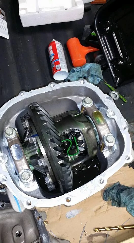

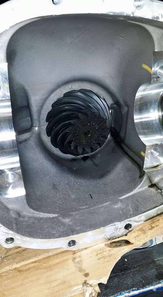

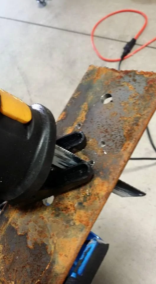

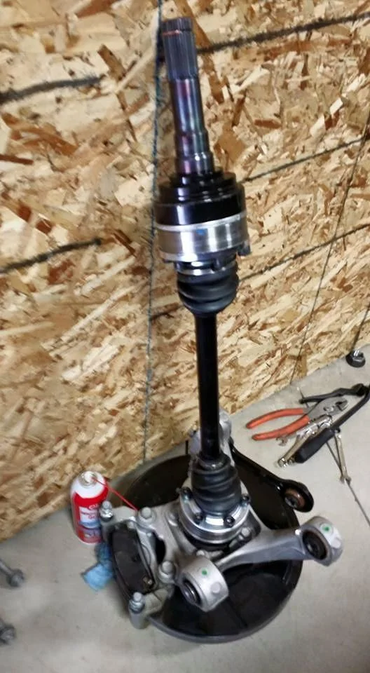

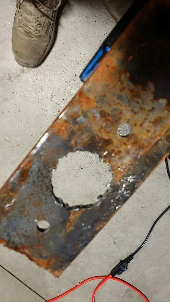

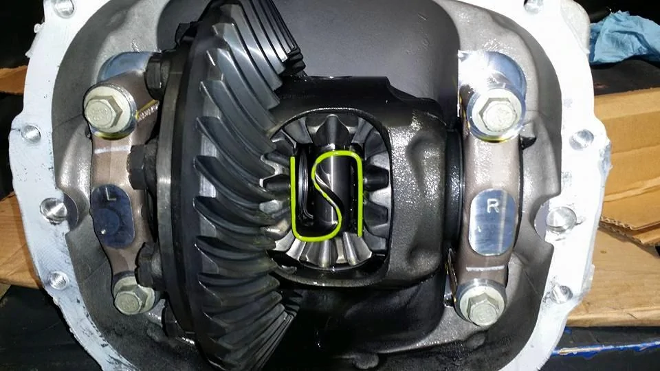

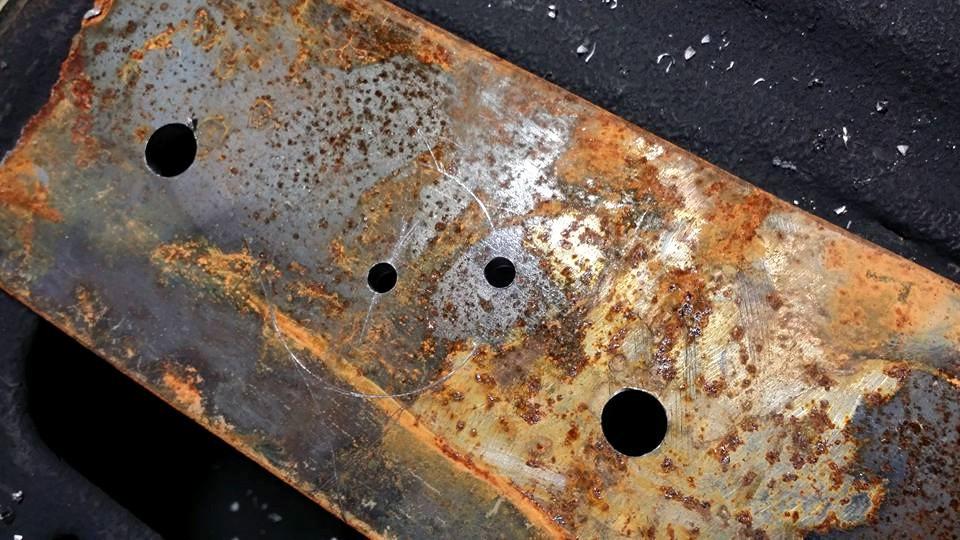

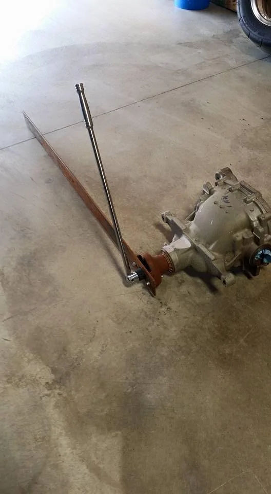

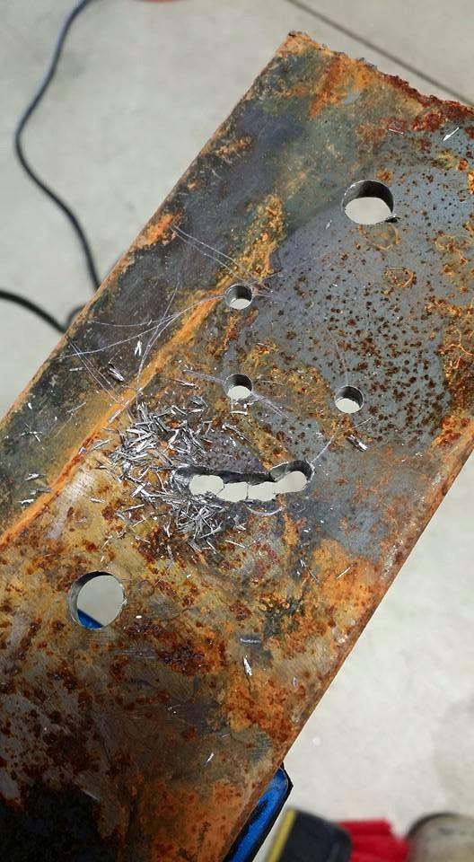

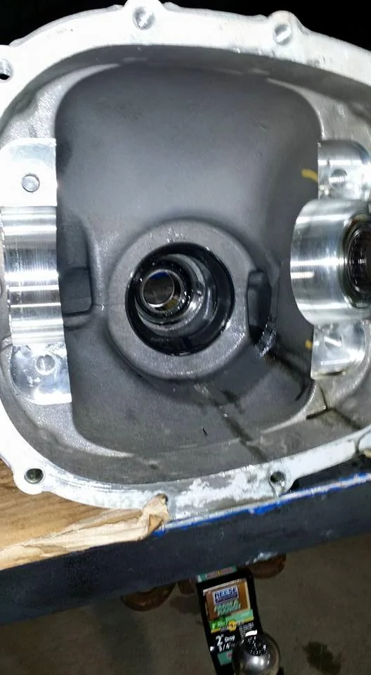

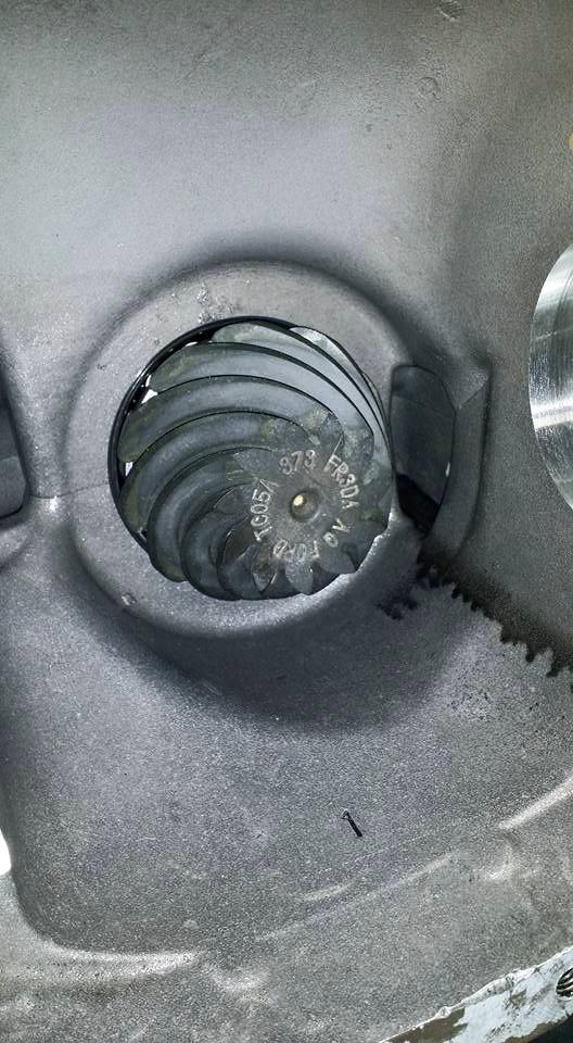

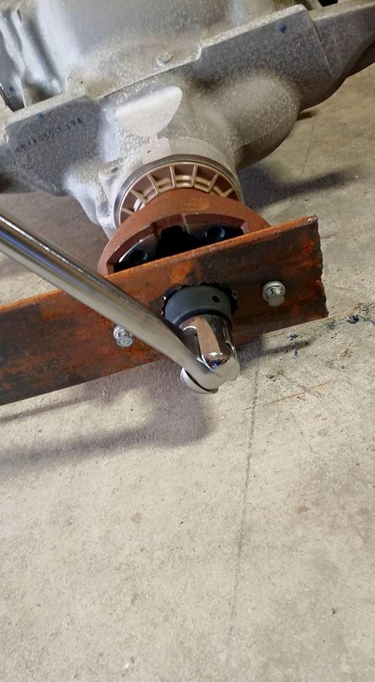

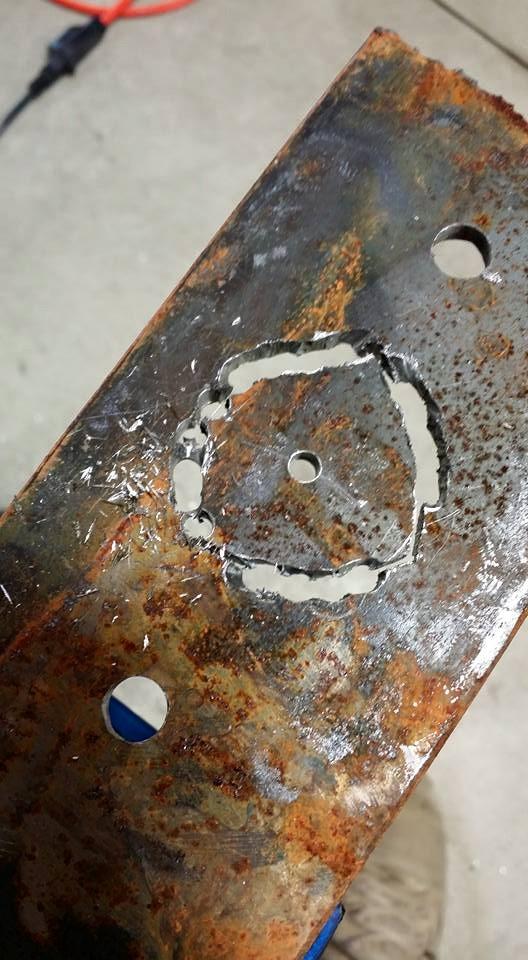

Good Lord I know this will cause a lot of questions & controversy, but here it goes I put the 3.73s in my rear this weekend. Now I can't answer all questions at this time(like who did the BCM adjustment), just know that Ford is coming out with a fix in the 4th quarter of this year. The 3.73s work just fine and the speedo is right on. These pics are to show you that even with limited equipment it can be done. Keep in mind I've changed hundreds of gears. You will see the holding tool I made out of scrape to be able to loosen the pinion and to crush the crush sleeve. Keep in mind I'm lucky if I could bench press a 100 lbs. All hand tools(except for the press for the bearings), no air tools. My stock pinion had a .038 shim under the bearing, that's what I put under the 3.73 pinion bearing. Fortunately the existing posi shims worked also. My posi was a super tight fit(the stock one & the new one), probably because of the aluminum housing. The install kit from Ford Racing had more than enough stuff including posi shims (20+yrs. ago we weren't so lucky to get those). Sometimes people get confused on torquing the pinion nut, you don't actually torque the pinion nut, you crush the crush sleeve to preload the pinion bearings and preload reading is in inch lbs of drag that it takes to rotate the pinion gear by itself. Think of it as an older front wheel bearing, where you tighten the nut to preload the bearings. It does take a lot of torque to break loose and to crush, but that torque number has no importance to the install. As you can see I use a long breaker bar to do this, not a torque wrench.

Well, it looks to me - and this might a photo angle thing - that the flange offset on the yellow spring diff is noticeably greater than it is on the green-spring diff. There looks to be more clearance between the ring gear bolt heads and the axle case wall. That's exactly what I'd expect, assuming the green diff was the replacement. I know for fact that Ford designed two different diff cases to cover the range of R&P ratios that they intended to offer. I was at the meeting where they gave the quote packages out to prospective differential suppliers. There were actually three differentials at the time, the 3rd being a heavy-duty version of the high-numeric case. That was since replaced with the Torsen and never saw production.
Great eye, I believe you hit the nail on the head. I was getting tired & blurry eyed lol. That makes total sense as the ring gear on the 3.73 was not any thicker to make up the difference of the smaller diameter of the pinion gear.
