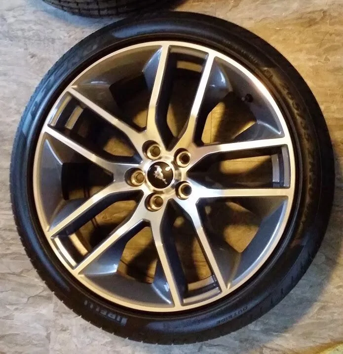

I have plans to pick up a set of these rims & tires tomorrow.
Just had a thought..... Will they fit over the GT PP Brembo calipers? I would assume so but need to be sure.

Crap is there anyone who may know?? I'm supposed to pick them up tomorrow 2.5 hours away :(
I was hoping going up in diameter would work

I don't think any factory wheels other than the PP wheels and LE wheels will fit the Brembo brakes.
I agree with Grimace. I believe the only factory wheels that fit over the PP brembo's are the PP and LE wheels. Cannot be 100% sure, however.

those being 20" wheels, you have a solid chance.
if not they would likely hit on the inside face of the wheel against the outside of the caliper due to the caliper width, which could probably be corrected with a 1/4" wheel spacer.

Yah I'm thinking this. If s spacer is needed I will probably get longer studs and go that route to be safe. And, I'll get more offset to push the wheels out a bit [emoji4]
Well, guess I'll be the guinea pig cuz I'm gonna take the chance.
Got my fingers crossed

can you try one before you buy them?

Well, no.
Have to take my truck because the 4 wheels won't fit in my mustang and its a 2.5 hour drive....

I would recommend for you to try it on the front to make sure it clears to be 100% sure.
since you are purchasing them the seller shouldn't have a issue with that really.

I will not have my car with me to try because I can't fit them in it to take them home

what if you brought one of you PP front wheels with you and did some measuring side by side.
How about one in the trunk, two in the rear seat, one on passengers seat ? Wrapped in something of course...

I want to know if they work please. I've heard they will in another thread here

Why wouldn't they? Those are Ford 2015 Mustang 20". The PP only has 19".
