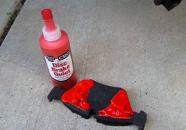

My Brembo's are fine so far, no noises.
I did have issues with my last 2 cars, Shelby had Brembos, and I used this product on the back of the pads, and it eliminated all of the noises. There are other products on the market too, but this stuff seam to do the trick for me.
