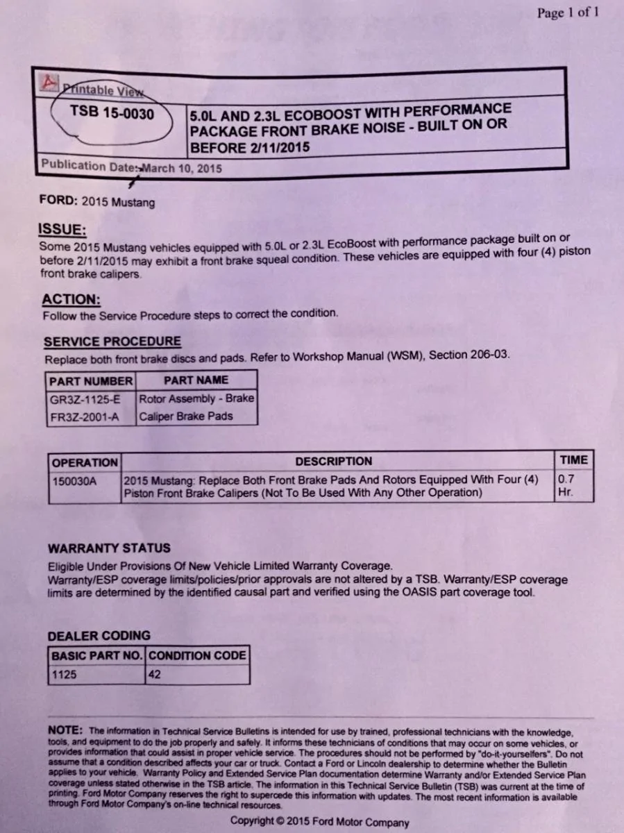

What is the TSB for the brakes? I'm taking the car in this weekend for oil change. I have the tab for the seat. Just need the brakes.

See if this works. I hate posting pictures in here, such a pita.

Which one? I posted the brake one above
