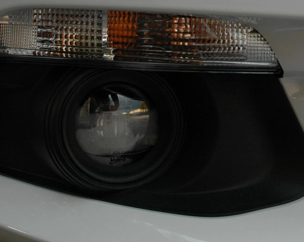

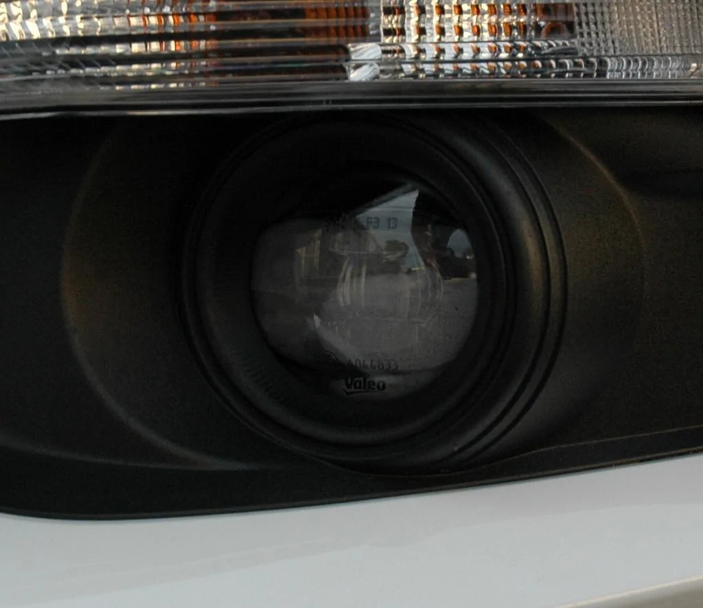

Is anyone else getting condensation in their headlights? I went and picked up my car last night from the dealer. It was raining all day yesterday and was very humid and cold outside (for Florida, 50 degrees). When I got home I noticed there was condensation inside both headlights. It dropped from around 75 degrees to 50 in about 2 hours.

I posted pictures of my foglites this morning which they moved. I guess you aren't supposed to complain in the maiin forum.
