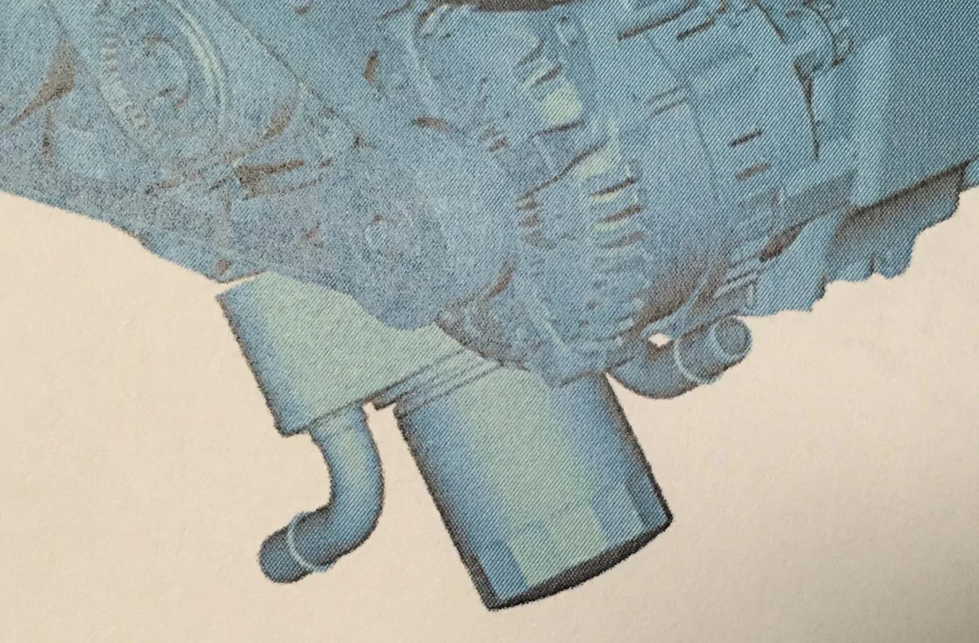

Are you going to be using the GT 350 Oil Filter/Supply and Return Adapter, or something else? My PP Filter Adapter has the standard integrated heat exchanger with Radiator Supply and Return lines instead of Oil lines.
JWS
May 3, 2014
1,004
237
Dunnellon, Florida
PP Radiator Heat Exchanger Oil Cooler
This is the PP Radiator Heat Exchanger Oil Cooler
