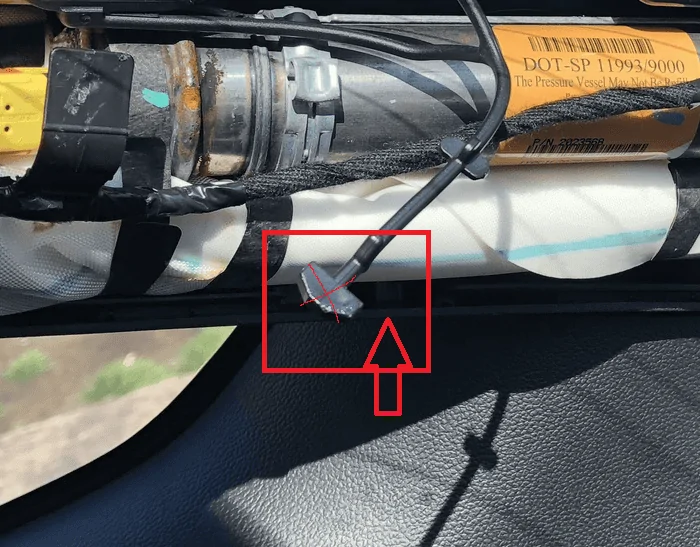

sorry for the vertical video

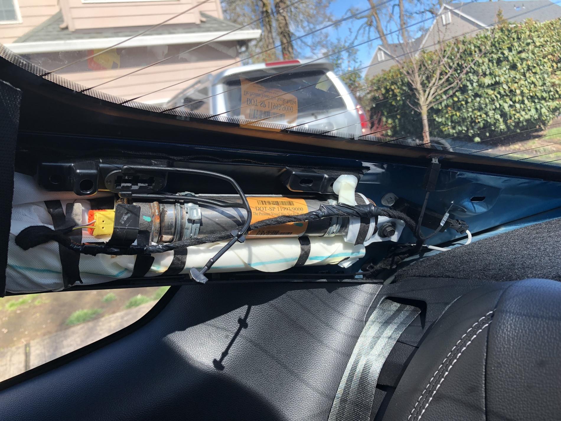

What's that long piece of plastic hanging out in the wind with the T on the end? Does it get secured somehow?
Video's processing right now, but can you see anything wrong in this picture? ‍
Yes, it's a double ended T twist to fit inside a slot on the C pillar. One of the metal clips had a plastic bracket that the T goes in, it's so when the air bags deploy that the pillar don't fly around the vehicle from the force of deployment. They're on all of the A/B/C pillars.What's that long piece of plastic hanging out in the wind with the T on the end? Does it get secured somehow?
Yes, the tether does not look like it was ever secured properly during factory assembly. So with it unsecured, it must be bouncing off the C-pillar depending on road imperfections, driving characteristics and normal NVH.Yes, it's a double ended T twist to fit inside a slot on the C pillar. One of the metal clips had a plastic bracket that the T goes in, it's so when the air bags deploy that the pillar don't fly around the vehicle from the force of deployment. They're on all of the A/B/C pillars.
Did it fix the issue? I have a 2015, and have had the annoying tapping from the c pillar forever that sounds like this . I put felt in the area, but I don't know how to fix the tether from banging against the c pillar cover?

Hey man! do me a favor and tap on this area of the pillar when it's stopped. It should sound kind of like metal/hard plastic hitting eachotherDid it fix the issue? I have a 2015, and have had the annoying tapping from the c pillar forever that sounds like this. I put felt in the area, but I don't know how to fix the tether from banging against the c pillar cover?
Yeah. Not sure how that happened either. Cars got 6800 miles on it.^^^ Rusted metal in that 2nd photo? Is that the airbag canister?
