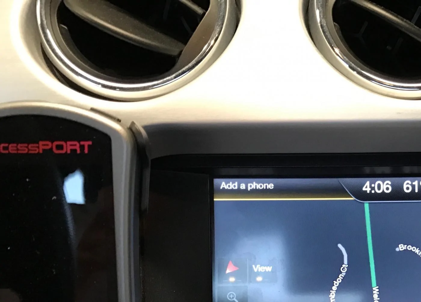

No problem. I got it working. Had to improvise. Lol. All working. I guess after the master reset Sirius works again. I'm assuming it's a trial like when u buy ur car? I don't have a subscription....
HoosierDaddy
Jan 2, 2016
3,382
7,139
2016 GT Premium PP
Sirius is free for everyone at the moment.

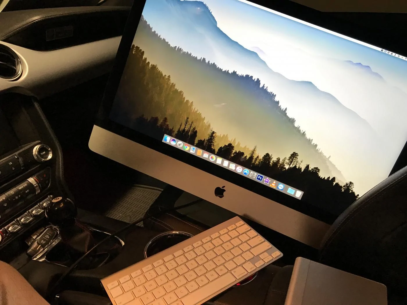

No you can't. Only windows version has the ability to mod values.
What if the user has a MAC and is using it in "Windows" mode, can't the MAC user then make the same changes?
Also any known issues with the WiFi version of the tool, or is everyone just using Bluetooth?
vogtaction
Jul 9, 2015
142
St Louis
Sean
2015 premium ecoboost auto mustang
Yes. U can use VMware. That's what I used running windows 10 and worked just fine besides having to lug a huge iMac out to the garage since my windows laptop didn't have Bluetooth. I was going to order the wifi version but the reviews on amazon weren't that good so stuck w the Bluetooth.
