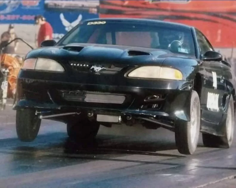

I remember all the S197 guys proclaiming the IRS is garbage for drag racing. Now those IRS cars are running 7's on a stock super 8.8, whereas the s197 guys need serious upgrades to the diff to run the same.

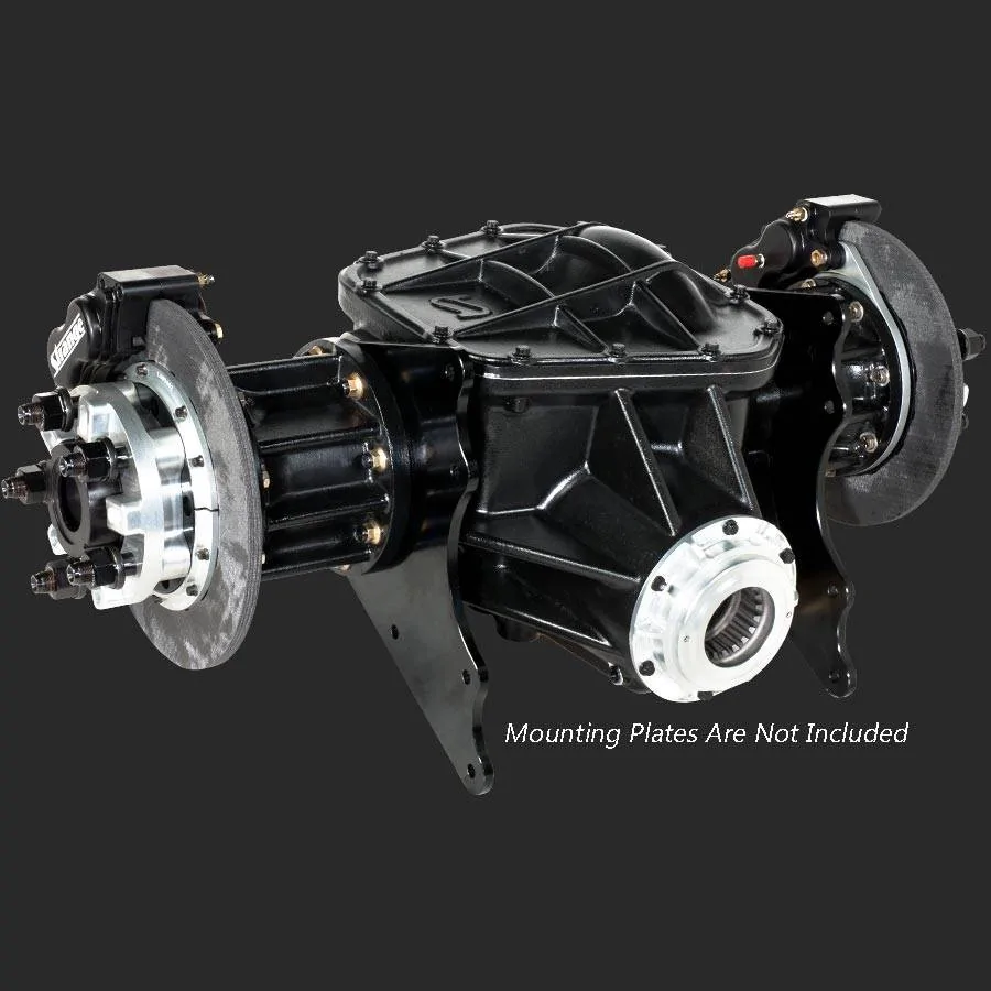

If you’re building a purpose build drag car. You can’t beat a good old Ford 9 inch for drag racing. But the IRS cars are doing pretty good.
