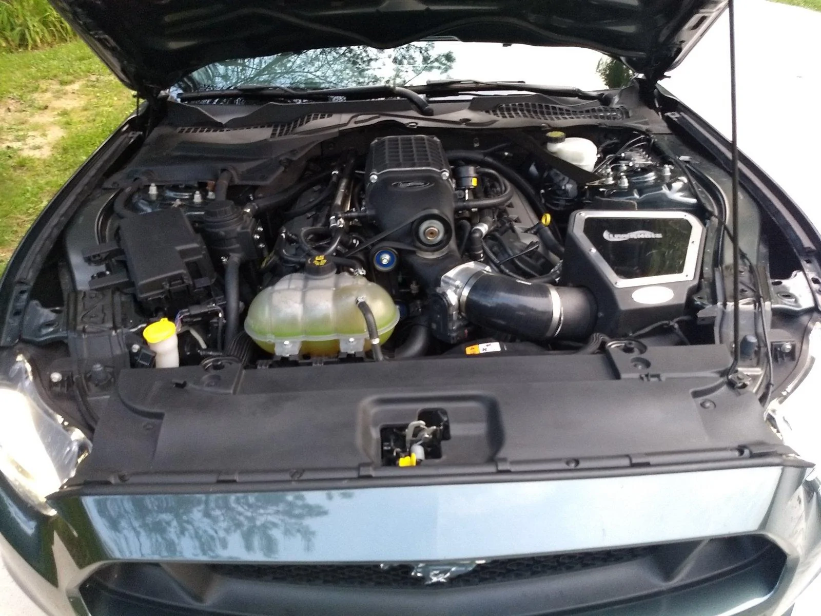

I received my car back from Livernois Motorsports today.
Andy one of the calibrators called me to update me on the car and drivability repeatedly over the last few weeks. I went there and drove it Monday, but drivability was still an issue. Specifically in that intermediate area where you accelerate kind of briskly, say 1/4 power. The hesitation when shifting was there. I will report back the issue to him tomorrow, but will drive it for a while to see if I can live with it.
I have to say they took every work I had to heart and tried to really make it work, but still bizarre how it drives. I picked it up with my brother and asked him what he thought. He asked me "are you doing that with your acc pedal?" No. Just very wierd.
LMS worked on the blowoff valve, switched back to the larger pulley, etc, etc. In fact the calibrator called me on Saturday and at night to talk of the issues as well as the Manager. I was treated very respectfully, The car is just irritating in mid range.
For the good news, the car was detailed very nicely. And, it really does shift at 8,000 RPM. Truly incredible. Full throttle drivability is fine along with the full throttle shift.

602rwhp witht the smaller pulley. I asked them to put the larger pulley back to try and get it more drivable. With that pulley, 602rwhp. Torque high 400s. I don't know boost, but now probably around 10psi? The dyno graph much smoother. The engine is smooth and revs freely to the shift point which is 8,000 RPM. I am sure it is because it is line bored, balanced, etc. I was thinking of selling the car, but if I can get it a bit more drivable, that would be the cat's meow.
