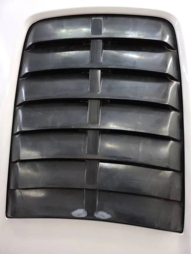

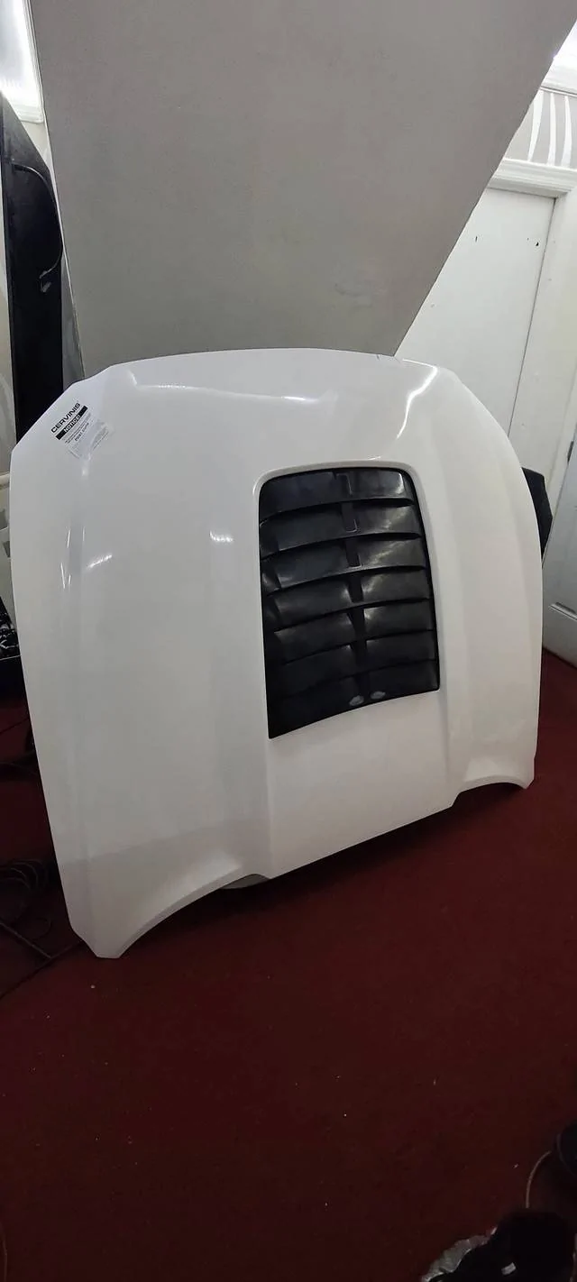

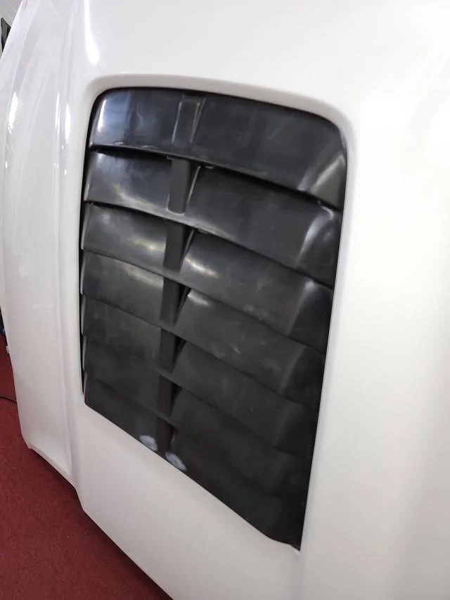

Did you order the louver on the hood unpainted, or painted matte? Curious what unpainted looks like.
Copperhead73
Oct 13, 2019
358
445
Knoxville, TN
Derrick
2019 Mustang GT Premium Convertible PP1, A10, Mag, B&O, A/E, S&S
Unpainted
Thanks! Would you consider it a decent match for the glossy black parts that come stock, or does it need to be painted glossy black? Hard to tell in the pic.
drak24
Jul 1, 2015
new york
2015 Race Red Mustang V6
Definitely needs to be painted over, even wet sanded if you're looking for a completely smooth finish.
