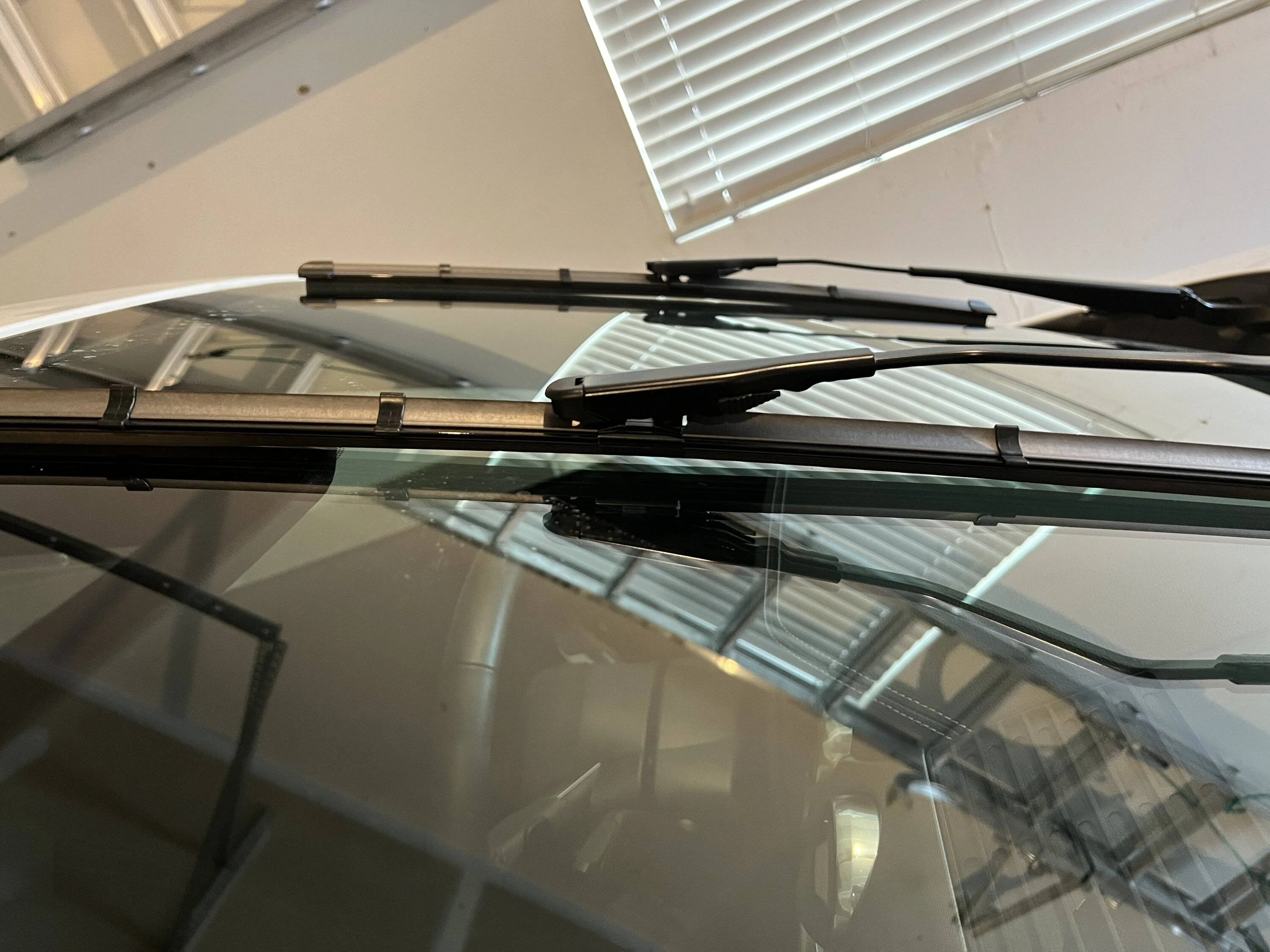

I was looking for new wiper blades for my 2021 GT, and many places and brands don't list anything. I saw one reference in the forum to an odd attachment style. Can someone explain what is different about the Mustang, and what years are compatible?
I have an issue with my 2021 GT where the wiper blades don't contact the windshield in the middle when at the top of the stroke. Slightly visible in the attached pic. It's been this way since I bought it new from the dealer this year with 25 miles on it, and there are so obvious signs of damage. There is one other thread here from someone with the same issue. I took it to the dealer and they don't know what the issue is, so I am going to take it to another next week.

Also for the Mustang there will be a workshop instruction for the alignment of the wiper arms, the authorised Ford workshop might even have a special tool for axial twisting of the arms.
You won't find anything better than the OEM wipers.
In your case, I would simply bend the wiper blades to a larger radius.

You can't change the shape, they are spring steel. But that's not the problem anyway, they are not very stiff and aren't pushing the arm away from the window, the arm is holding the blade away from the window. Bending the arms axially won't help but they do seem to need to be bent horizontally. But sounds like it's probably an adjustment or installation issue, so I'll just take it back in and ask them to look it up. Thanks!
You can also deform a spring steel somewhat if you overstretch it. You have to significantly overbend the wiper blade, of course.
Also worth a try would be to just buy fresh wiper blades, maybe yours were stored poorly or came from a bad batch.
I would give both a try if the workshops fail.

You also need to have them check the pressure of the wiper arm itself. Insufficient pressure can result in lifting.
Also length is 22” and 20”. All the major brands are good but honestly I like the OEM blades I can get with my FordPass points

Yeah initially I just thought it was the blades and was just going to buy new ones, but then I checked it more closely. The arm pressure seems fine, and the blades are pretty floppy and don't have much spring. The arms are simply too far from the windshield in the up position.

Maybe the problem starts with the mounting of the wiper motor?
I would check that.

Got the new arms today. It fixed the issue on the driver's side, but not on the passenger side. But the driver's blade wipes the area that was a problem with the passenger blade on the way down so I don't think it's much of an issue. Although I need to drive it in the rain to be sure. But we just finished a couple weeks of rain, with none forecast for the next couple weeks.
