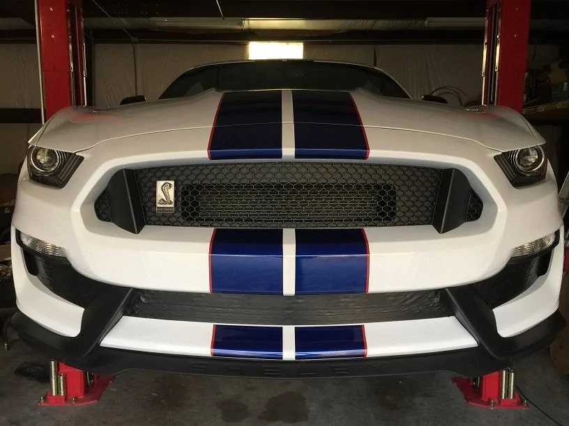

I live in Arkansas where it doesn't get much below the 20s most of the time (although it's going to be 8 tomorrow night). I block 100% of my lower grills with tape, and run it this way between late November through February. On warm days, the oil and water temps will get slightly above normal, but never high enough to cause alarm.
One benefit is that it allows the trans temp to get into a warmer operating range. On my car without tape, the trans never gets above 100* in the winter. It will now normally run about 120-150*.
Here's what mine looks like:
Sounds like this is the best idea. I think I could be content with that. Looks oemish haha and at that low no one could barely tell.
