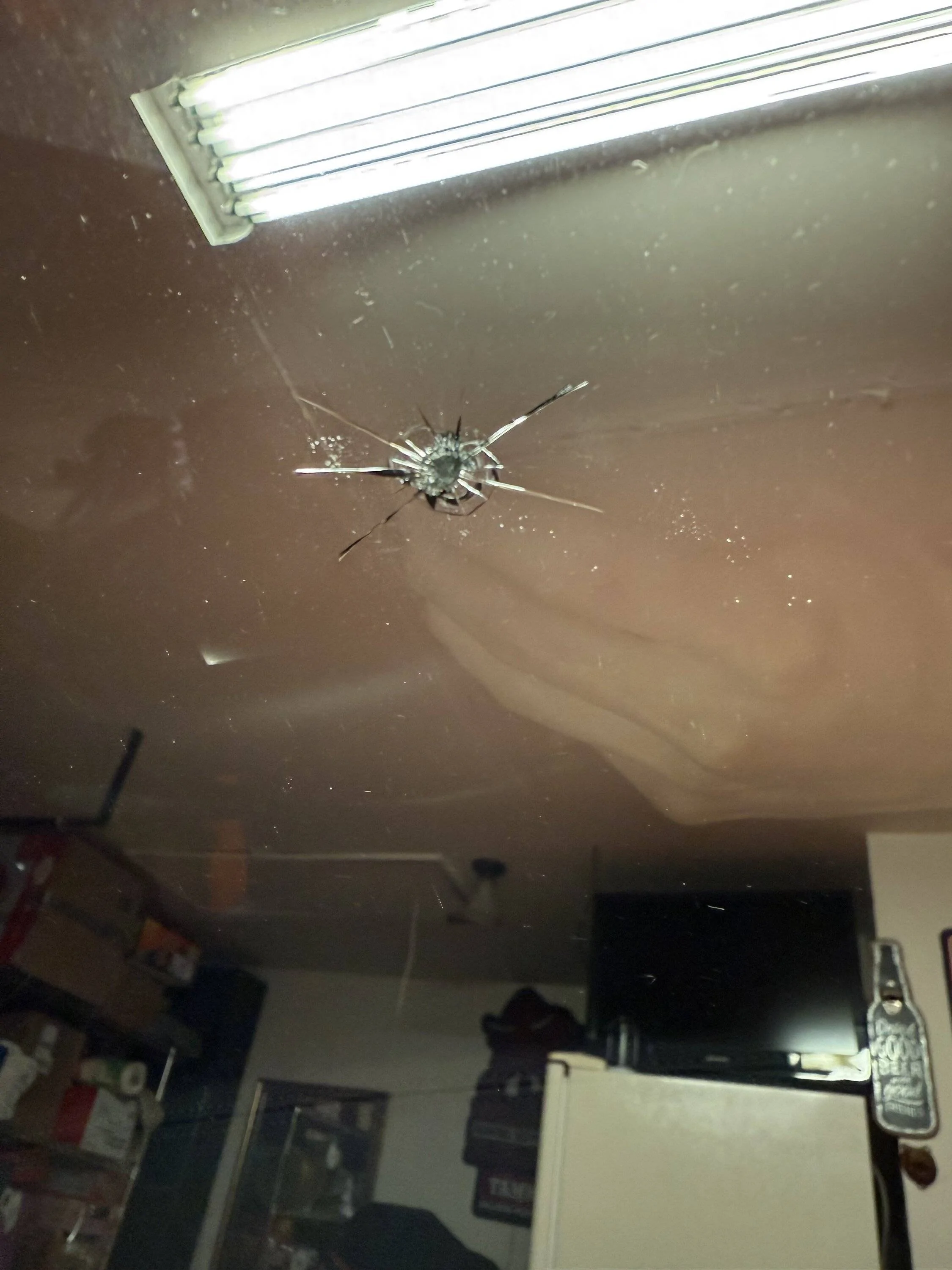

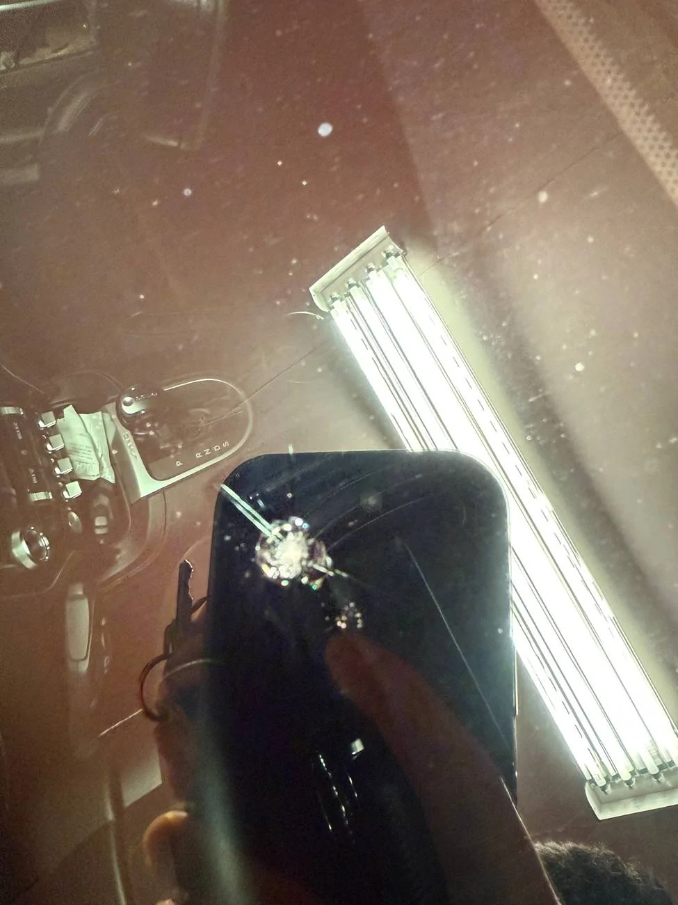

A rock hit my windshield and now I got an eye sore on it. Have any of you guys gotten your windshield replaced? Mine is a premium so it has sensors on the windshield. I heard its best to get Oem to keep all the sensors and stuff working. Might live with it for a while

That looks pretty big. Even if you don't replace the windshield, you should repair the chip to keep it from spreading.
If it's in your line-of-sight you should probably replace the windshield. If it's off in a corner or otherwise out of the way, I would still get it repaired/filled. Safe-lite will come to you and pump in some epoxy (or something clear material) that should keep the spider web from getting bigger, and may also make the damage less visible. Replacement or repair should be covered under the comprehensive section of insurance and thus be little/no cost to you (and not a huge risk of raising your premiums).
I have three separate repairs to fairly small dings received over the years on the lower passenger side. They haven't gotten bigger and because they're not in my line of sight, I rarely notice them.

I thought there were guidelines for what size windscreen chip/crack can be repaired? Seems like it was drivers line-of-site and/or 3" long?
The OP's looks close to 3" but perhaps it's just the perspective.
