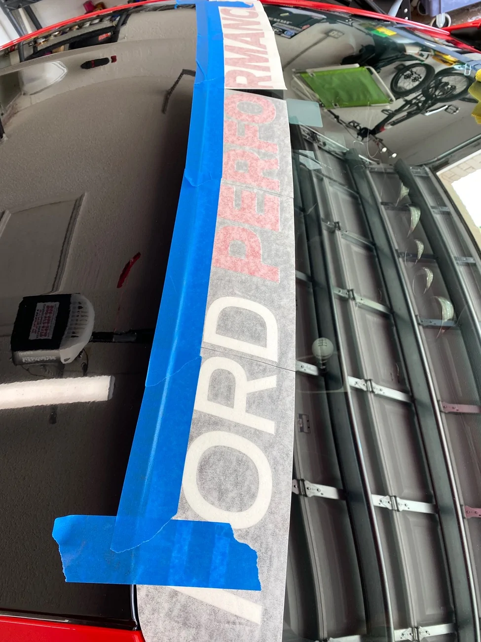

both methods have their ups and downs. Dry install requires you really work the decal whole. You can tape it in place (Pro-tip, cut the backing paper between two letters in the middle). Tape it in place and work one side at a time. Work from the middle out one side at a time. the tape you placed to hold it in place will do just that.

I did the dry method, which is what I believe FP recommends for the install. I did the install solo, taped it down on the windshield using Frog tape. As mentioned in the post above, cut the backing paper between Ford and Performance, that will help since it’s so wide. That will allow you to work from each end towards the middle. Just take your time, once it’s on, there’s no turning back. The adhesive grabs pretty quickly

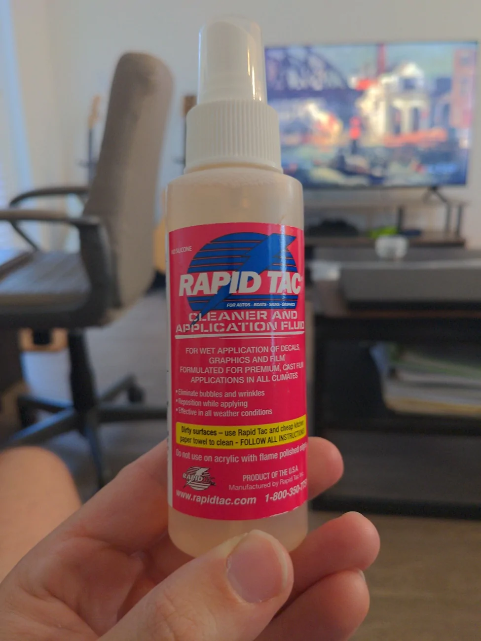

Can get a small bottle of tack solution. I’m sure Amazon has something. A friend of mine bought an Expel PPF repair kit and it came with a small bottle which he gave to me. I’ve used it to help some buddies with vinyl applications, it works well

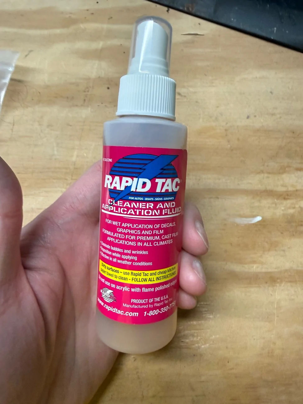

I am not familiar with that product. At my shop we use a product made by "Rapid Tac" (www.rapidtac.com). A cheap spray can of glass cleaner works fine. You can also make the fluid with water, a few drops of dish soap and a few drops of alcohol in a spray bottle.
If you don't have a hard plastic squeegee, a smooth credit car is an OK substitute.

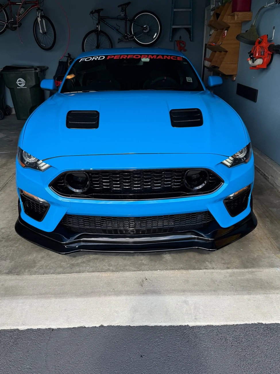

Looks great!

I’m partial to the red and white banner myself

It looks good on every model from top to bottom. Love it.
The Shelby banner was a somewhat close second, but the red in this one is just too good to pass up. Especially on our blues

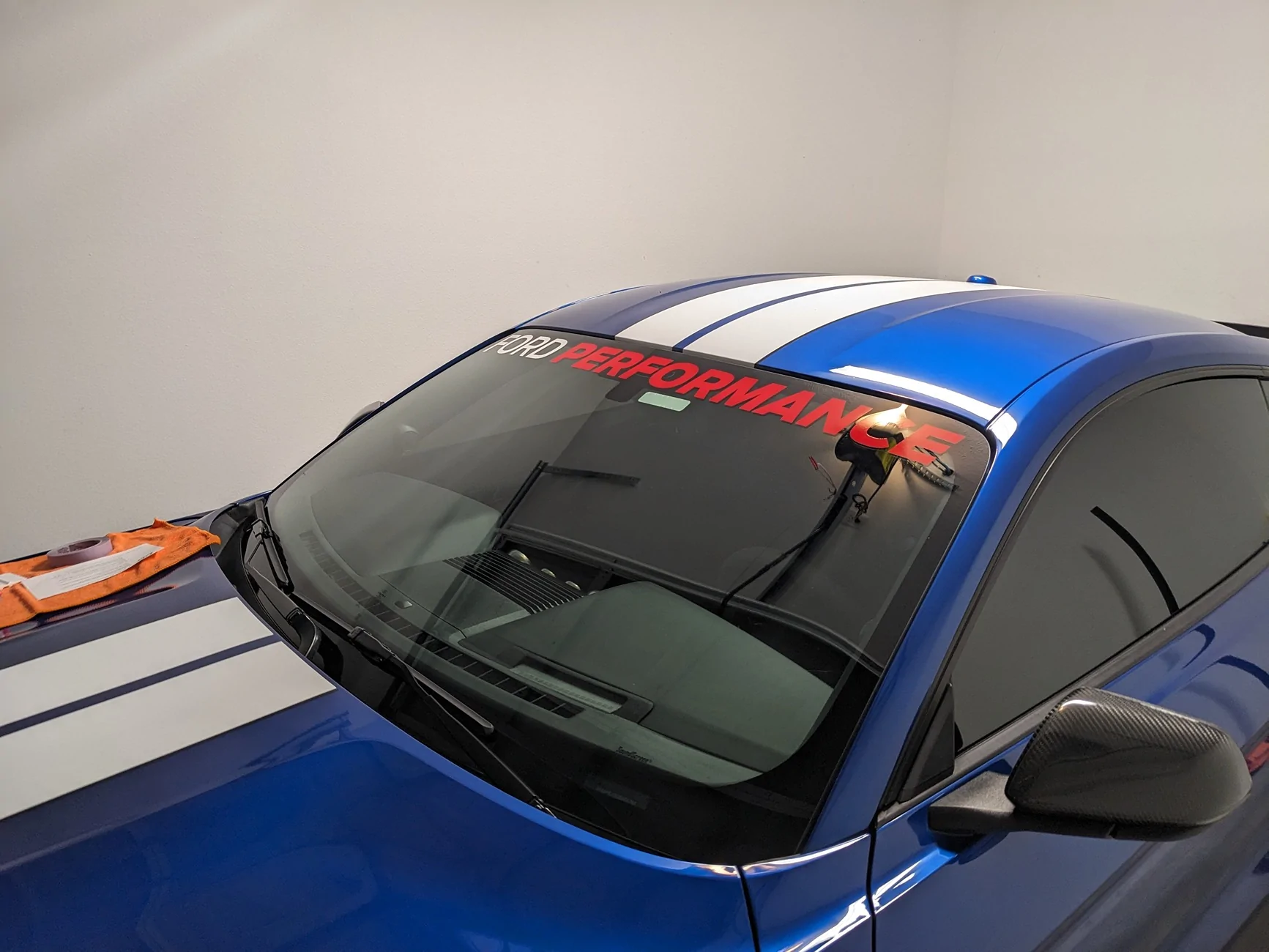

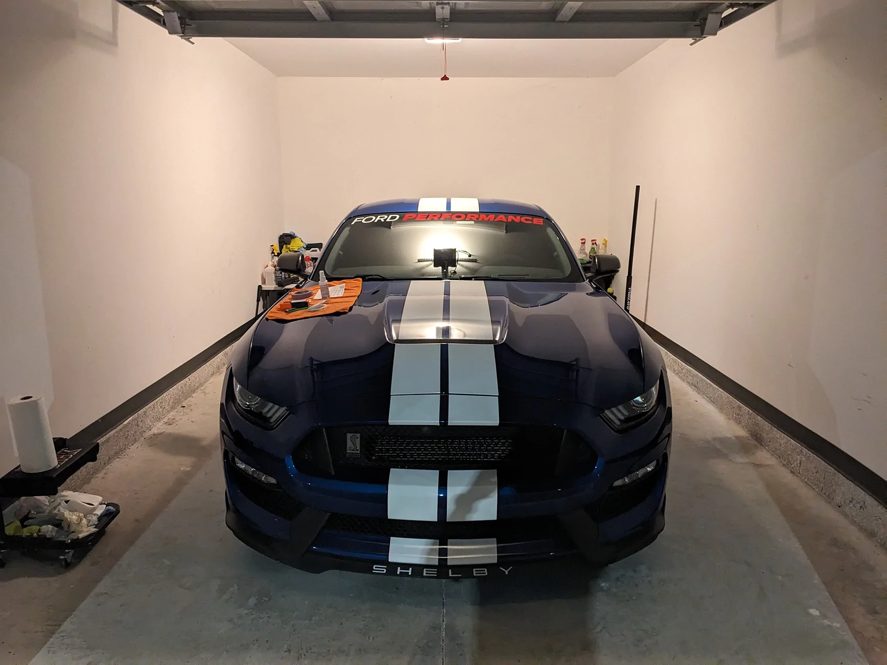

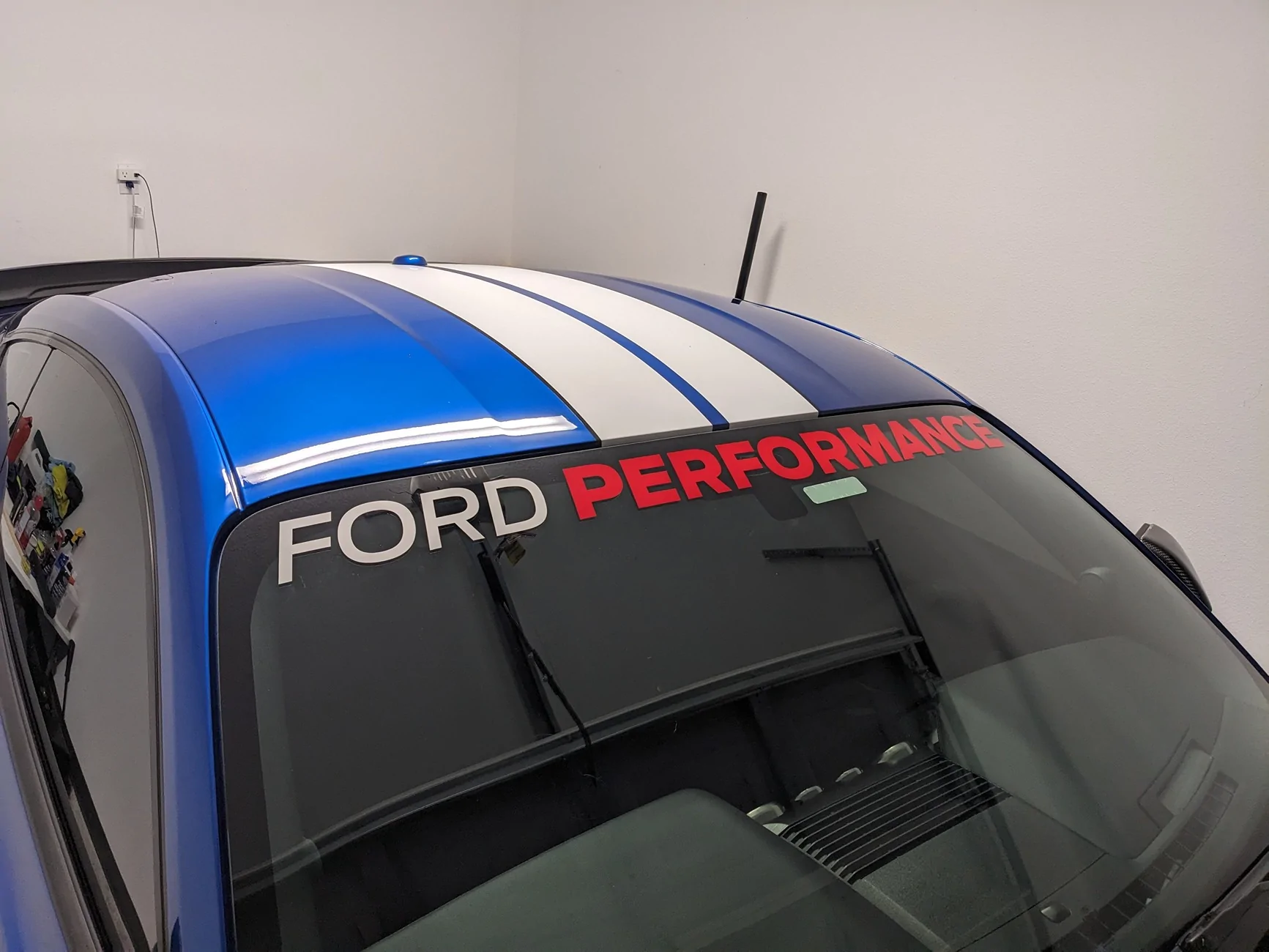

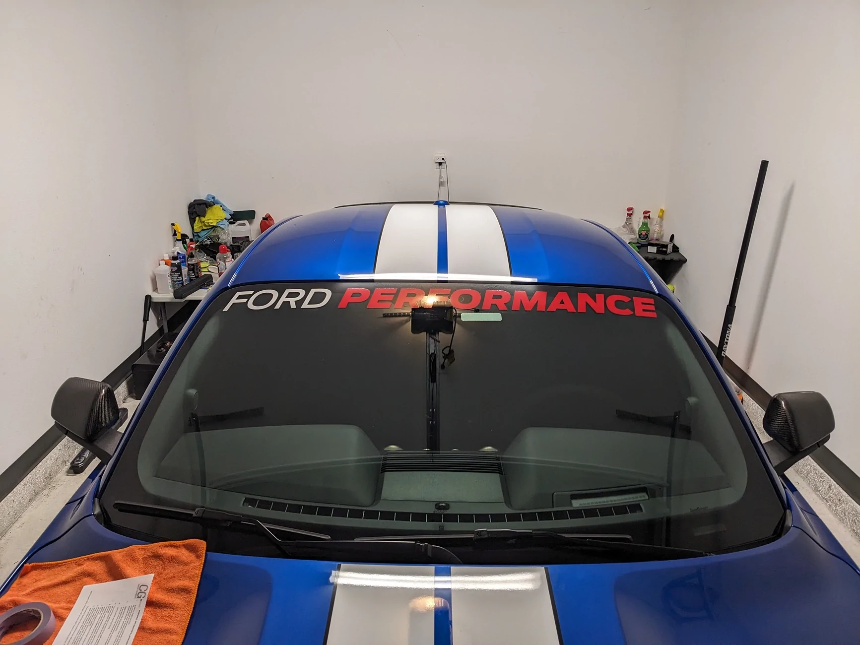

The banners look sooo good with the blue! I know I’m late to the party, but I have some pictures while putting it on ā€˜dry’ 5 years ago. In case anyone is looking to do this in the future and finds this thread, here ya go! And for what it’s worth, the decal has held up really well with very minor peeling from the windshield wiper path.

I’m in FL too, South FL, so I know what you mean! I don’t remember how long before pulling her out into the elements, but I put it on the dry way so I honestly didn’t even think of letting it cure, or sit.
The only ā€˜ugh’ I’ve experienced is driving in a torrential downpour for an hour or so and the decal picked up some black streaks from the wiper. Decal held up like a champ, and the streaks came right off with the next wash.
Also, I treat all the glass with RainX and I pretend the decal isn’t even there. No discoloring or deterioration detected! The FP decal has actually surprised me with how hardy it is. Now go out and enjoy showin it off!
