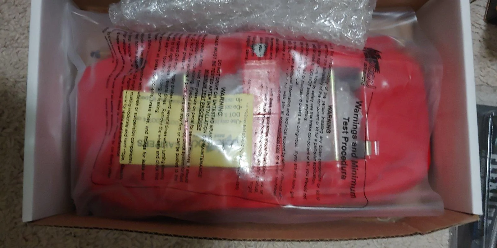

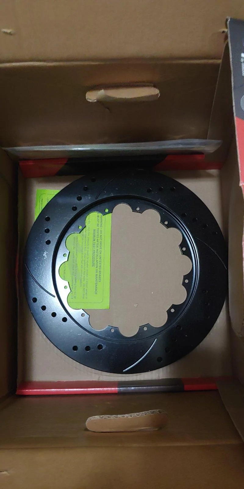

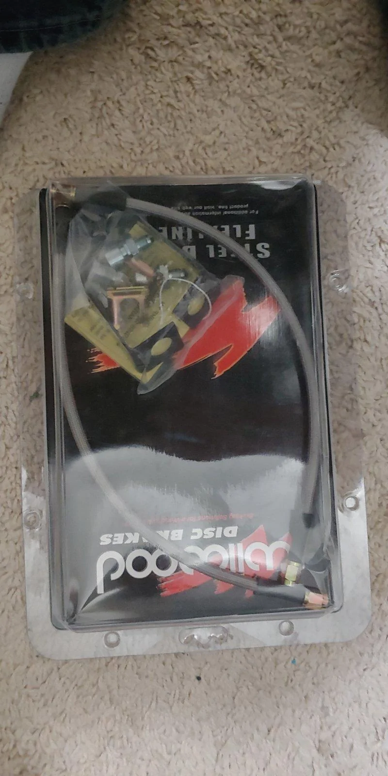

I got these on a deal. $1200 out the door taxes and shipping. I know the reg Brembos are good but these were actually about $200 cheaper. I know drilled isn't as good but the rings are only $279 each. Should be a serious upgrade over my stock 4 piston stoppers.
With the 14s I have my choice if 18 or 19 for my track tires and rims.
My b day came 1 day early.

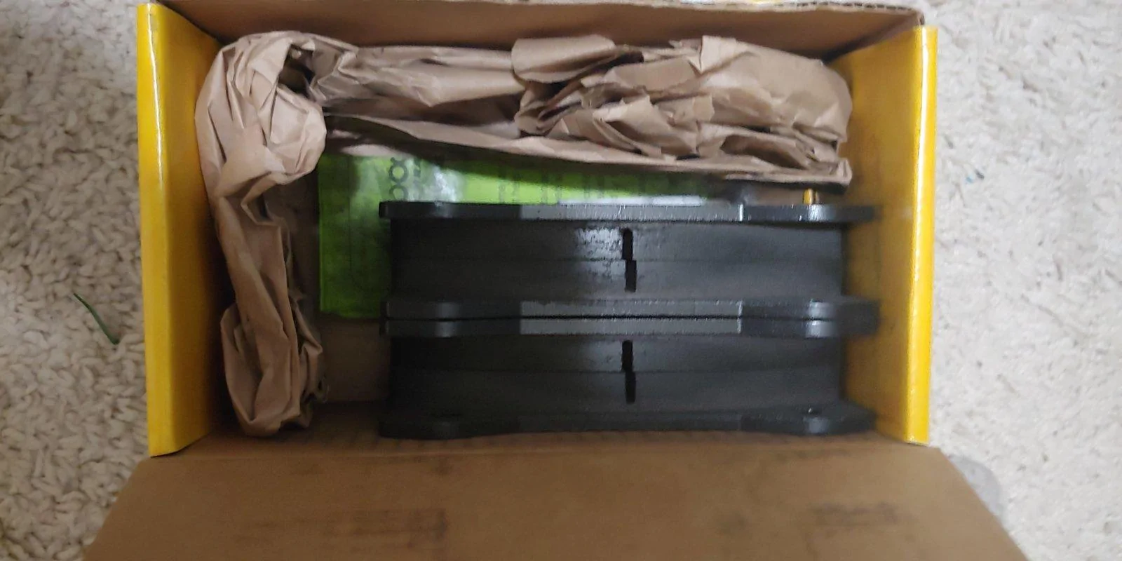

My biggest concern about this kit is brake pad options. Otherwise looks great.
Allentown
Allentown
Sep 17, 2018
46
533
179
Southeast
Allen
2021 401A Security pckg 20x9 Chrome Wheel Upgrade
Educate me. The only thing i know about them right now is the compound.
https://www.wilwood.com/BrakePads/BrakePadsApp?compound=BP-10
  • High performance street / strip, drag race, and track day categories using vented iron rotors.
  • Light to medium braking on dirt tracks including late models, modifieds, sportsman, and street stocks.
  • Disc brake conversions on street rods and muscle cars.
  • Medium friction, smooth engagement, low abrasion on iron rotors.
  • Flat torque curve.
  • Low to medium wear rate, increases as temperature increases.
  • Street Use OK
  • Compatible with all types of steel or iron rotors.
  • High performance street compound with improved friction, longer wear and lower dust levels than standard replacement pads.
  • Beds quickly and provides fast response without high rotor abrasion
It looks like the available brake compounds that will fit that plate size include the following:
BP-40 High-Temperature Racing Pads 4 Pads $208.44 150-12251K
Call (805) 388-1188
Details BP-30 High-Temperature Racing Pads 4 Pads $218.94 150-14779K
Call (805) 388-1188
Details PCM Street Performance / Racing Pads 4 Pads $452.74 150-15193K
Call (805) 388-1188
Details BP-10 Street Performance / Racing Pads 4 Pads $107.82 150-9488K
Call (805) 388-1188
Details BP-20 Street Performance / Racing Pads 4 Pads $151.44 150-9489K
Call (805) 388-1188
Details PolyMatrix A High-Temperature Racing Pads 4 Pads $223.26 15A-9977K
Call (805) 388-1188
Details PolyMatrix B High-Temperature Racing Pads 4 Pads $209.22 15B-9978K
Call (805) 388-1188
Details PolyMatrix E Street Performance / Racing Pads 4 Pads $149.70 15E-12604K
Call (805) 388-1188
Details PolyMatrix H High-Temperature Racing Pads 4 Pads $229.20 15H-9979K
Call (805) 388-1188

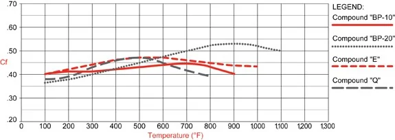

If I am reading it right performance will drop off after 800 degrees and problems set in at 900.
Not sure why are labeled not for street use but assume those are some combination of noisy, short life span and or have to be heated up to work very well.
The slightly more expensive BP20 is good to 1100 before fade and are also street grade...looks like those will be my replacements along with non drilled rotors in the future. The BP10s grab better when cold though.
As an update to above, when i quoted the rings were $279 each, that is the price of the more desirable slotted/non drilled rotors (the drilled ones are actually $329, go figure i guess labor even though it reduces surface area).

For a street pad I'd go with their Polymatrix E over anything else on that chart. Obviously there are options, more than I thought, but you're restricted to their pads. If it accepted the same pads as the Brembo 6 piston it would be awesome.
