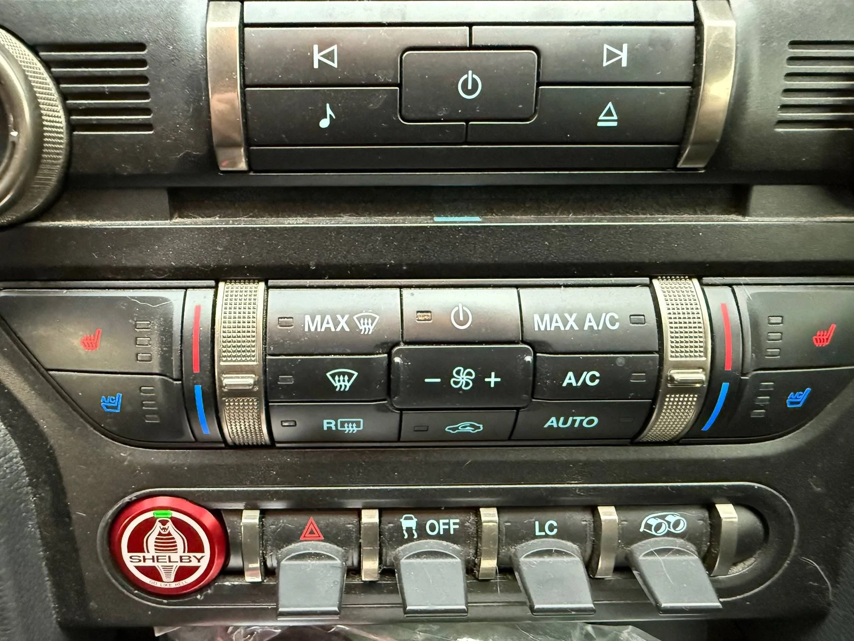

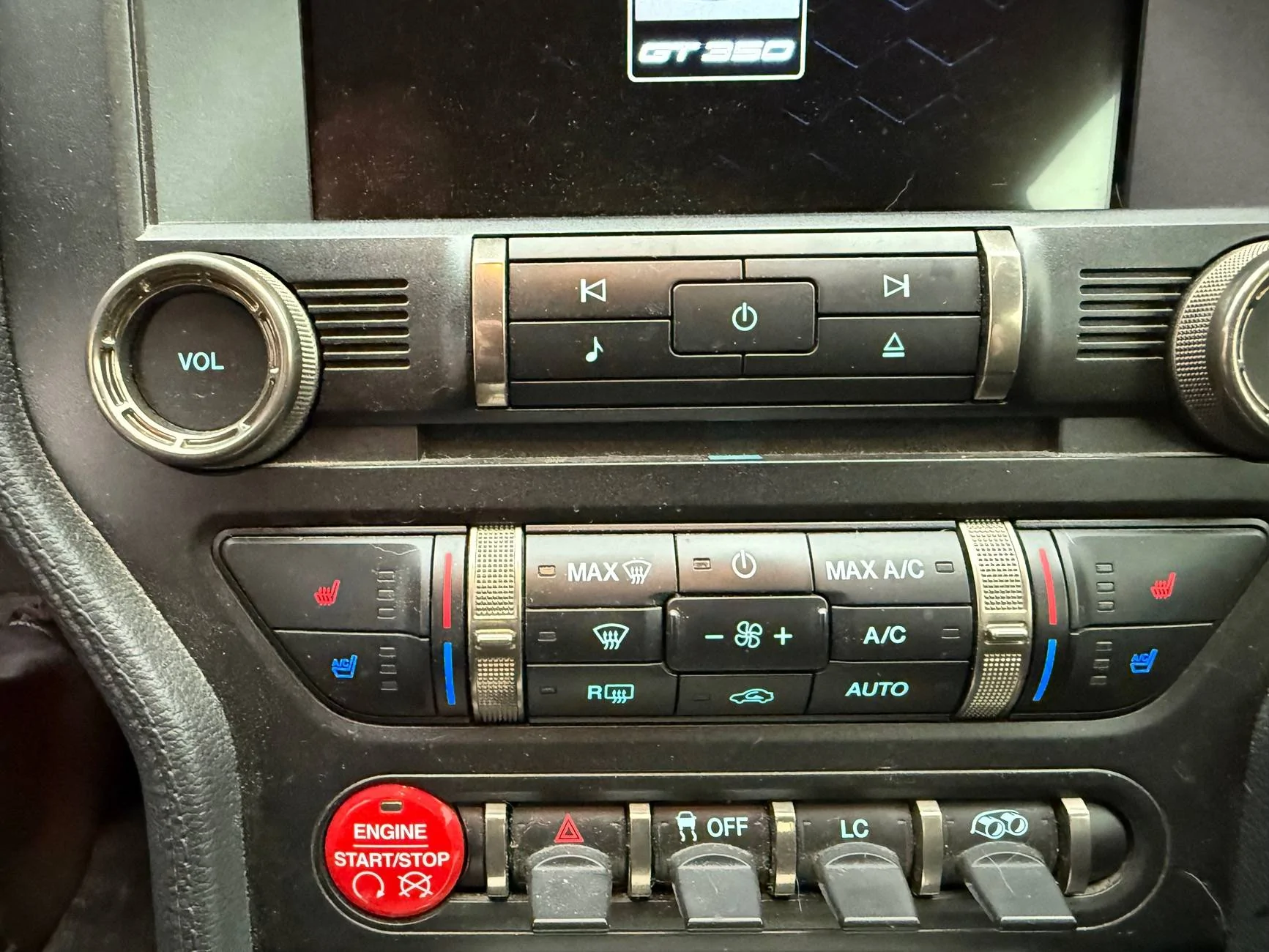

I have an 18 gt350 and my brother got me a cool start button for Christmas.
I installed it in about 5-10 minutes. There are two tabs at five and 11 oclock positions. Need a little pick or something small to get them.
that being said, I have read that there is a 15-17 button and a 18-23 (2 piece) button.
Mine was already a one piece red button, so I don’t know if the 350 switch is different than the rest of the mustang line being that it didn’t get the facelift for 18.
