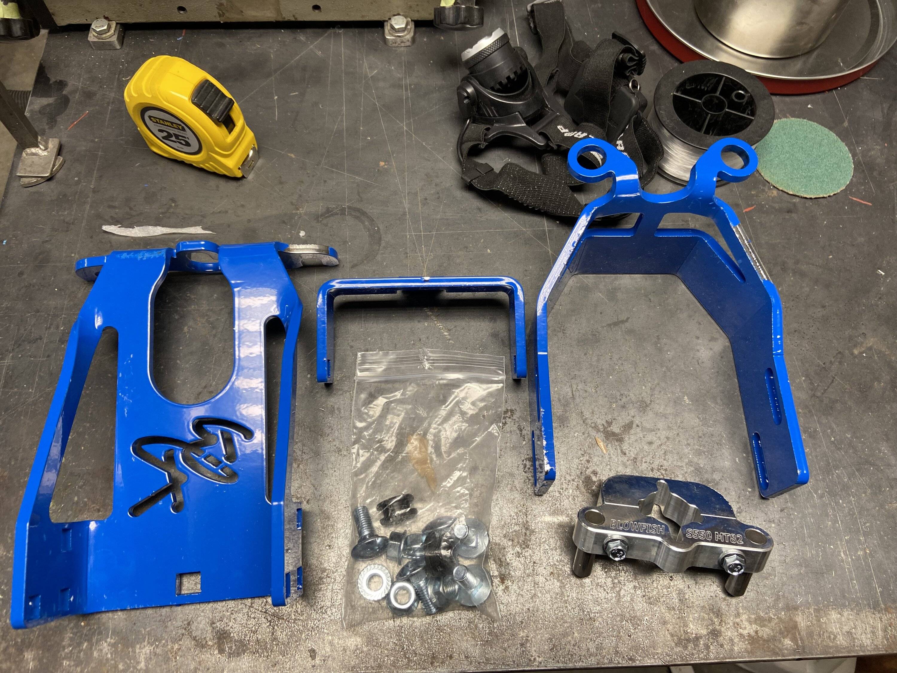

Long story short, someone nearby (within 2 hrs anyway) has a blowfish bracket for a 2015+.
From just looking at the images they look the same, but I can't find anything concrete on it. Some listings online even say 11-22 so that's even more confusing.
Bit of a curve though, I have a 2015 trans in my car with a barton short throw (with upgraded bracket) so that might also complicate things.
From what I can tell, they're basically the same bracket, but correct me if i'm wrong.
Thanks :)

I can help it will fit your car ...
They will work all the way up to the 2020 series, "my car with a barton short throw" think that is a miss, the clamp far right goes on the back of the Ford shifter. Here is a better picture

That's awesome news. I couldn't find anything on it so I appreciate that.
I'm sure others will too
Time to send over that message!

Recheck the answer I add a few things
That's fine, barton short throw is just an adapter plate of sorts for the stock shifter, so it has the stock internals and mounts.
The only thing the barton has is a bracket that you can take off the back.
The barton hybrid is the solid mount.

Oh, I see looked it up, and yes you'll be fine. Shout if you have a question, installing the BF.
cheers
