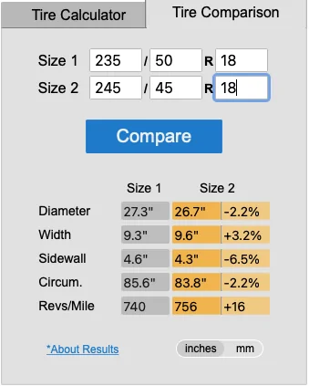

https://www.1010tires.com/Tools/Tire-Size-Calculator
I've used the site above quite a bit. It will not only give you an entire range of tire sizes, but the sweet spot, the diameter/width that would be best for the rim.
In general, you want to keep the overall diameter of the tire to +/-3% of the original. I do understand some deviate from this general rule for specific or unique applications.

Your only real option would be a 245/45/18 but the difference in width is only 3/10th of an inch. Plus the lower profile will give you more fender gap. Just buy good quality high performance tires and you will be good to go.

This is not what you are going to hear, but you need to stick with the 235’s. The wheel is just to narrow for anything wider. Ask me how I know?
Sorry to resurrect an old thread, but can you or someone elaborate? I'm looking to switch from 235/50-18 (stock size) to 245/45-18 so I can run the Conti Extreme Contact Sport 02 (These are not available in 235/50-18). I'm making sure there will not be an issue.

He doesn't like a miniscule sidewall bulge.
245 will be just fine.

255/45 18 is about the widest I'd use. Same diameter as the stock tires.
