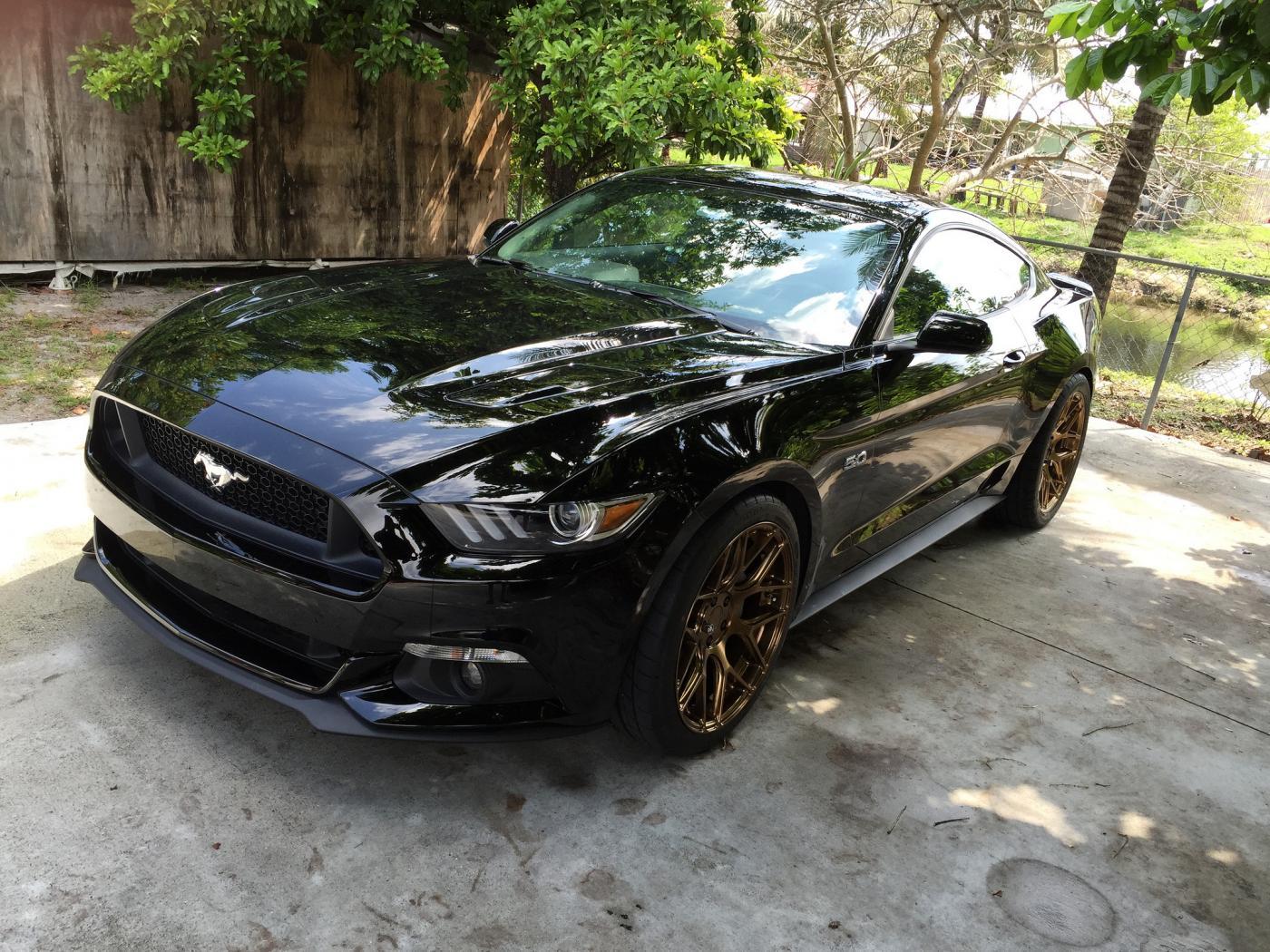

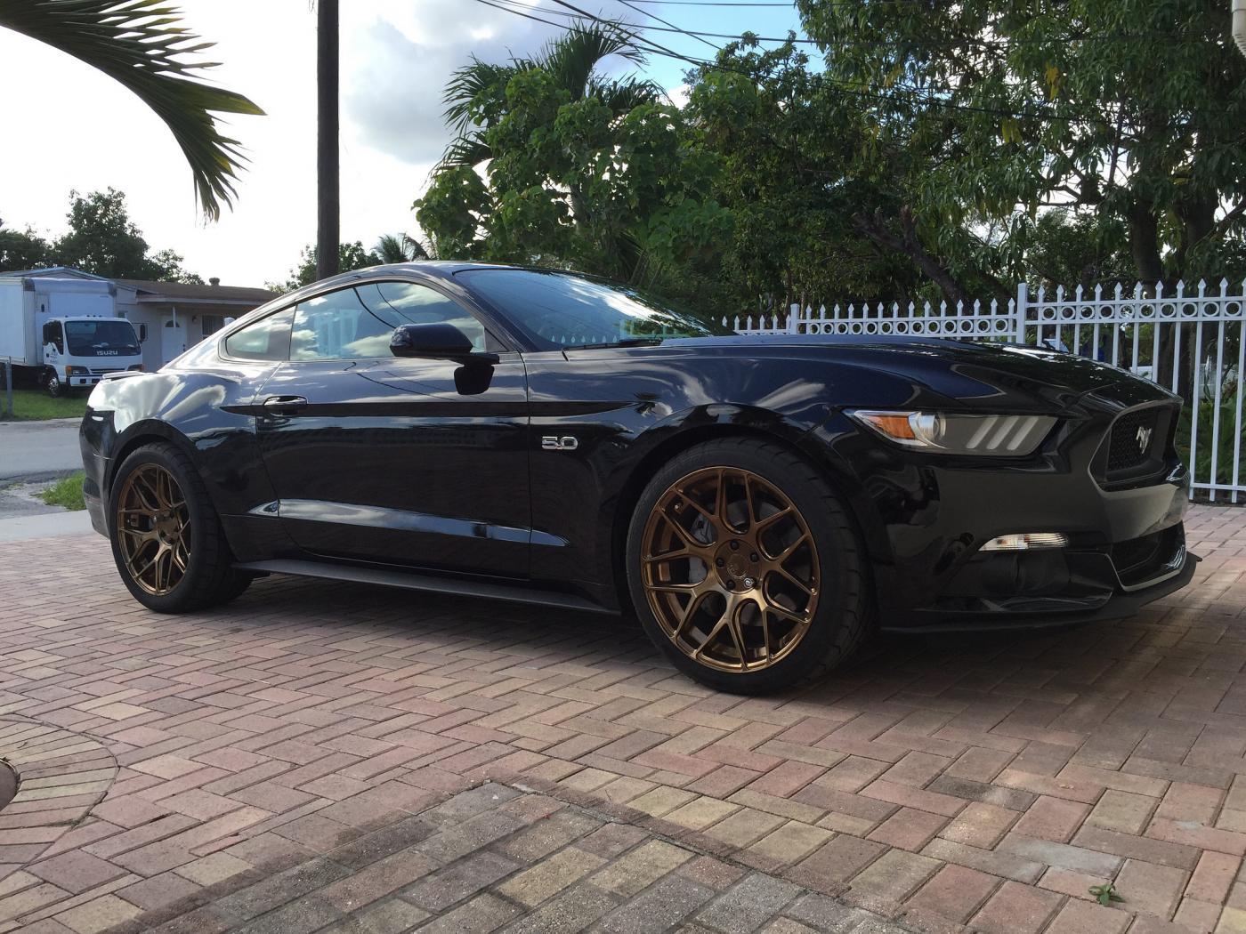

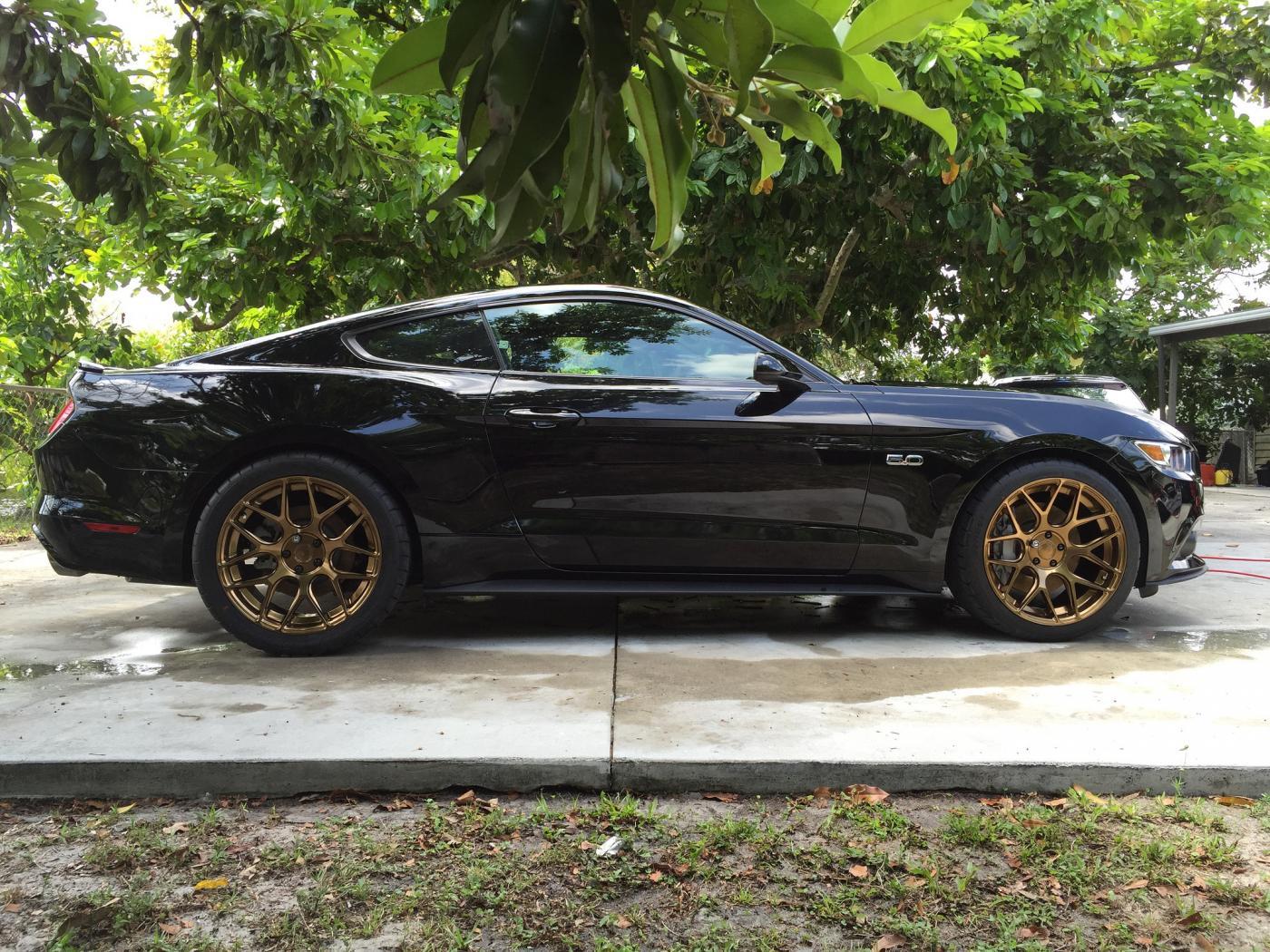

Phuck yeah it does!!
No offense to the many wheel vendors on here, you guys have great stuff and offer amazing support to members. And no offense to the members who buy the particular wheels, but when I see a wheel setup with a bitchin' rear wheel with killer concave-edness and beefy tires then look at the front and it looks like it was just put there so the car can roll, it bugs me a little. The car has 4 wheels/tires and I think they should all look equally aggressive, both for aesthetics and for performance.
Finally someone who understands me. :clap2:

SlipReaper, that looks killer!

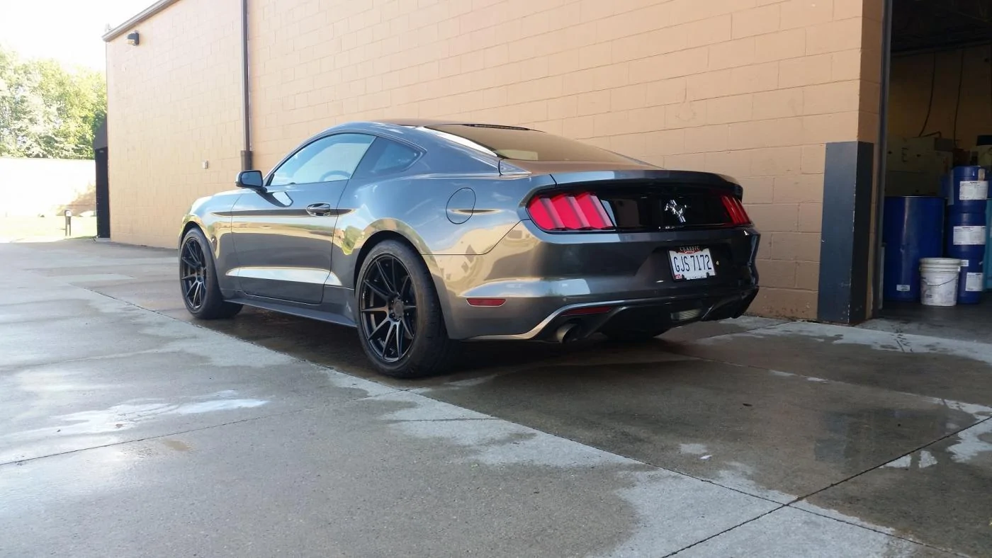

Because Semi-Deep concave on front and back looks nasty :cool:
