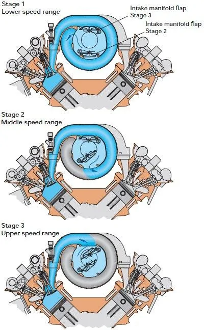

This is an Audi single plenum single throttle body intake manifold used on their old V8s. Was dropped when they introduced VVT cam pulleys. The VVT acheieved wide torque curve without variable intake system.

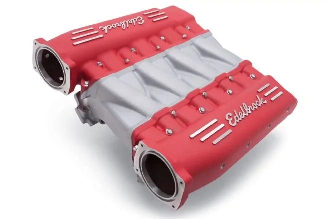

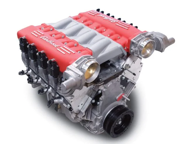

New Edelbrock Cross-Ram Gen IV Intake Makes Your Engine Look Like a Ferrari
Dual Throttle Body Intake Gives Exotic Look to Gen-IV LS
chuckty101
Sep 8, 2015
269
68
Ontario
2016 Shelby GT350 Shadow Black
The dual throttle-body design is engineered to accept two 90-millimeter throttle bodies and is ideally suited for twin-turbo race setups.
