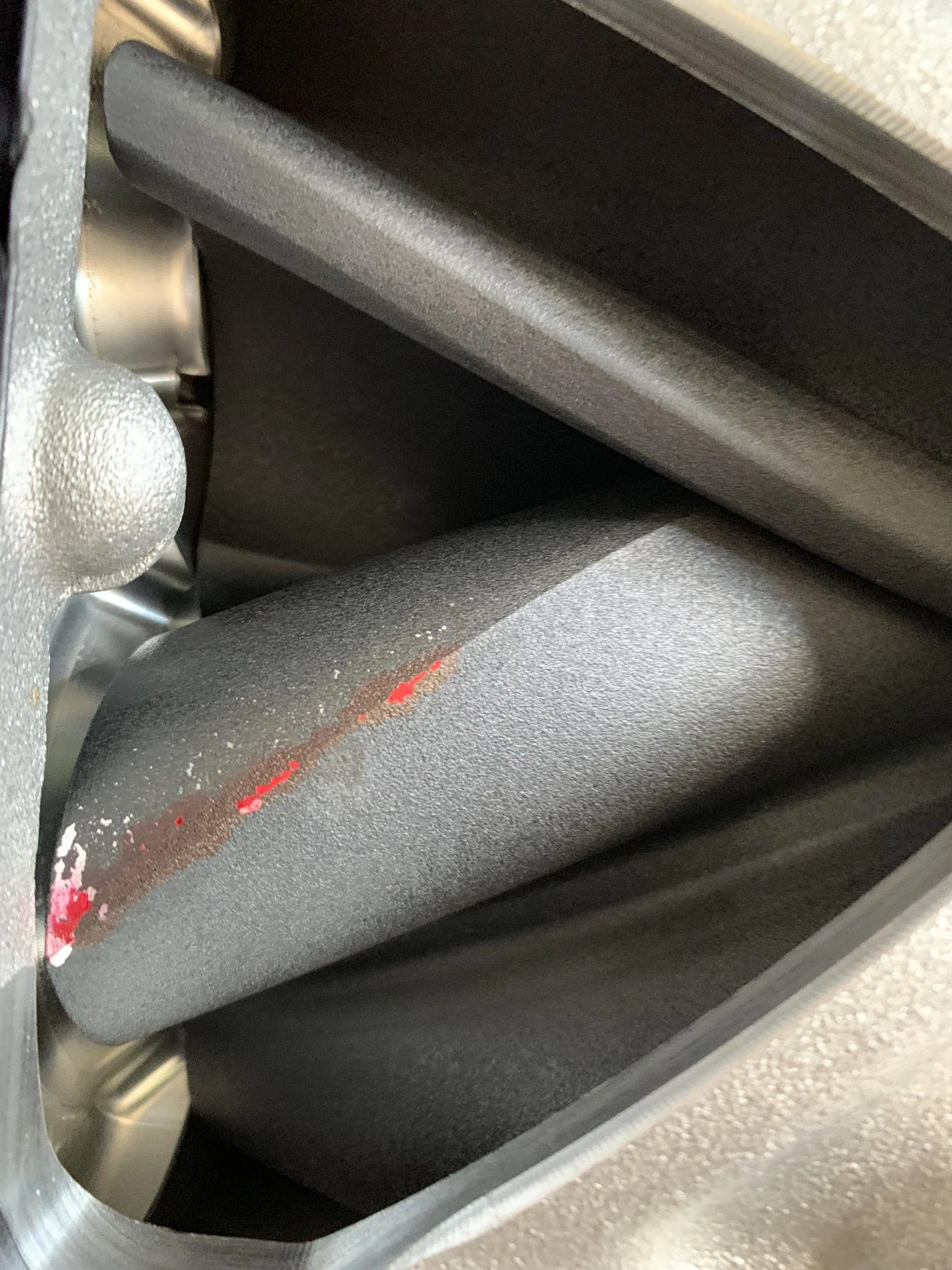

Wanted to post an update. I sent my gen 3 back to whipple they rebuilt it and replaced the rotors noise is still there but not as loud. We took the belt off the car and the noise went away. At this point I think it’s a Gen3 thing.

I did have some flaking on the rotors so they changed those too. So hopefully it’s not the rotors rubbing or anything.
The black coating is wha they call a conformal coating which is made to wear in to the slight tolerance in the rotor pack. It's common for that to wear and show some light color of the rotor beneath that surface.
