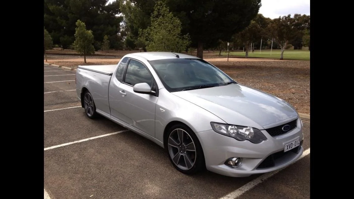

Also I've included a pic of my current ride for those who're interested in what goes on here in Australia... It's a 4.0, 6 cylinder turbo before you ask... And yes, it goes VERY nicely thank you!
Mustang arrives in a few months
