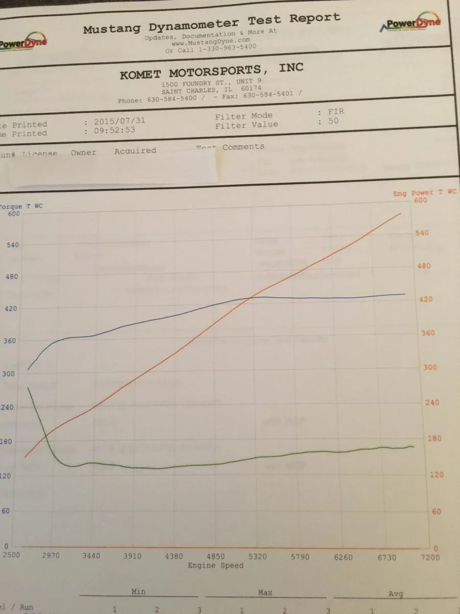

I have an automatic and have the Whipple installed with the larger TB. Everything else including the exhaust is completely stock.
The latest tune and larger TB provided much better numbers. Before the larger TB installlation and latest tune my numbers were 505 HP. After the install of the larger TB and latest tune I went to 583 HP. I am attaching the dyno run for your review.
