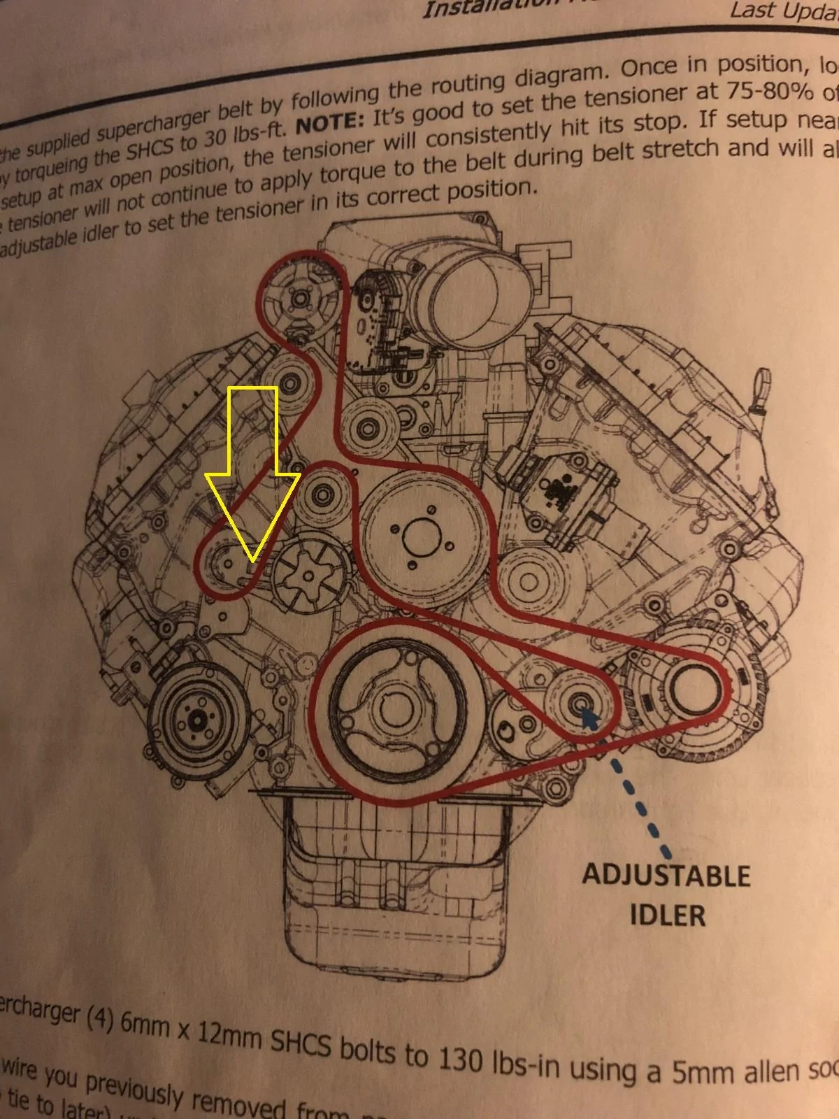

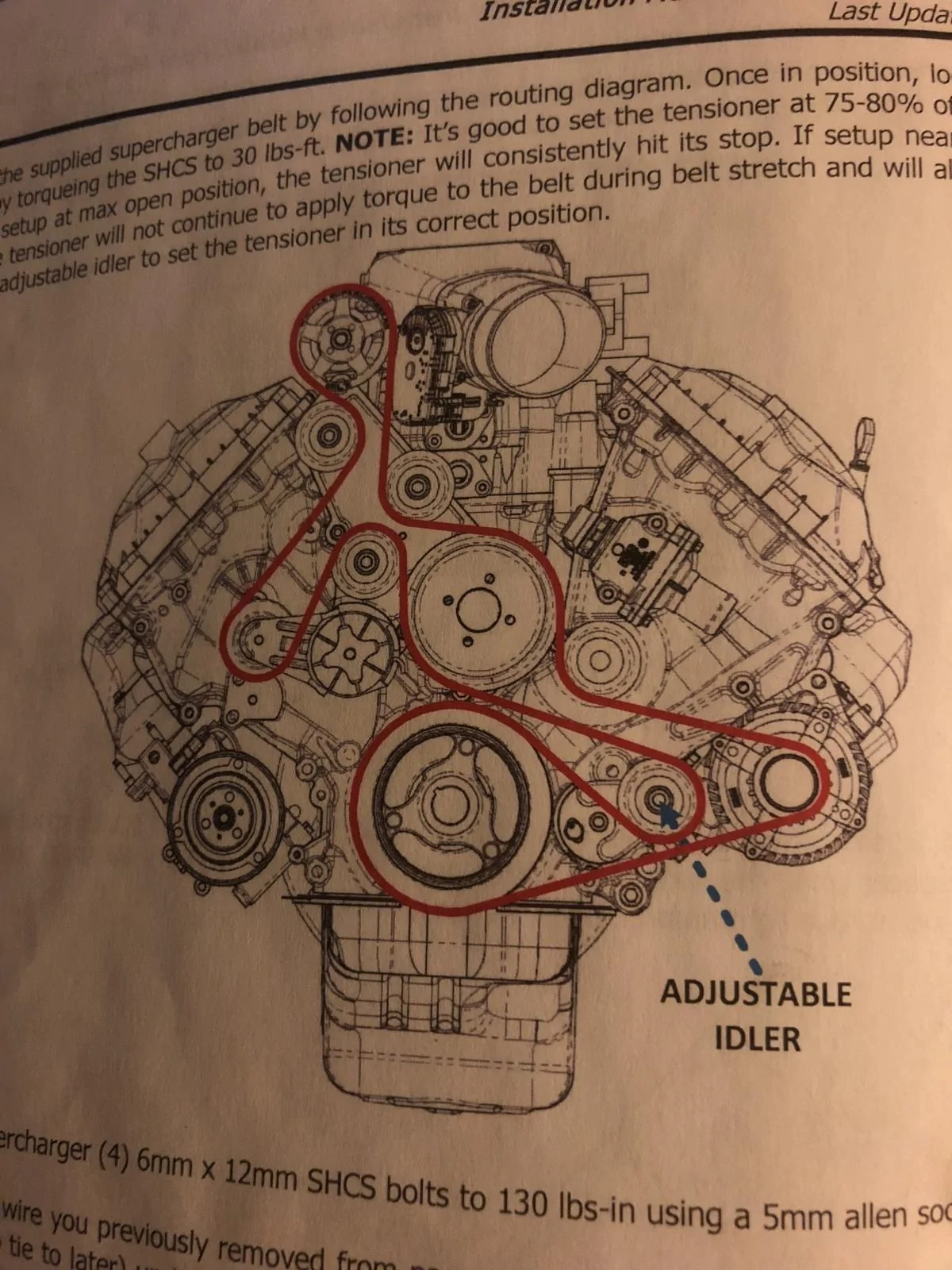

Thanks man. Which one of these is these would loosen the belt for me to remove the pulley?
Adjuster idler?

stick the half inch ratchet into the square in the picture where the arrow is pointing. lever it and when the belt comes loose pull it off the upper pulley.
Make sure you crack the bolts loose before removing the belt. When you remove the belt the spring loaded adjuster moves quite far, you may even have to let the ratchet sit up against the fender well.
After putting the belt back on, double check that its still on all the other pulleys.

Awesome! Thank you good sir
