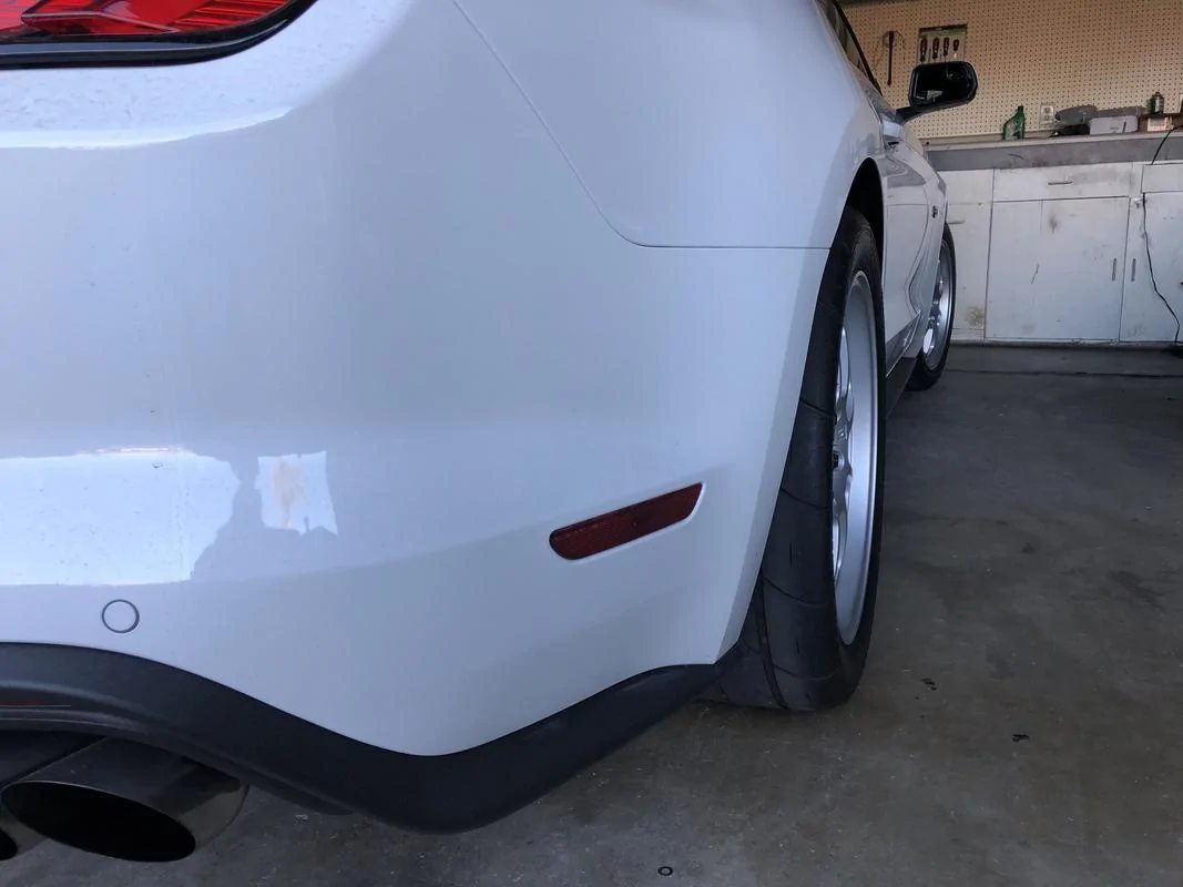

I’ve also ran/run a 305 street SS on a 9.5 wheel.
I know the GT500 has stronger shafts than the GT's, but good info.
Have any pictures of what the 305 S/S looks like on a 9.5" wheel?

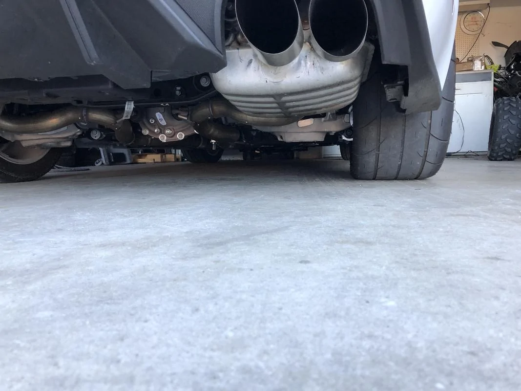

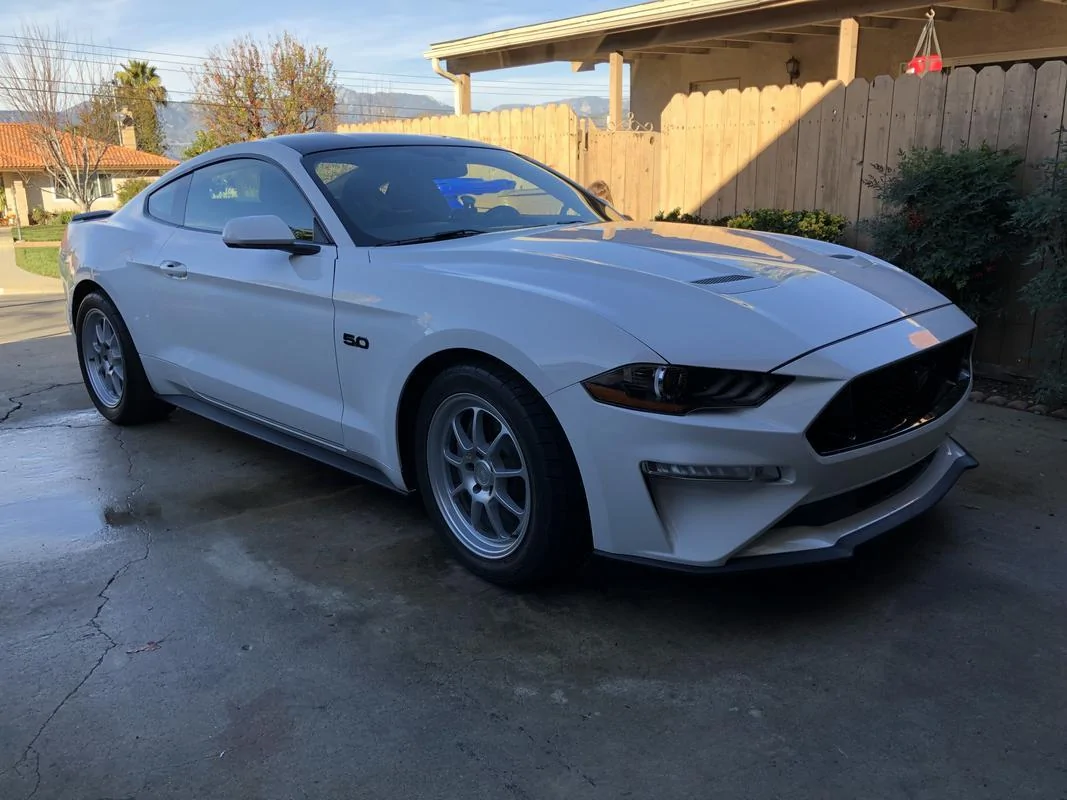

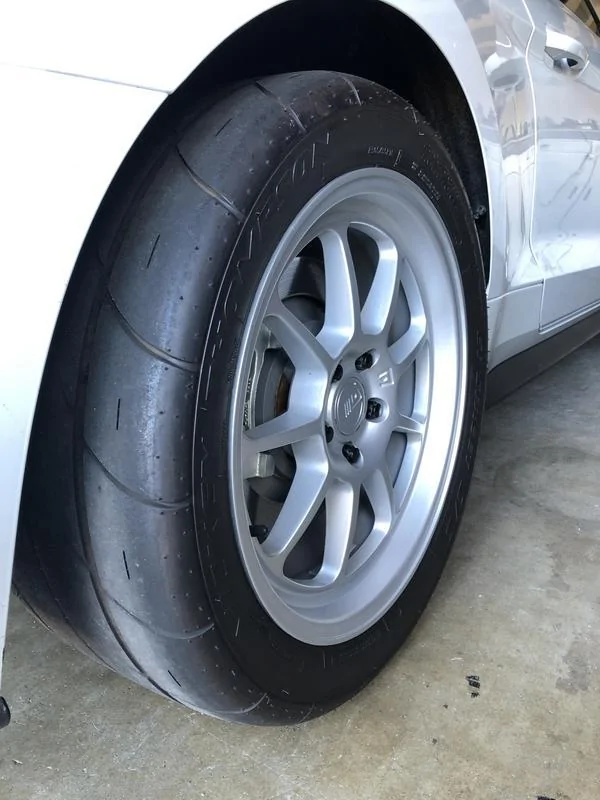

Yep... they’re on my twin turbo s550 actually.
Wheels are 18x9.5.
Tire is a Mickey Thompson ET Street SS in 305.
Doesn't look too bad at all. Which tire are you running on the front?
