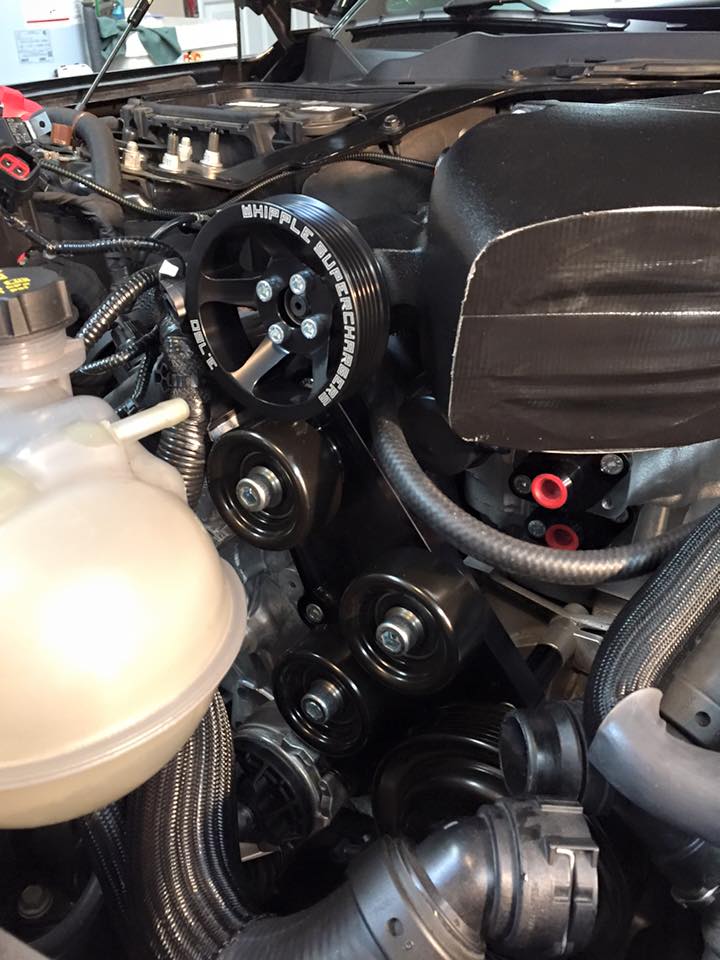

Got a good deal on a 10 rib 20% OD Whipple setup, but not going to be ready to run big boost just yet, so I want to run the equivalent rpm as a standard damper and 3.75" which works out to a 4.5" upper pulley. Will that sucker fit or will I be hitting the hood?

Looks like largest whipple makes is a 4.0" but I have a guy that makes them custom, as well. But would a 4" even fit? That's the same as a 3.375" on a stock damper.

I'd imagine the 4" would clear fine. The pulley is a bit lower than the top of the SC. I could measure to see how much room is above the pulley.
