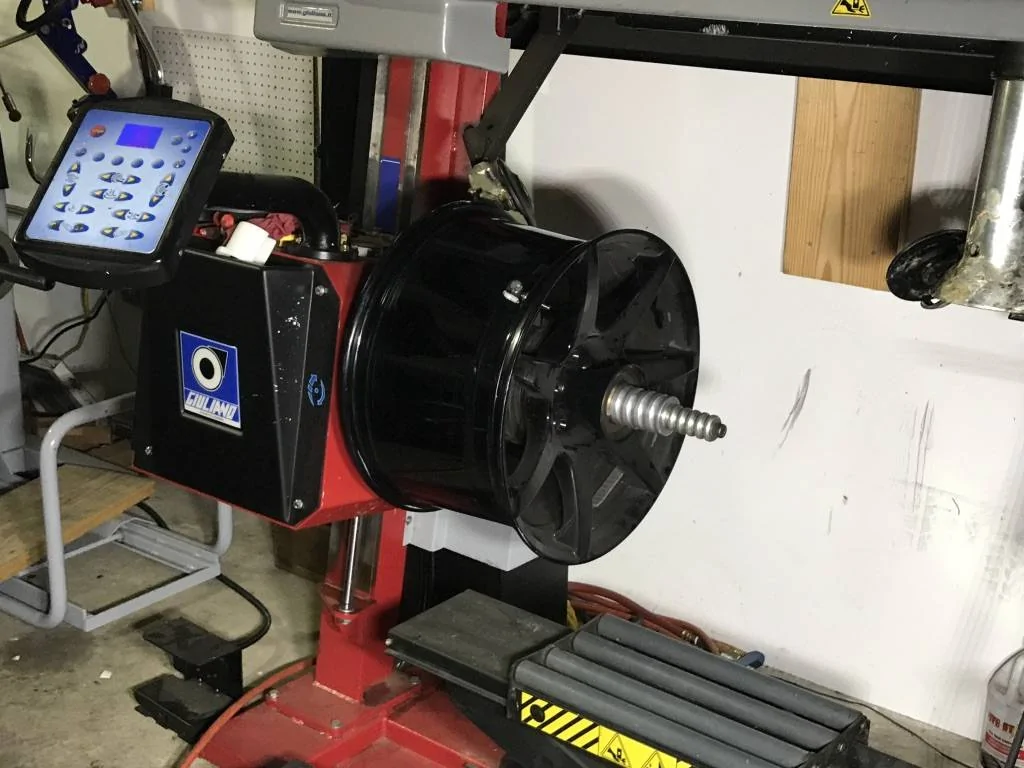

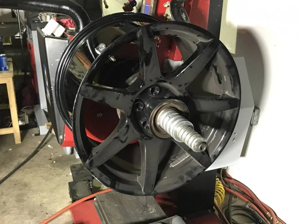

I have the vertical style machine at my shop which is necessary for the centerlocks on my GT cars - different manufacturers have different setups with the vertical style. What to look for is in the pics below with a wheel from my GT350R.
Regardless of how good the machine is, it is ultimately dependent on how good the operator is. One can still damage a wheel if they don't know what they are doing, even though you can change a tire without touching the wheel with a machine such as this. Most balancers I see typically use a cone style locking mechanism, but not so much for the tire changing machine.

I would imagine most of them have this type of machine. Part of the reason why i purchased this machine is that the Ferrari and Porsche dealers in Europe use this particular one.
I do not know. That said, I have never seen a Ford dealer with one. I change the 19.5" tires on my F450 with this machine because the dealers will not touch it.

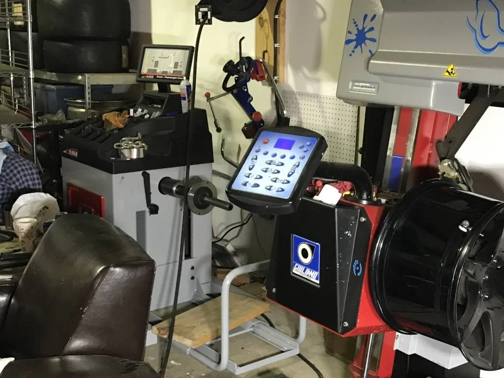

That machine mounts and balances the tire?
What is the cost of that machine?
Just changes tires. My balancer is to the left of the tire changer in the third pic. $25K
Yeah that’s what I thought and have too get a balance machine.
