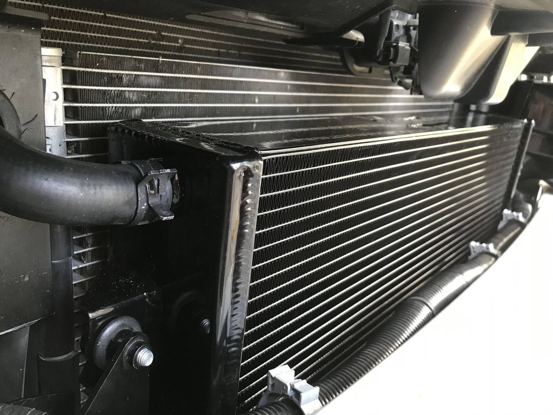

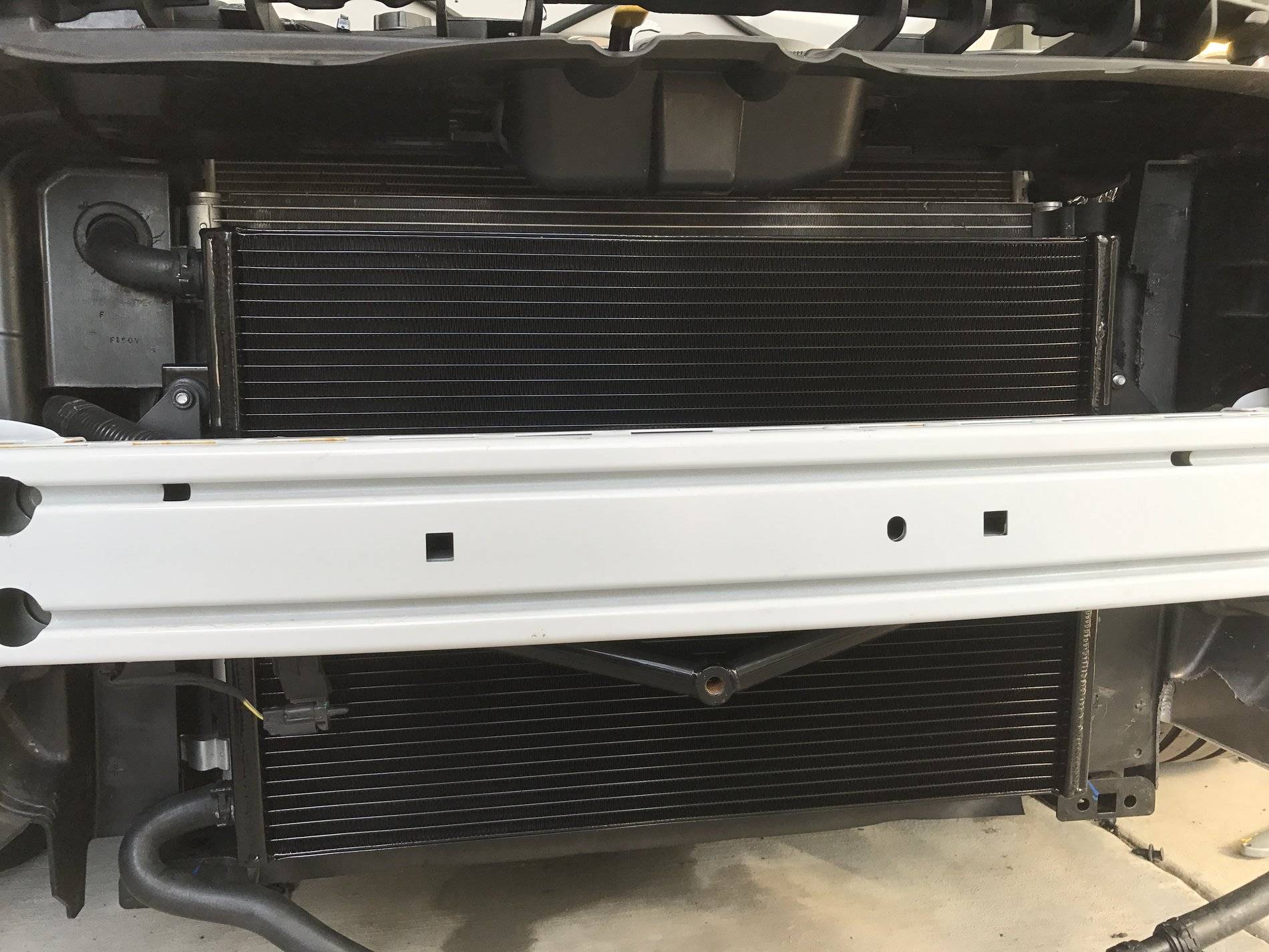

I have the oversized HE. All the above comments are correct.
