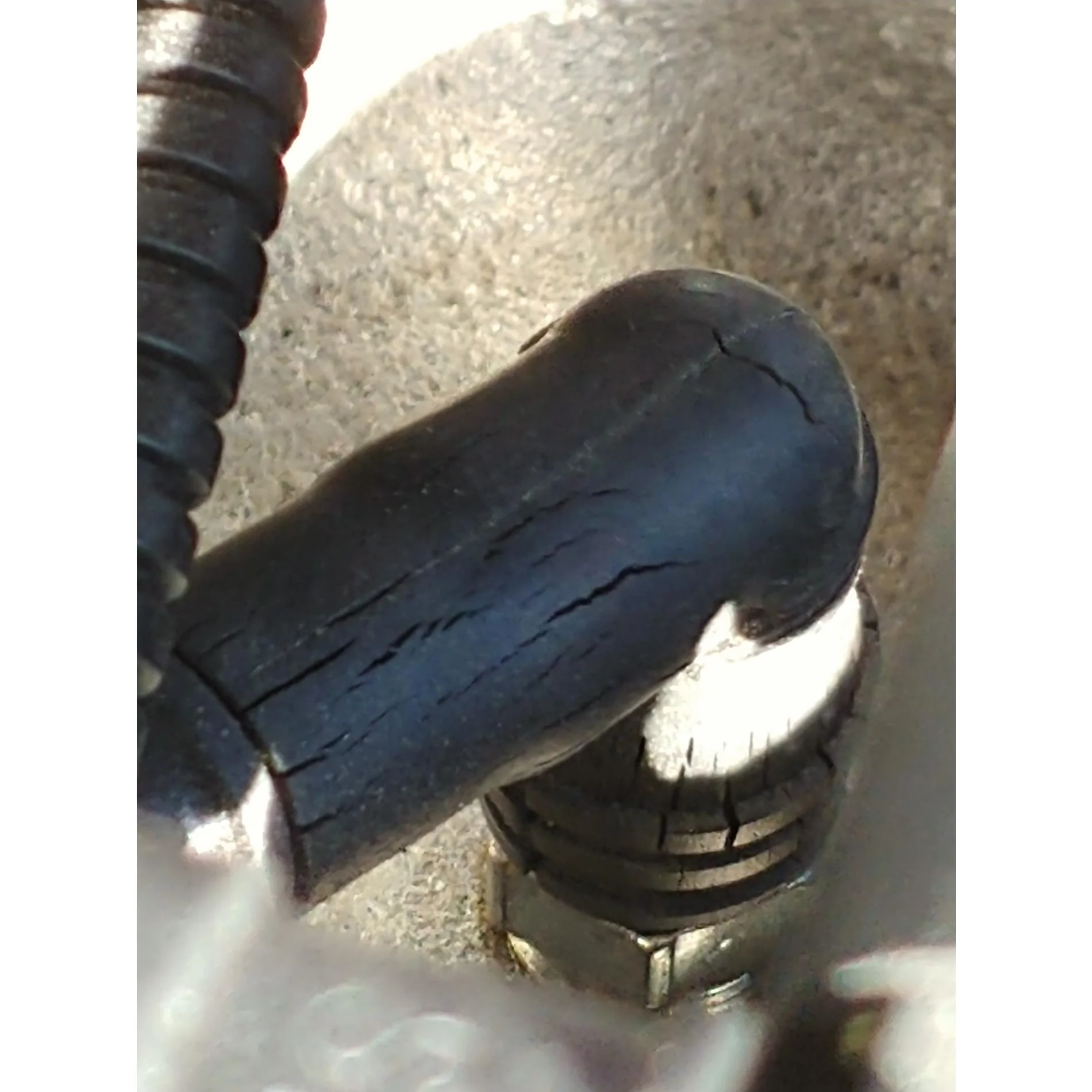

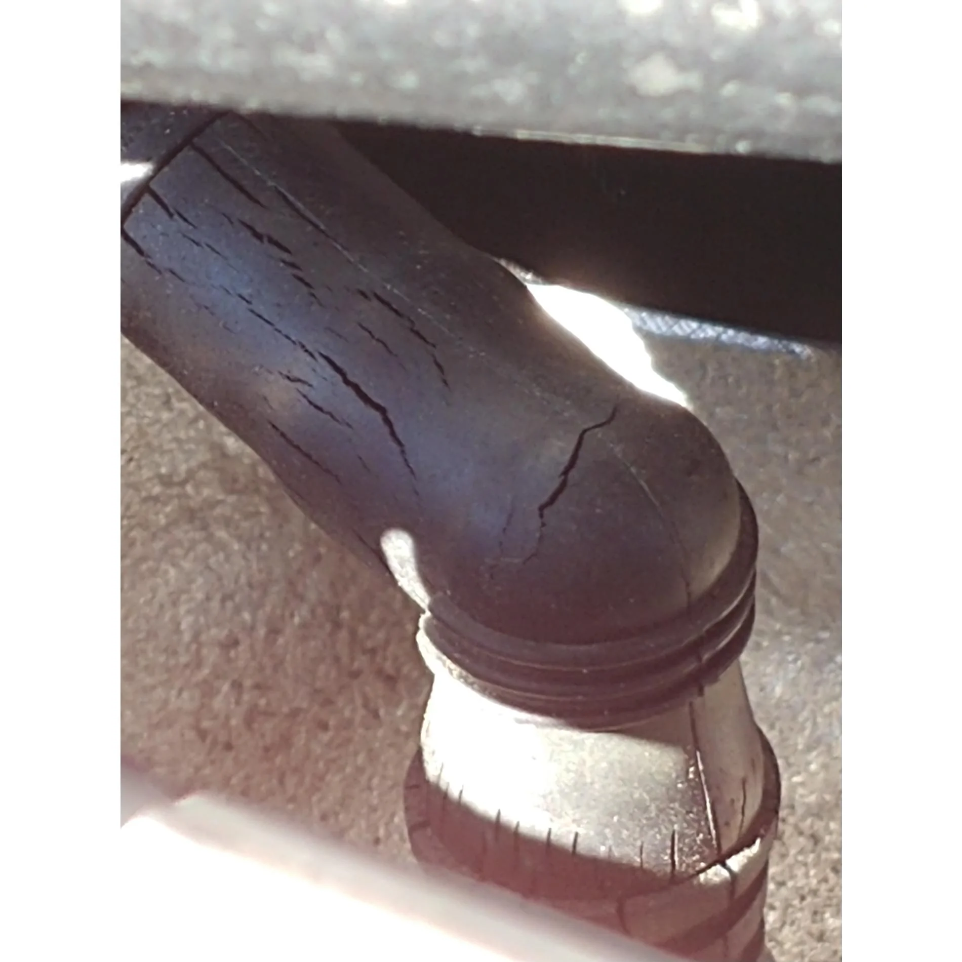

So I came across a questionable fitting on the manifold near the throttle body.
Anyone of you guys have issues with the fittings deteriorating like this?
