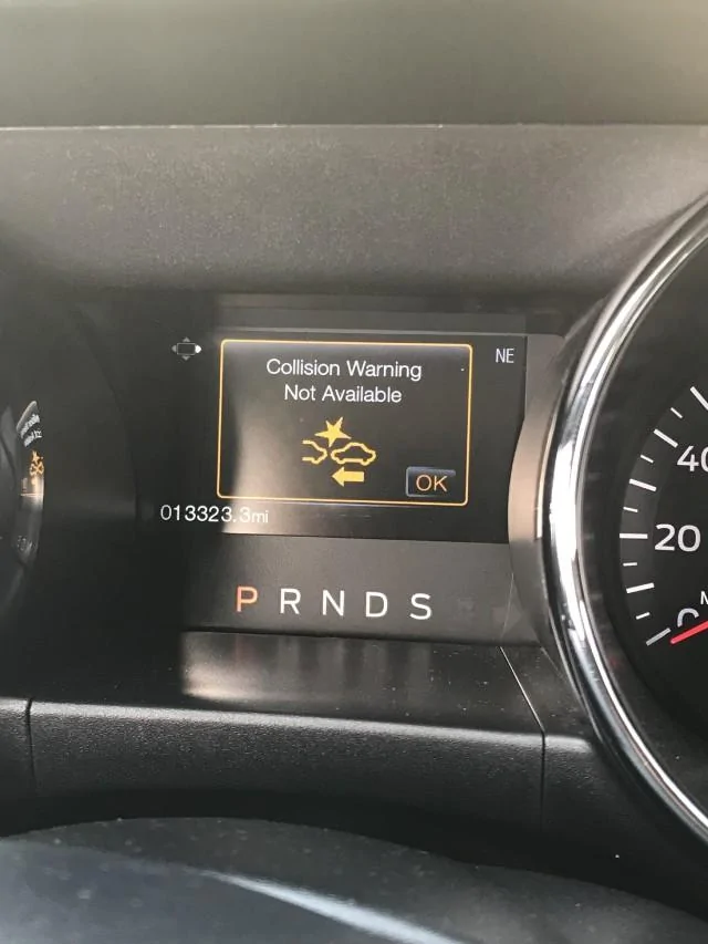

They just didn’t listen and did what they wanted and now the ACC doesn’t work at all and I’m hoping I got lucky with no internal engine damage. It runs hard like before but for some reason when I turn the key off or after the fuel system primes it goes from about 52 psi and rapdily drops to zero over a few (like 3-5) seconds. I’m wondering if an injector might have been damaged trying to run over its duty cycle or something?

Can you post installed pictures of this to benefit the community here who have been unable to do so? Maybe that would clear it all up. My journey with it has been a rough one and every day I’m reminded every time I hit the key that it doesn’t work. And I haven’t had cruise control since I installed my kit. And then the dealer fiasco when I’ve tried to get them to align it after the fact. I just want it to work but I’ve not seen anyone with a large heat exchanger post of theirs working yet which seems unusual.
Just to clarify, you just don't have adaptive cruise now? on my 2016, there is a setting to select adaptive or "regular" cruise. I wouldn't expect regular cruise to be affected by a problem with the sensor but maybe I'm wrong.
Not trying to minimize the loss of adaptive cruise which is a big deal.

It’s grayed out in the options menu but I don’t know if that’s because of what the dealership did. I never tried before that idea was posted but I don’t think it works. No way to confirm but I like the idea - I’ll take any advice I can get.

Regular cruise control is disabled if the adaptive cruise control module is unplugged or otherwise not functional. I would also like pics of the module fitting without removing the bracket; the only way I could see it fitting is if the HE was about 3/4 of an inch further back (towards the engine). The HE doesn't move that way, though; it pivots forward and backward, but it cannot be moved forward or backward. Because of this, it doesn't fit. Not even close.
