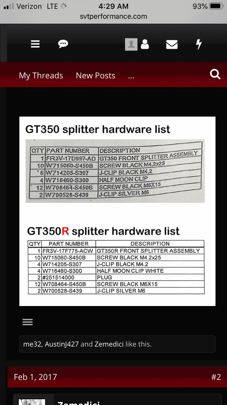

Here’s everything you need...Tob from SVT gathered this info . Take it to your dealer .
