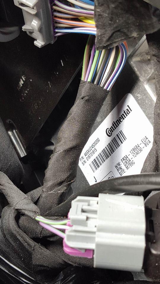

This is strange. But my white sticker under the fusebox only says "J".
RHD Australian delivered GT.
Checked with a friend with the same car. Also. RHD delivered GT and his has 4 characters.
Can I get the PCM code any other way?

If you look on beefcakes site he has a picture of the 2015 pcm code. Even though the Lund directions and lethal told me it was a 4 digit code, I sent in the 3 digit one anyway and got my tune with no issues. They should probably clarify things a bit

According to Lund Racing's image, your code is BVA! Not J!

I just hopped on here looking for the correct answer to this question as well. I just picked up a set of catless SP headers from Beefcake (Thanks for the fast delivery by the way!!) and submitted that my computer code was "CAN1" for my revision to BAMA. As Beefcake clarified above, it's supposed to be the last 3 letters of the P/N.. If you look at american muscle and Bama's sites, they show that it would be the CAN1 code..even JLT states it should be the 3 letters followed by the number - https://www.jlttruecoldair.com/ZenCart/instructions/Computer Code 2015 Mustang.pdf
Not quite sure why there's different answers on this question?
