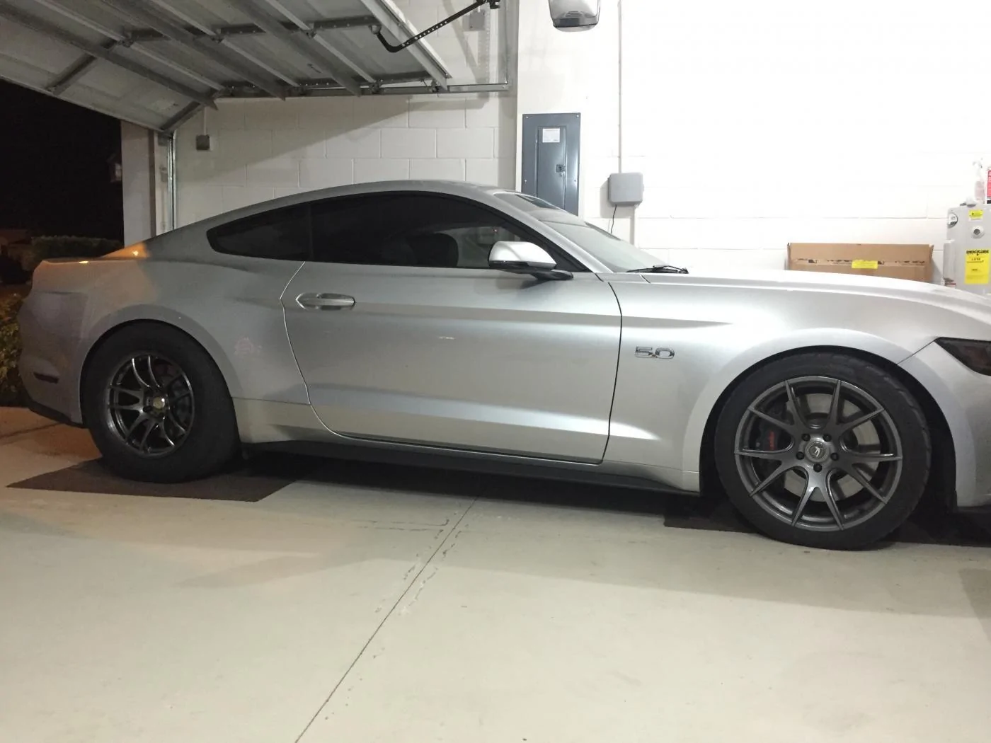

17x10x28 Hoosiers
wanted a wheel similar to my Forgestar cf5v's
