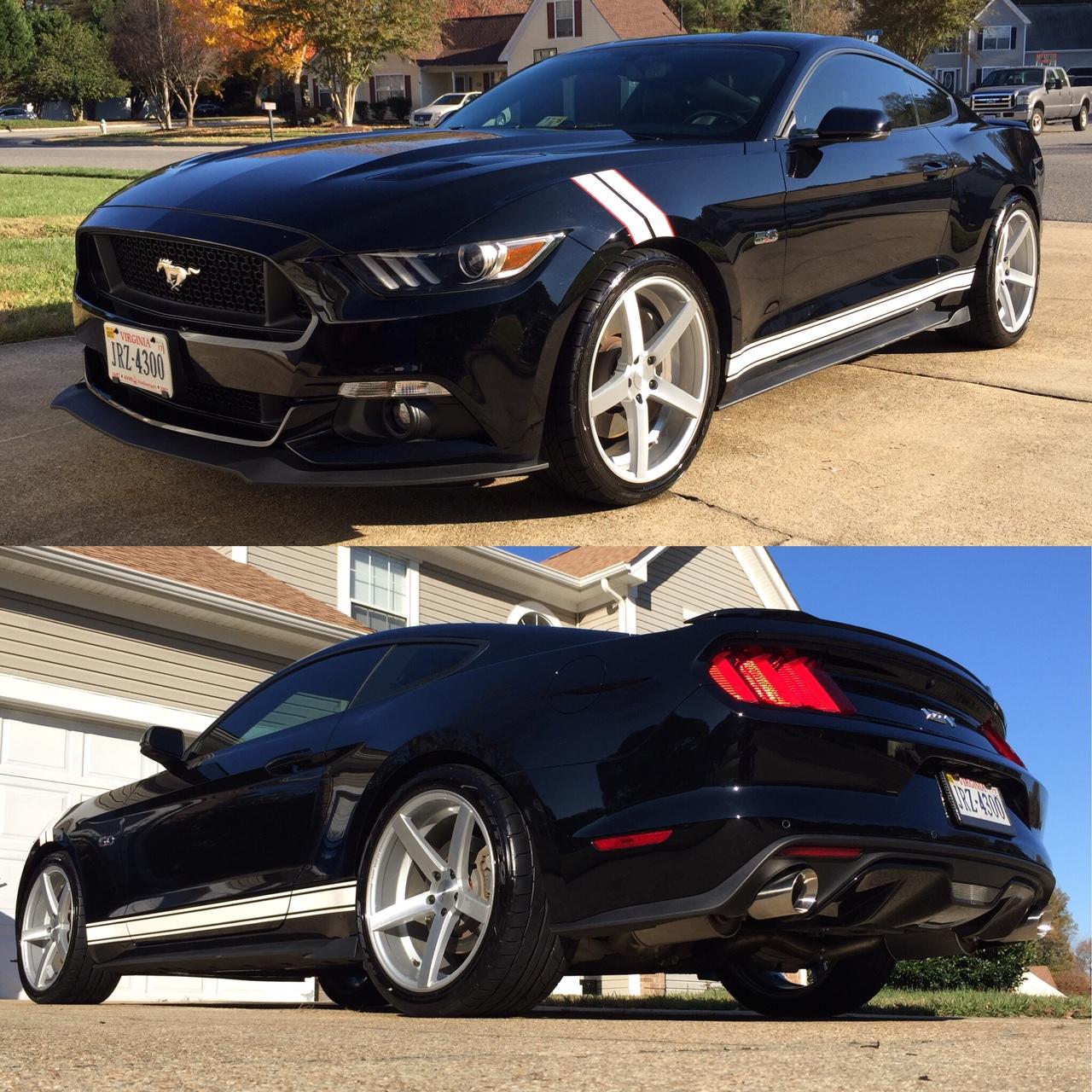

Just as an FYI...
I run a 265/35 on a 8.5" rim up front and a 295/35 on a 10" rim on the back. Running the G2's as well.
