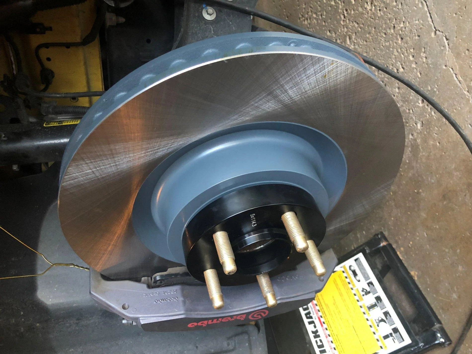

^^^^ This
This is the exact set up I'm going for.
What brand or where did you get them? I'm assuming you went with the ARP 3" studs as well?

Square 19x11 50 mm offset SVE SP2 Replicas.
I went with the long studs and spacers.
ARP 100-7733 1" longer than OE
CJ 1" spacers
Tires 305/30/19 RE71
Installed studs into stock hub with Lang 754R - 14mm x 1.50 Threaded Wheel Stud Installer tool

This is great info, thank you!!!
