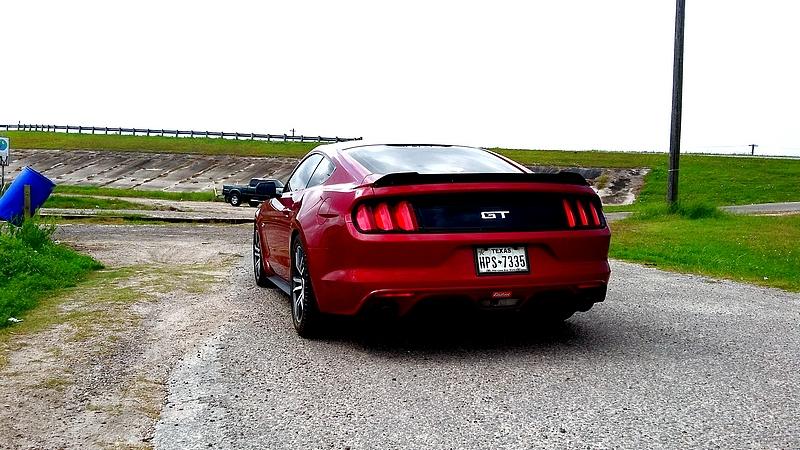

Alan
2016 5.0 Coyote Red
Spacers
The spec to use safely is 6 mm but I have 8mm or 5/16" on my Coyote Red. 28,000 miles.
