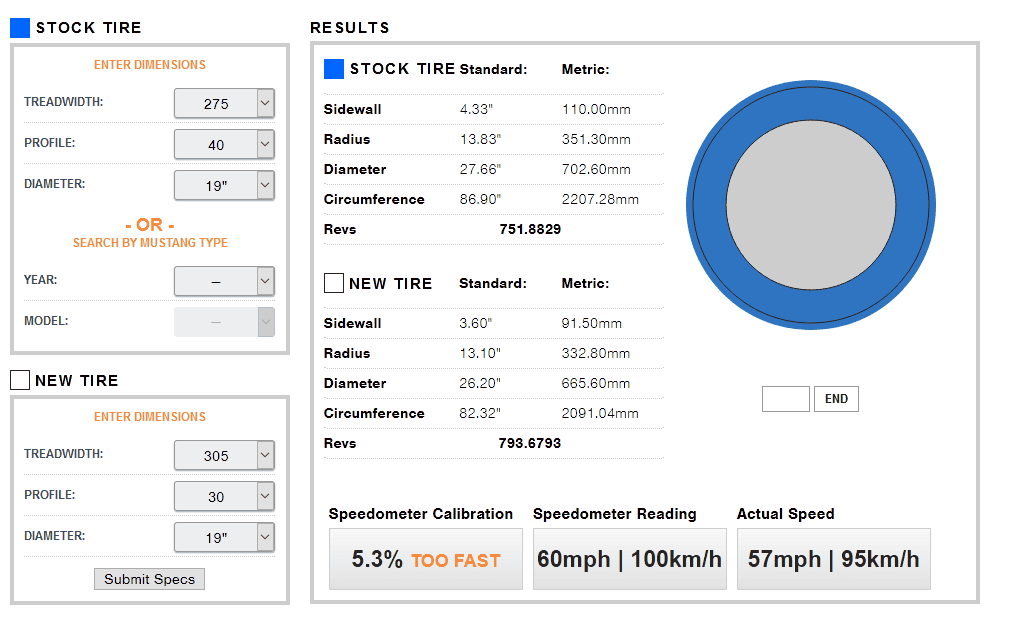

Also, is this going to be an issue running 305/30 on the rear?
AlbertD
Jun 18, 2016
74
627
368
Tucson, AZ
2016 GT/PP
I would recommend 285/35 and 305/35 for that wheel setup... keeps the diameters closer to stock. 275/40 front and 305/30 rear is going to noticeably look off.
The speedo calibration being off isn't too big a deal, doesn't affect anything mechanically.
