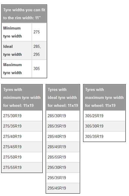

I've called around and all the tire shops in the areas are saying go 275/35 front and 285/35 for the rear.
When you say tiny, are you saying perspective, or just in comparison to the fenders and a 305.

They're misinformed. 285/35R19 on an 11" fits, but is more stretched than you need, possibly want. 295 or 305.
285/30R19 is a very small diameter tire compared to what you have. That's what I meant by tiny.
