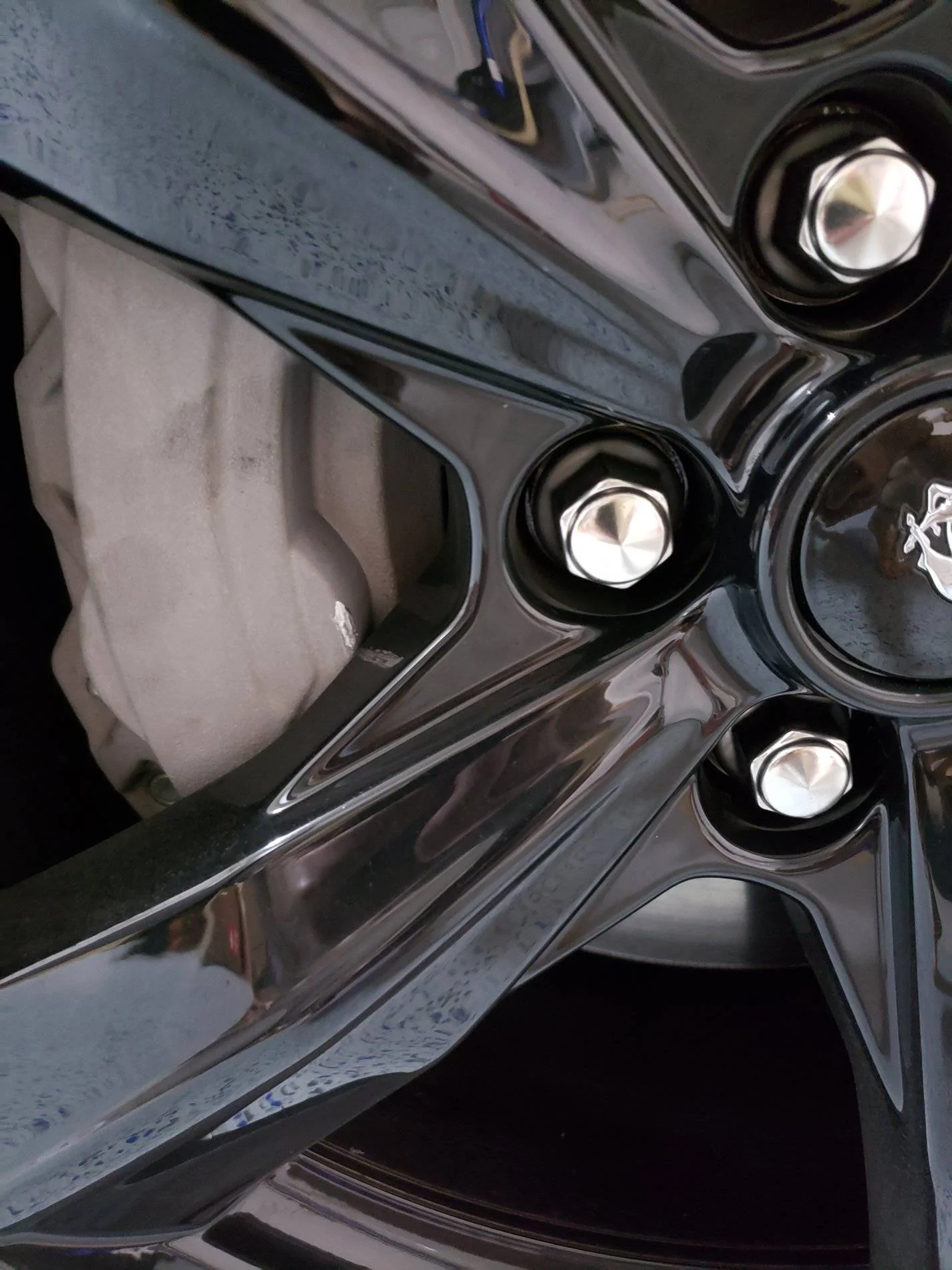

I have a 2020 GT no options, base GT wheels. I bought some steeda rotors, g-loc pads for the track, and Bullitt wheels. Original GT calipers reused.
Test driving after the install, and I have some rubbing of the wheel, worse on the right, rubbing on the caliper enough to take off paint and some material. It's worse when I corner hard. Wheels are properly torqued.
I don't understand why. Do the Bullitt wheels require a spacer? Any other ideas?

It just occurred to me that Bullitt cars are PP1 which have different calipers...
I guess that's the issue. Dang. Spacers?
